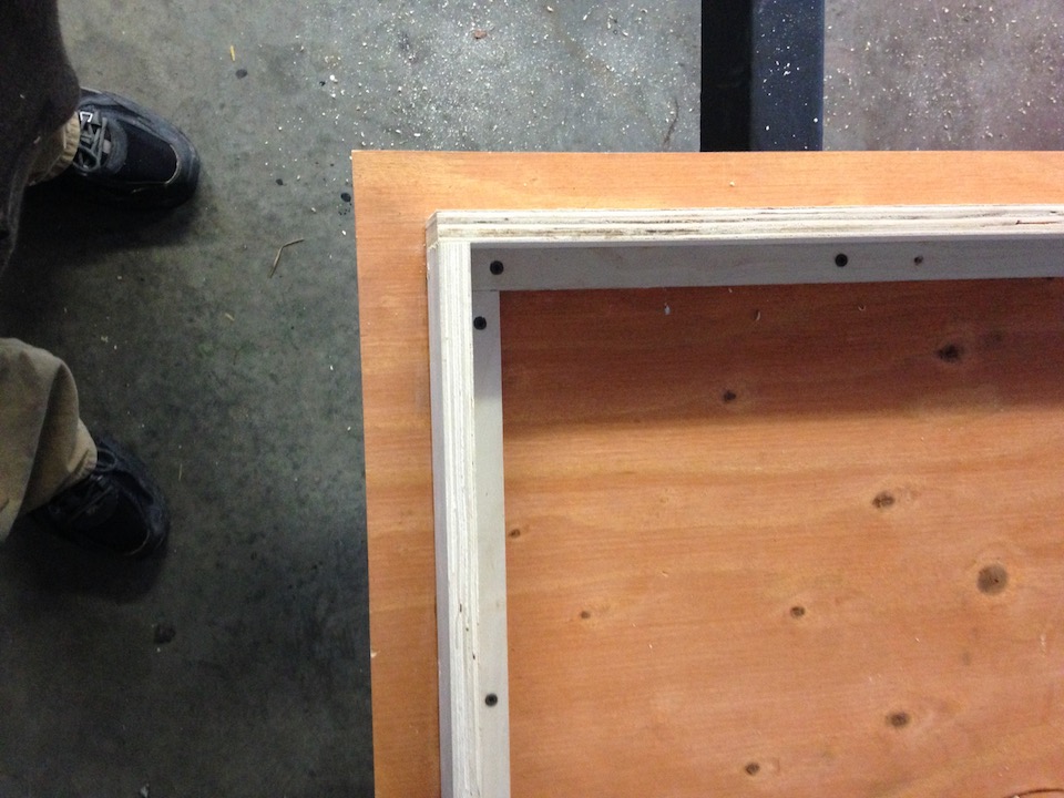

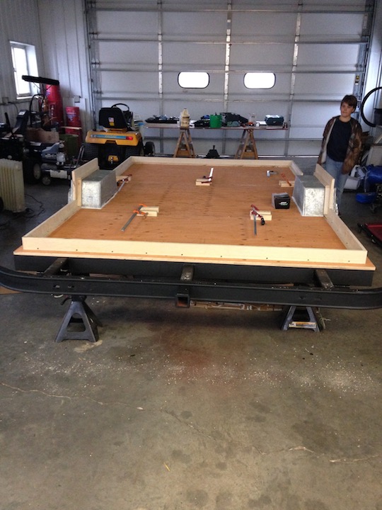

My son and I got a lot done on the camper today. The floor is glued together, we installed the wheel wells and we have the beginnings of the internal (face) frame for the walls. Things are really getting fun now.
I am using 1.5 inch pink foam and 1/4" plywood for my walls. I will build a big face frame and then attach these structural panels to it. I used the wall materials to set the depth on a slide square. I used the slide square and a framing square to draw lines on my camper floor. I used the lines as guides when screwing the plywood strips to the camper floor. Everything came out very straight and square, the exterior walls when attached will sit flush with the edge of the camper floor.
If I am building a cabinet or piece of furniture I draw up everything and pre cut all of my materials at the same time. When building something like this I prefer to cut each piece as I go. I just hold the piece up to the project. Mark the piece. Cut the piece. Pre drill the piece. Glue and screw the piece on. This way everything is sure to come out flush and tight. This way you can make changes as you go too, if you feel inclined. Like when I am setting heights for the bunks I'll be able to play with them a bit before I am locked in.

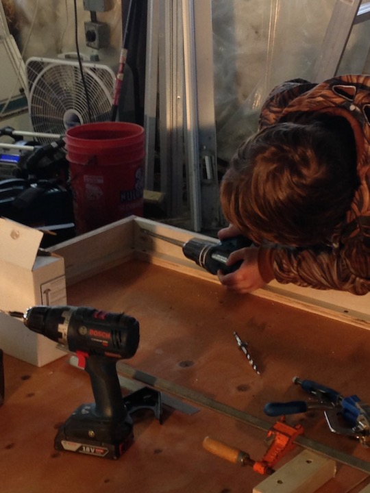

My boy was working with me today, we had a lot of fun. You can see him putting a pocket screw in a pocket hole in one pic. For a 9 year old he works very hard. He did the screwing and I did the cutting and we split the drilling.

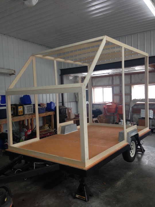

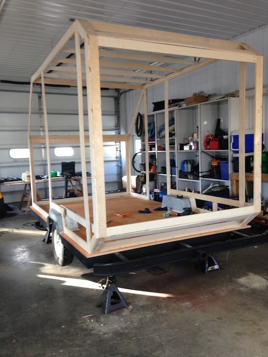

So I got the camper box frame built today.

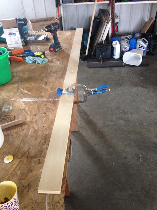

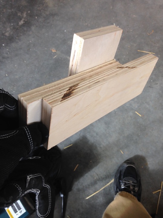

I included a pic of my little kreg jig and face clamp. In case anyone is wondering about how easy it is to make pocket holes. I think my little set up on a is faster and more versatile than the "master jig" kreg sells for much more money. Just my opinion after using my little one for years. By the way I've had the same jig for years, I use it all the time, it still works great. I had to replace the drill bit once.

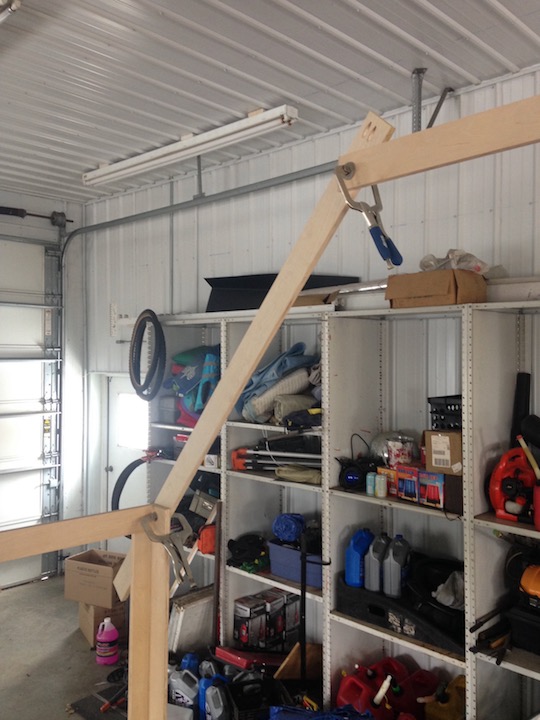

I included a pic of clamping my angle board up. Instead of using trigonometry I used two clamps and a pencil. My angles were great. Mark, then cut to fit.
Looks like tomorrow I'll begin laminating my foam structural panels for the walls. I want to get those up and the ceiling on. I have decided to wrap it in glue and canvas after all. Stick with the tried and true. Any thoughts on how to blend the canvas seams on the exterior walls? Did I read right? Are you guys spackling the foam to fill gaps? Like plaster of paris? or joint compound? What are you using? Thanks for any help.

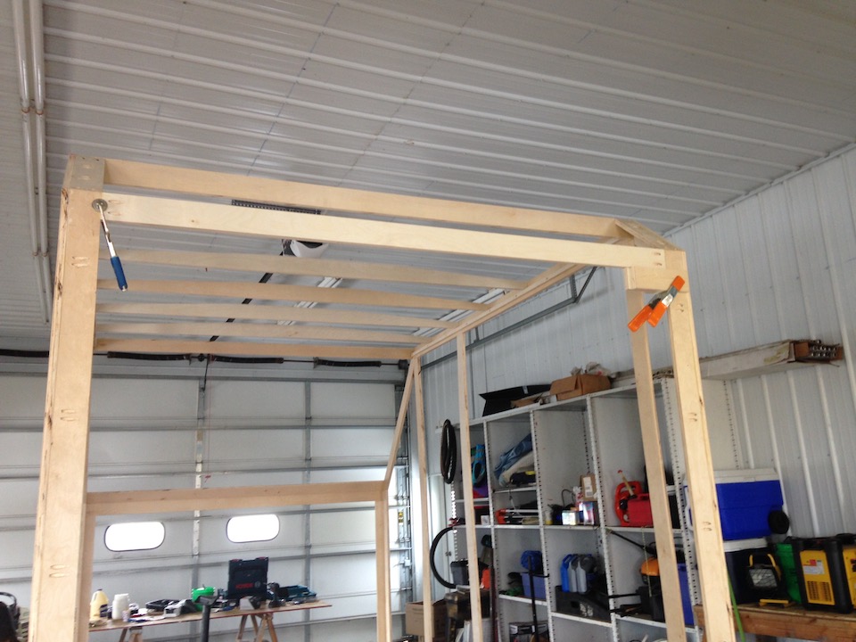

Postby Bruue1 » Wed Mar 21, 2018 6:31 pm

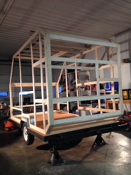

I needed more interior room to get adequate length on the side bunks. So I changed the back end adding something I'm calling a tubby boat tail. It got me nine more inches of interior space. That will make the side bunks full length and make the kitchen nine inches longer.
I'm hanging a lot of high face framed boards on my own on the top of a ladder. I made a little jig to hold the other end of the boards. You can call it a third man or a deam man or whatever you want. I posted a close up pick of it and a pic of it in use. Just in case there is someone who hasn't seen this trick before. Its beginning framing stuff but if someone hasn't seen one the pictures will be useful when you are trying to hang the high boards.
The other pic is end of day today with the new extended rear end. I'm glad I took the time to redo it. Now the camper is more functional and I like the shape of it better. Who knows maybe the rear will shed air a little better too.
