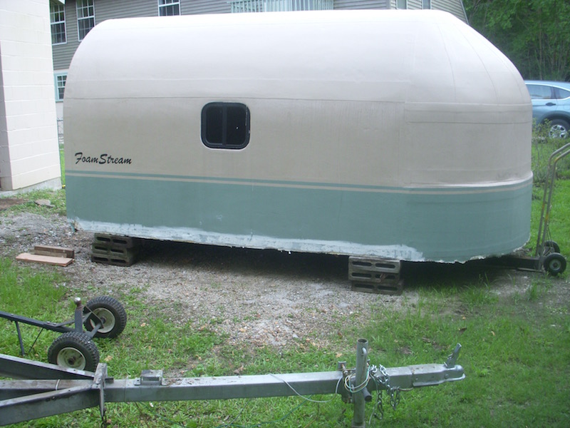

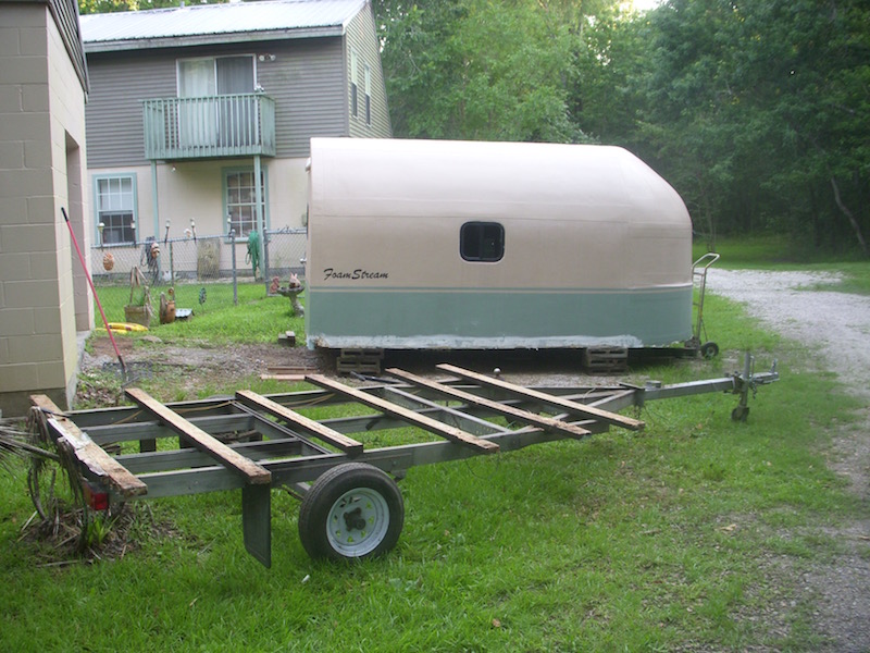

Well we did manage to get a little bit done yesterday … Cabin carefully cut away from the floor … Floor removed and sent off to Burn . Today . we’re off to the lumberyard to get a new floor … Coming along … :thumbsup:

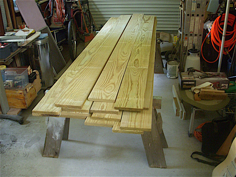

Instead of replacing the floor with OSB ( what we had before) , or worse, plywood .   We found some very nice “Clear and dry” pressure treated boards … No knots , premium wood and NOT that nasty wet green wood they call pressure treated… We used it recently for a little trim work on the house …   And to protect the cabin inhabitants from the PT , we’re going to isolate the inside cabin from the floor with a nice continuous layer of old school linoleum ( like Grandma's house ) and NOT the Vinyl Flooring they sell at the big box stores , that has a Paper backing which wicks water like a sponge … just an awful product for a camper trailer …" tried it, hated it “ Must be why they use it in “designed to fail” RV construction these days ... :thumbdown:

PM , I had a plan and stuck to it , the camper came off with little resistance … tha sawzall just cut through foam and Rot like butter … :thumbsup: Surprisingly everything on the whole trailer/camper was fine except for the rotted Floor …. and the ant tunneling … grrr !!!
But I went across to the Eastern half of the United States today ( back East) and got all the boards , outdoor screws and some more caulk … Ready to start primering the boards … we should (hopefully) be back in business by next week barring any rain … ( this IS the rainy time of year ) Keep those fingers crossed … “I asked my friend about the fiberglass sheet strip for drip edges , and he told me the company was reluctant to even sell him such a small order, so that’s out … Have to find something else … :thinking: I was thinking this would be perfect because we could screw it into the edge of the board floor and then cover over it with the canvas … nice and neat … any water from above would never come near the floor … Or that’s the idea anyway !!!

Today we bring the boards inside on saw horses and start applying "The Gripper"… Help isolating the PT from us ...

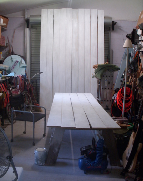

Postby GPW » Sat Jun 09, 2018 9:18 am
Tac, that looks like that will do it , just has to go beneath the floor line just a little .. and we can stick the outer canvas to it :thumbsup:
Got the boards inside … Pretty wood !!! Ants probably won’t like it … :NC

Postby GPW » Sat Jun 09, 2018 11:49 am
Half primed … Time for a break … and Lunch … :phew:
