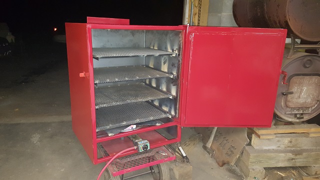

I built this oven for my BBQ business. It is just big enough to fit the pieces for all of my bends. :thinking: :thinking:

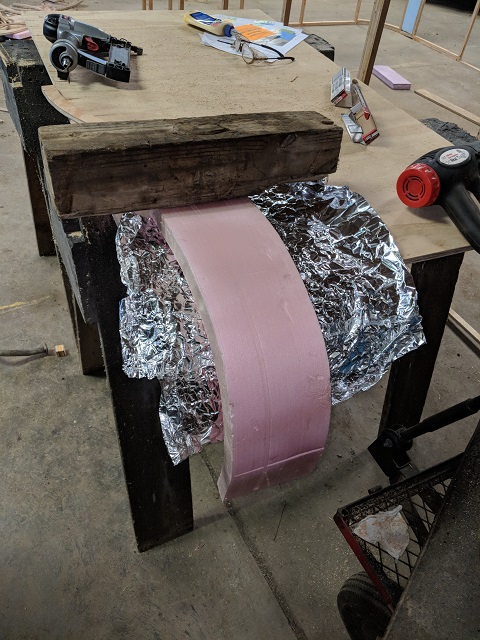

Ok.... I tried again with a little more patience and a new idea. :? Much better results this time. :thumbsup: With a form to bend over I think the results will be even better. It was a little tough getting a nice uniform curve to match the radius I needed.
I found that a foil backer helped distribute heat around the back.

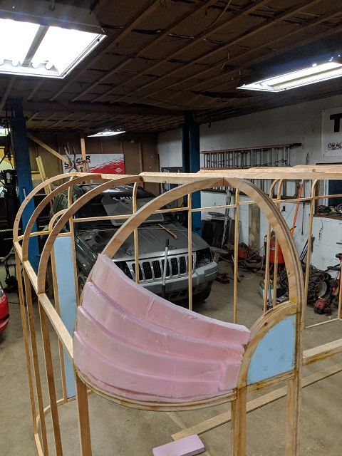

I used up the rest of my scraps starting to visualize my compound radius.

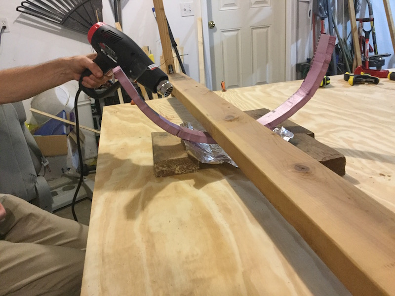

I bought a heat gun and have experimented with bending foam. One thing that I noticed was I don't have enough hands to bend foam and hold heat guns. :NC

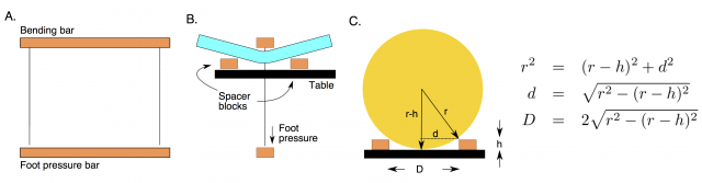

Here is an idea to possibly achieve more controlled bends of larger sheets. A board acting as a foot pedal depresses an attached bending board that deforms the heated foam lying below it. The maximum deformation of the foam is limited by the spacing(D) of additional boards lying on either side of the line beneath the bending board.
Here is the realized bender. Note: I added bungee cords between the table and the foot pressure bar to return the bending board to an elevation sufficient to allow travel of the foam to the next spot to be bent.
The foam here is only 0.75" thick. So far I have only tried bending small pieces of scrap foam. I won't try anything larger until Spring since I need to give back the garage to the car until then. I feel confident this will work with 1" foam. 2" foam might be difficult. I am not sure how much more difficult wider pieces will be to bend. I suspect using more aluminum foil to direct air flow and retain heat might be useful.
