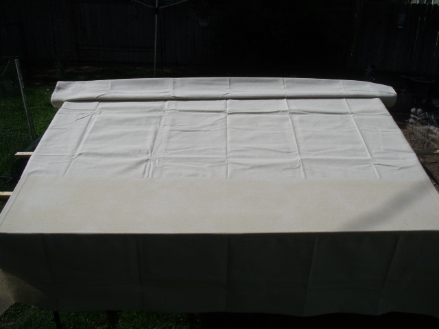

Also, I apply Harbor Freight canvas out of the bag. I use the shrinking of the canvas to help "pull" out the wrinkles and make a drum tight skin, which also aids in keeping the canvas stuck to the surface.
Canvas
