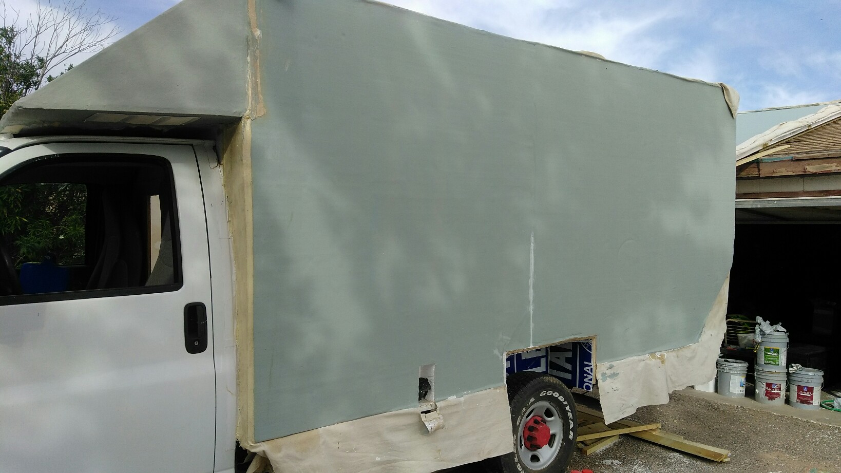

So the saga of TERRA6 continues and on with the build.
Had the walls assembled, covered and painted. Three sides is enough to assemble the box, the rear wall would be assembled and attached last.
I could raise and stand the side walls solo but difficult to get into and drop into position without messing up the glue and messing it everywhere. Was going to need help and I was in luck. The friendly ferrier happened to be there that day and I asked him to come over and give me a hand when he was done. I had prepped mounting points and holding brackets as well as bracing till the glue was set. I quickly gooped glue wherever necessary. This wasn't the situation to apply sparsely. It's the glue in the corner joints that holds the whole thing to together. And my walls were bigger, longer and heavier than any I have seen online. They would be exposed to stronger forces given the increased size, height and application.
There was nor is any proven comparable out there at this size or construction type/materials/design. A box is strong, till you move it.
Foamstream rounded the top portion giving increased strength over a box. Smart choice. Takes longer to build and adds a degree of complexity to the build that wasn't in my options. Loved the CNC trusses but no access to that.
I was counting on the adhesion of glue between plywood and 4" styrofoam to create structural rigidity and make this one strong piece.
Even now, I wonder if I should have laid the glue thicker.
The pros who build commercial cargo rigs use special, expensive, adhesive with incredible bonding strength. Glued metal pieces will shear at the metal before the bond disintegrates. They also use tight tolerance extruded metal to insert their panels, extensively tested the glue type, application method and glue quantity to ensure maximum adhesion, strength and durability. They use destructive load tested to assess breaking or failure point. I was attempting to duplicate this in a yard with common building materials and methods. The test and results will be ongoing with the completed rig.
This is a total leap of faith and no certainty by any means. :frightened:
So the first side wall goes into place no problem. Up, over and on, snug against bracing and props. Great. It was dusk and the winds had dropped. The second wall didn't go so well. Placed into position fine when one of the holding braces popped off and the whole wall dropped off onto the ground from 30" up. The top of the wall fell 10 ft in an arc to the ground. My helper tried to hold it as it was going over. He wasn't any bigger than I was. I yelled to let it go. Injury wasn't worth it over a couple sheets of styrofoam, wood, canvas, glue and paint. In what seemed like slow motion, watched the whole panel, teeter and then gain momentum, falling to the ground. Cussing internally, did I damage or ruin the wall? :frightened: more cuss words.
Could it be repaired or would it need to be replaced and whole new wall built? Damn. All these thoughts raced through my mind. Jump off the deck, assess the situation and determine the damage. Was my helper ok? Slight strain trying to retain it but ok.
The panel.
I had reinforced the wall with extra bracing for moving and installation. I had noticed prior when moving them, that the weight of the wall and the span length created flex and exceeded the strength capacity of my glued joints. Without bracing and until glued into box position, the wall was fragile and could not be picked up like one would a sheet of plywood. The leverage effect due to the length and weight of 14' was greater than the strength of the 3 narrow 4" joint bond in essence. Every joint and bond is the weakest point of any structure and requires extra reinforcement to overcome.
Picked up the wall and other than surface dents, appeared ok. The wall fell flat, so the whole surface absorbed the impact evenly. Had it fallen on an angle, who knows if the bracing would have been enough?
Took another crack at it after reapplying more glue and this went fine. More bracing installed until the roof was set and the glued dried.
This actually was the second time a wall had fallen. It happened once before when the wind changed direction as I had it leaning up against the bed. It fell over onto a 5 gallon bucket of paint and on the ground. Created a circular indentation into the foam. Wall appeared fine but once again, who knows if the internal glue bonds were weakened. Like airplane metal fatigue, not easily determined.

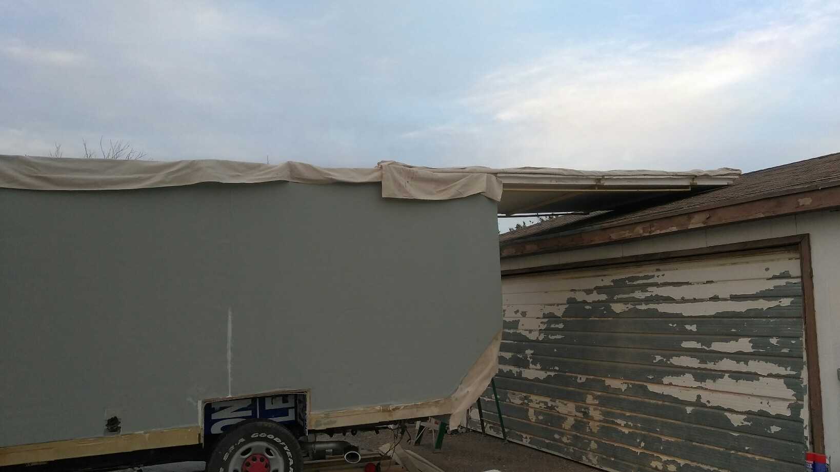

Postby Projector » Tue Jan 22, 2019 12:36 pm
The roof.
The roof.
I have stressed over the stresses of the roof. It takes the brunt of the load, flex and stresses. And add to that driving down the highway at foamie land speed record speeds, plus dirt and off road flex and impacts.
Stresses cause stress. Strong yet light is the mantra.
Only experience can determine how to build it strong for my situation and application. Had none. :frightened:
And a budget, but was going to see what I could do.
The walls are up and glue dry. Sufficiently bonded? I hope so. Now to get the roof, from the roof of the garage, onto the walls to make the roof of the box. I waited a day for a helper, no luck. I painted in the meantime. Another day goes by and nobody around that I could ask.
Damn, had no time to waste. Could I do it alone? I wasn't tall enough. Problem. Solution? I had off cuts of 4" styrofoam that I could use as a platform to walk on and increase my height. Platform shoes. :lol:
So I waited till dusk, the wind died down and went for it.
I unbolted the panel from the garage roof. Good thing I did because the wind whowled and the panel was longer than the roof, so it stuck out past the edge by a foot. Perish the thought if the wind got under there. Catastrophy.
Off the roof onto the deck. With all the extra bracing I had on it, it was heavy and at the top of my arm's length reach. Could lift it and nudge it. Get under it, push it off the roof. Moved a couple inches, hanging in the air and then stuck. One of the braces was catching. Damn, it was getting dark fast too. Lift and raise it with a block. Remove the brace in the way. Remove block. Couple more inches.
Then pulled and pushed it onto the notch I had made on the side walls. Fit snug and perfect. Great, love it when design and plans works out well. Push and pull a little bit more, move it another foot or so. It was starting to get harder as I went along for two reasons. One, the panel was being supported less by the garage and more suspended over the span between the van and roof. Second, my notch was a tight fit and the panel was at a slight angle and thus catching in the notch because it wasn't parallel to the wall notch. Damn, more cussing.
It's getting darker, the last rays of sunlight are dispersing and getting fainter. Back up on the roof to align the roof to the side walls to properly slide into it's notch. This was precarious in itself, getting up off a 6 foot ladder and scrambling onto an 8 ft high roof ledge. My father at this same age had fallen off a ladder going up on a roof and it didn't end well for him. The thoughts that go through ones mind. I was cautious yet agile at the same time. It was getting darker by the minute.
Back down and nudge it another couple inches. It was getting heavy with all of the weight now mostly suspended and required to be pushed into position. The friction of the notch increasing the resistance the further I went along. Persistence. Keep at it, got to finish before it gets dark. Couldn't leave it hanging or wait for anyone, wind was supposed to blow again tomorrow.
Push, grunt, sweat, strain, cuss. Break, push some more. Difficult when at the end of your arm reach and overhead.
Managed to finally slide it onto final position. I think. Was it? Damn, it was catching on the front nose cone on an obstruction. It wasn't flush. But it was off the roof, set into place. Should be fine, right? Could stay there and deal with it tomorrow. Would be ok, right? Was concerned that the side walls would hold. Once again, had no reference to confirm that it would. What is the load bearing capacity of a 4*8 sheet of 4" styrofoam?Someone knows this but it isn't common knowledge. Well, so far so good.

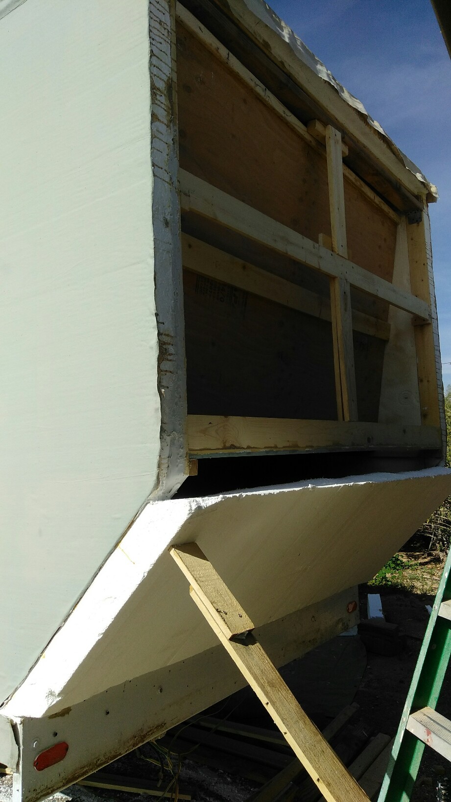

Ok the roof is on. But how did I get it on and glue at the same time. One of the on the fly methods that must be developed for assembly. Can't put glue and just drop it on. Needed a crane. And where were you with your crane when I needed you? :roll:
So I would get the roof on, raise it up off the notch with blocks, goop the glue into both sides of the notch. Remove the blocks and let it drop into the glue. Weight be sufficient to press it into the notch for a tight, secure, waterproof joint. Ideally. Hopefully. Maybe.
The thing is, these styrofoam sheets are not precision machined for straight and uniform edges. They kind of are. And my hand cuts and notches are the same, kind of sort of even and straight. One does the best with what one has.
And so I did. Propped, glued and dropped. And it's here were one sees how straight and flush all the pieces come together. Or don't. Or kind of, sort of, mostly in this case.
If anyone has any construction experience, things are never a perfect fit and require adjustments as you go along. Trim panels were invented to hide flaws if you didn't know. Oops. Forget I said that, it's a trade secret.

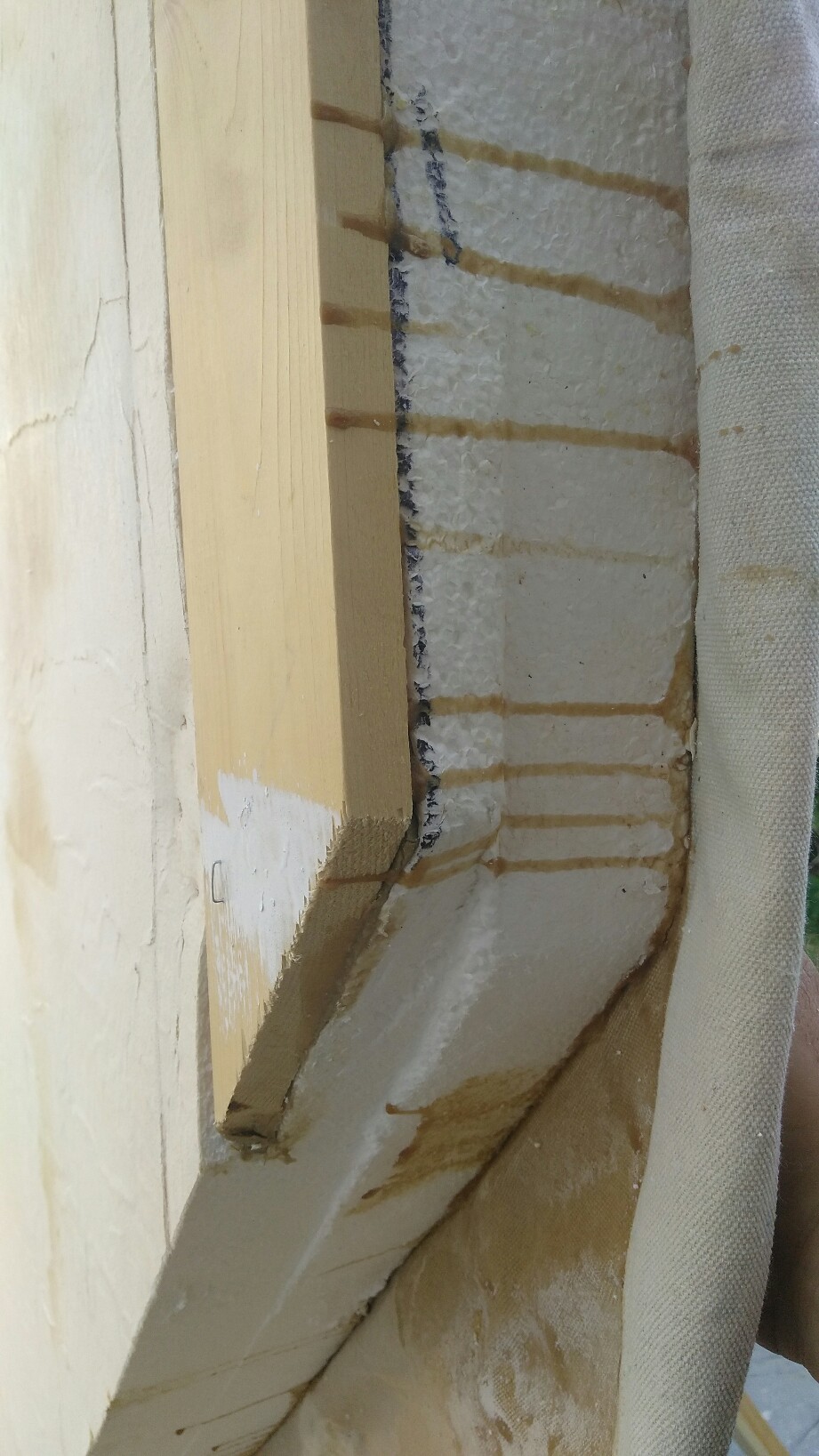

Postby Projector » Tue Jan 22, 2019 1:14 pm

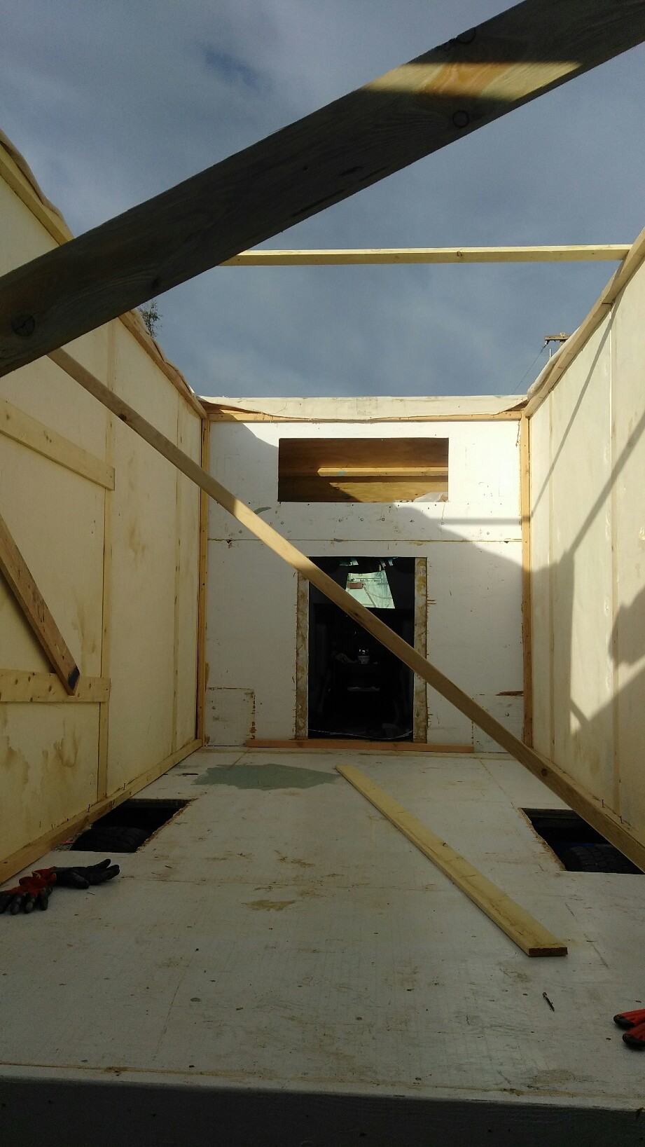

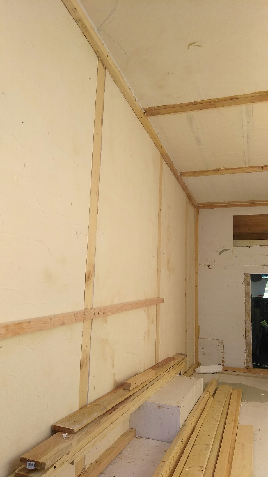

Ok, looking like a liveable space now.
Or potentially. Yay.
At this stage, it is shelter.
You will notice that at this stage, inner bracing and support is every 48" on center at every seam/joint with flat boards for the walls and my homemade T trusses for the roof. Made the decision to go minimal and light at this stage. Should more be required, I could always flush mount more bracing for more support.
I was also relying upon the interior build to give further support to the external structure, stiffen the walls, help support the roof and to give additional ridgity.
At least that was the theory. Ideally, hopefully... You know the rest.

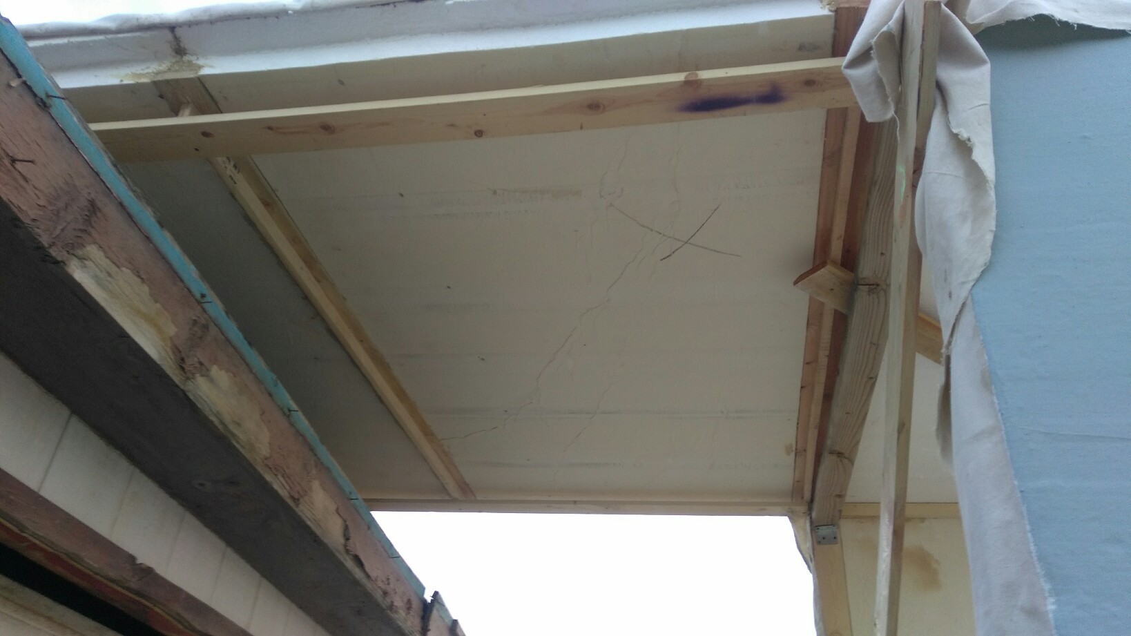

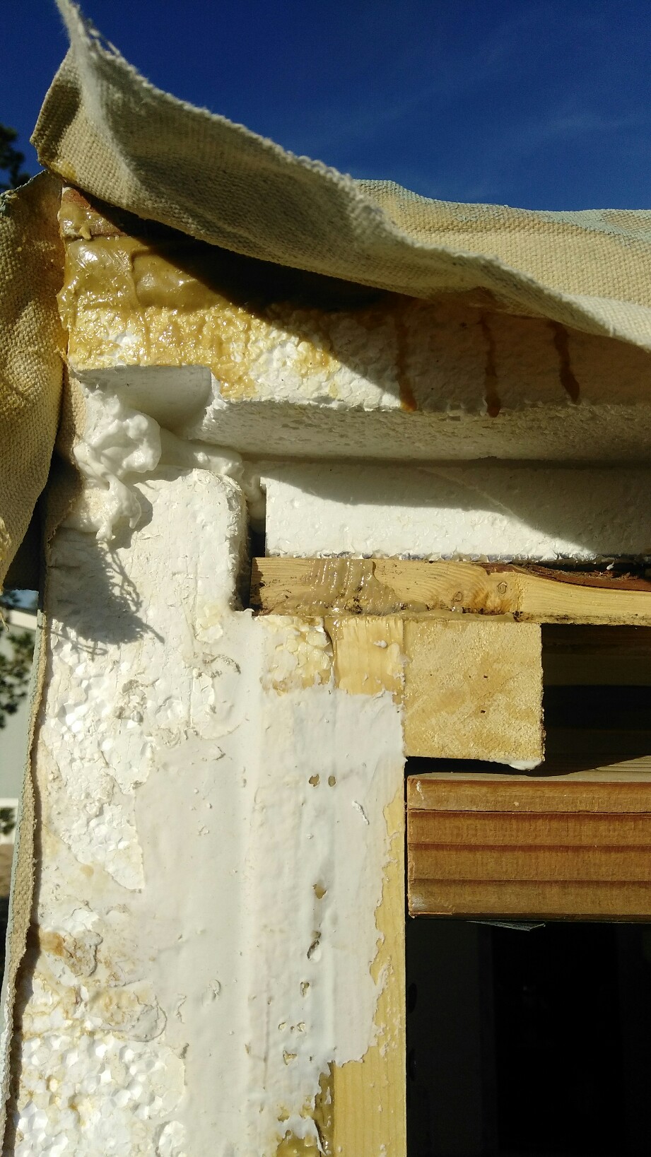

Postby Projector » Tue Jan 22, 2019 1:16 pm
The corner notch.
See how well machined and precise the notch fits?
Or not. Time for the great stuff foam to fill, seal and glue.
Actually used the GE spray can foam. Or was it the Loctite? They both claim denser so I tried it.
Don't know if it's better.

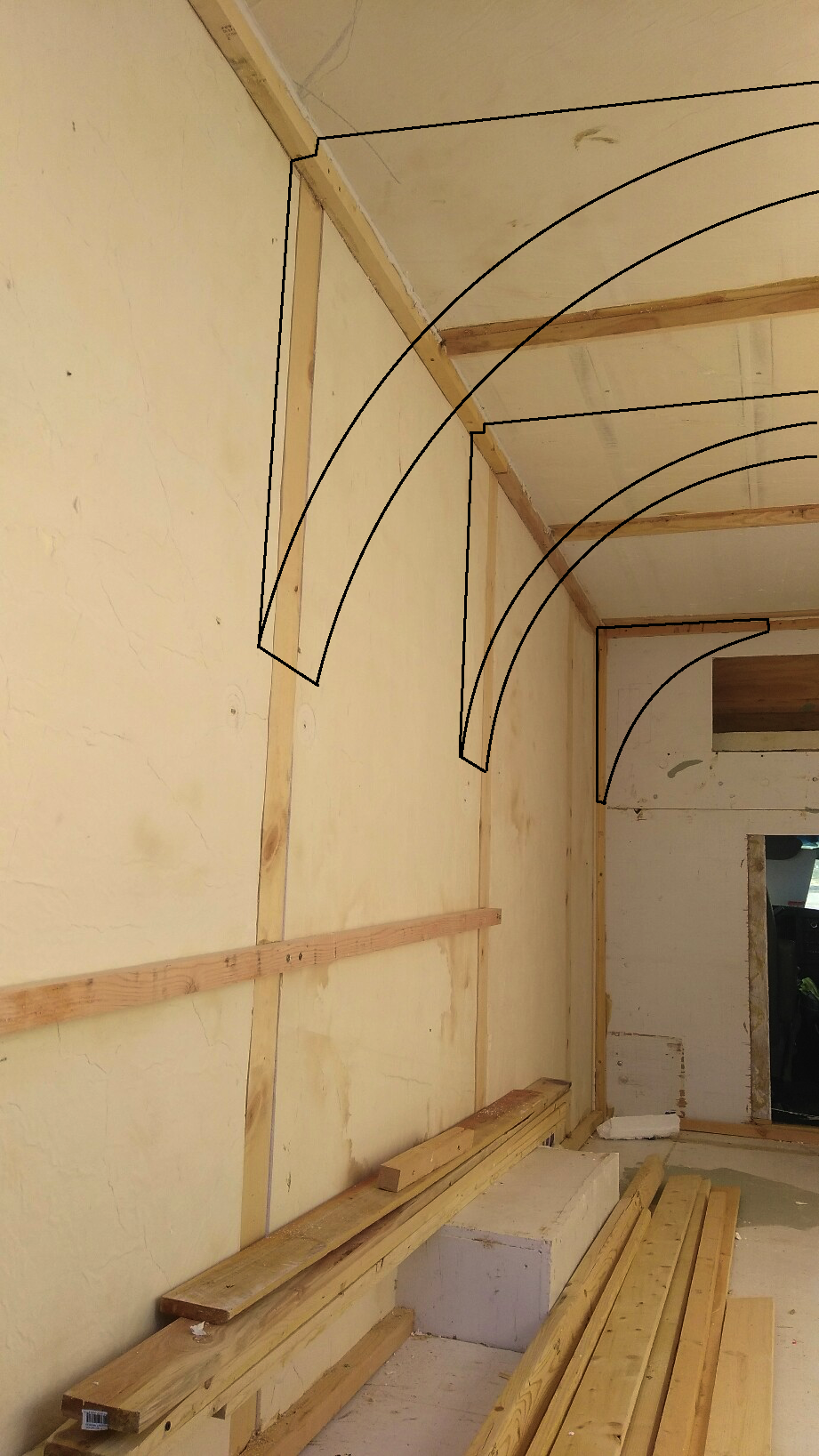

"If anyone has any construction experience, things are never a perfect fit and require adjustments as you go along. Trim panels were invented to hide flaws if you didn't know. Oops. Forget I said that, it's a trade secret. “ Also reinforcing strips of canvas cover many sins , and add great strength on the less than perfect seams .
"Many RVs are packed to the gills with every possible thing leaving little open space just to move and breathe. Find that constricting and imprisoning “ Yes , a lot of that was for somebody’s idea of home decor ( pretty for the Ladies ) , little of it practical in application , none of it Comfortable …. The reason I left mine basically Empty with lots of cushions and pillows … room to move things around in the limited space and not claustrophobic at all …
You’ve got a great large space there , don’t be in a rush to fill it up …. not until you see what you really need and am willing to haul around all the time … Remember , it’s easy to add something, harder to take it away!!!
Just an idea , if you feel you need more strength in the wall to roof join , you can always add some Foam “Arches” inside that can be decorative and provide a lot of strength …especially with 4” thick material …you could cover those with old bedsheets and they would add lots of “flex” strength to the roof/walls ... :thinking:
