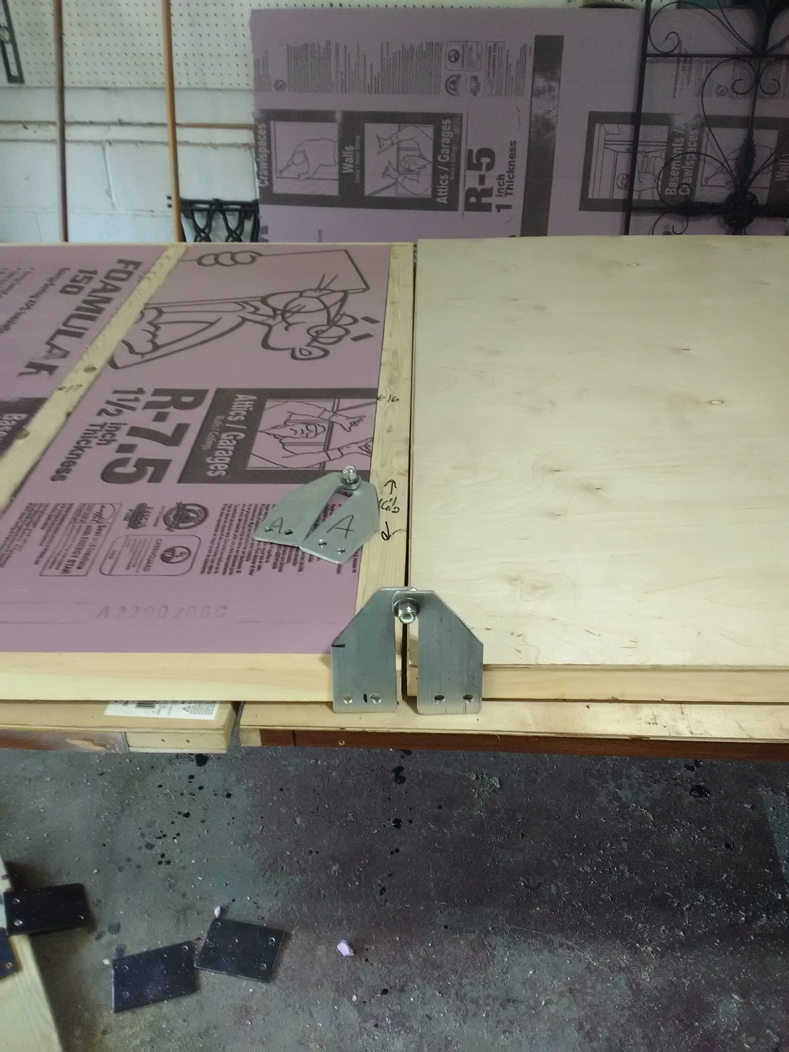

This picture shows the framing with the insulation board on one side and the plywood cover on the other. i havent done a complete weight but will guess at 60 pounds. Have you looked at the DIY Roof Top Tent group on FB. Lots of builds and ideas.

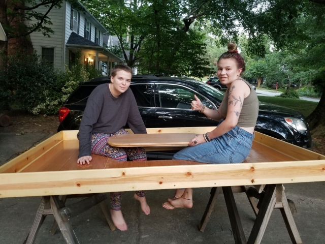

I'm far from an expert, but I am doing something similar. I'm building what I'm calling a Trailer Top Tent which I plan on putting atop my utility trailer.
My construction is a 3/4" poplar frame, filled with foam and TiteBond 2 laminated with 1/4" plywood (both sides). There is now a 3/4" x 5-1/2" frame glues screwed and epoxy filleted to the floor to add rigidity. I can lift this floor alone, but I would have a hard time putting it on the roof of a car. Two people can do it easily. When this picture was taken I was frankly rather impressed at how little deflection I saw. The sawhorses are further apart than the support will be on my trailer, so I didn't bother getting numbers. In my case, the center hole through which my kids legs are dangling is a removable hatch that will have a removable leg so it can be used as a table.
I actually plan on getting a weight for the pan as I'm calling it, but it is currently threatening a T-Storm and I don't feel like getting caught out!
