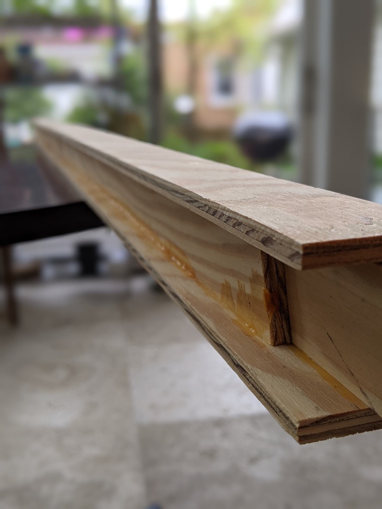

I like the idea of actual I-beams. I made this out of 1/4" plywood scrapes. I used my angle grinder with a flap disk to scarf together some strips so the length can be whatever you desire. I might use this for a strut on my PMF foamie roof that will be 5' wide. I am not sure if it was worth the effort but it seems quite strong and light. The commercial manufacturers of these things claim you need special techniques so maybe this is not a good idea.

tomhawk wrote: The commercial manufacturers of these things claim you need special techniques so maybe this is not a good idea.
The only thing different between yours and theirs is a engineer signed off on it.... :roll:
