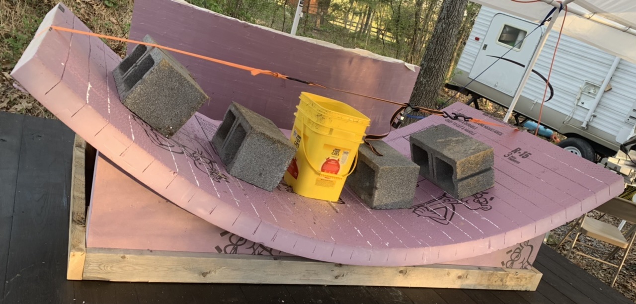

Second roof arch. This time I cut the kerfs with a saber saw instead of a circular saw. The kerfs were thinner so I increased them from every 3.5” to every 3”. The saber saw blade didn’t get gummed up with melted xps like the circular saw did either.
I glued the kerfs with Foam Fusion out of the 8oz squeeze bottle and it went into the kerfs very smoothly without mess or difficulty today. I kept it indoors overnight this time so it didn’t get cold and thicken.
Filling the kerfs. (Playing with my iPhone, don’t mind me ; -)

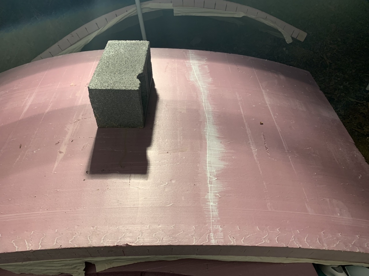

When I put the second roof panel into the form, the narrower kerfs of the saber saw blade weren’t quite enough for the bend, despite decreasing the spacing of the kerfs and therefore increasing the number of them. When I was tightening the ratchet strap to get the last half inch of curve in the panel, I heard a loud “crack.” The xps foam had cracked apart on the outside roof side, between kerfs on the opposite side, fortunately. I went ahead and applied the muslin layer for the pmf on the inside ceiling surface, let it set up, then flipped it over after about three hours.
The Foam Fusion has an aggressive enough bond to the xps and muslin that I felt comfortable flipping it over that soon, even though I hadn’t applied the second thin coat of Foam Fusion over the Muslim yet
I filled the crack, which was about 3/4 of the way through the 3” xps, with Foam Fusion and set a cinder block on top for it to set up over night.
I’m cutting a half dozen more kerfs in the third panel to achieve the proper arch before I glue the kerfs in the next panel and set it in the form.
