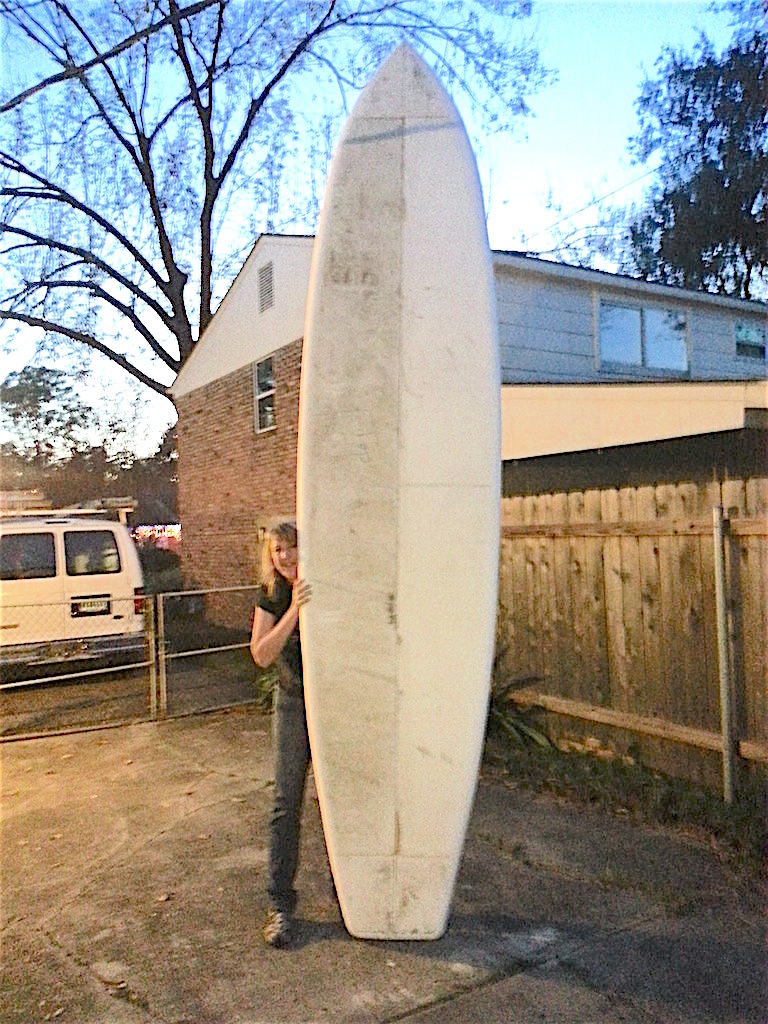

... :thinking: something like this ???

The young lady in the picture is 6'1" tall and needed a long board ... :o It was so easy to make . :D

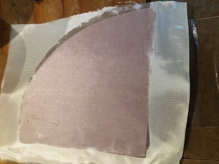

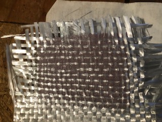

Took a while, but I mocked up both weights of fiberglass onto the XPS.
That's the heavy weight fiberglass, obviously. I think if I needed the structural rigidity that gave, I'd have to put down a lot thicker coating of fiberglass.
That's the 6 oz fiberglass, I think it's how it's described. I put the epoxy down over the XPS and placed the fiberglass on top, then smoothed it a bit with a stick. The epoxy wicked up through the weave just like they said it would, and the finish is pretty good, some high and low spots, but the idea was to put another layer of epoxy over top when the first coat came to just set. Unfortunately for this side, set happened after only a few hours, where I expected it to stay open for a day or so. This is supposedly 72 hour cure epoxy, but having never worked with it before I may have misunderstood the time it would take to get tack free. Anyhoo, I'll be doing the back side so I'll keep a better eye on it and add my second layer before it sets this time. Probably watch another video ;) . The shape of the XPS was to see how well it cut with the jigsaw, I just buzzed through it with a coping blade, it did a decent job, but I'll have to take my time when it comes to the actual pieces I need for the cabinets.
I don't know why that second pic of the heavy FG is showing up in the post, I don't even see it in my text. If a mod can delete it, I'd appreciate it. :thumbsup:

kstills wrote:Took a while, but I mocked up both weights of fiberglass onto the XPS.
Looks good, just practice on few more small samples and it becomes easier each time.
A couple of tips:
Ive found that prepping the foam to an 80 grit finish produces a better glass to foam bond. I use a cheap random orbital sander to do this.
Get a few plastic bondo spreaders https://tcpglobal.com/products/dynatron-3-pack-spreaders-358?_pos=2&_sid=a8250cbf2&_ss=r and squeegee the cloth down with them. it will produce a nice flat finished product. If you wipe them off with a paper towel when you are done they last forever. You can get these at any auto body supplier for a buck or so each.
a chip brush https://www.harborfreight.com/1-in-chip-brushes-36-pack-58084.html does a great job of wetting out your workpiece. Also used to work air out of the cloth and the resin into the cloth. Use an up and down motion like you are poking the workpiece with the bristles, if you use it like a paintbrush it will distort the cloth, which is to be avoided.
I have used 6oz per sq yard cloth almost exclusively on my build. Give a multi ply layup a test. 2-3 layers will surprise you with its strength.
