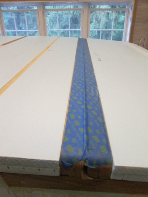

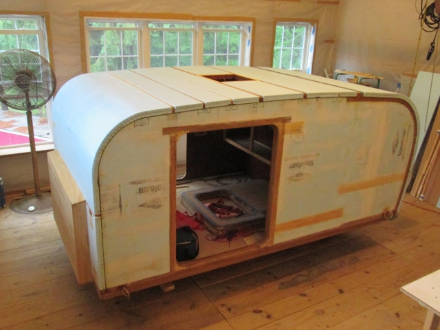

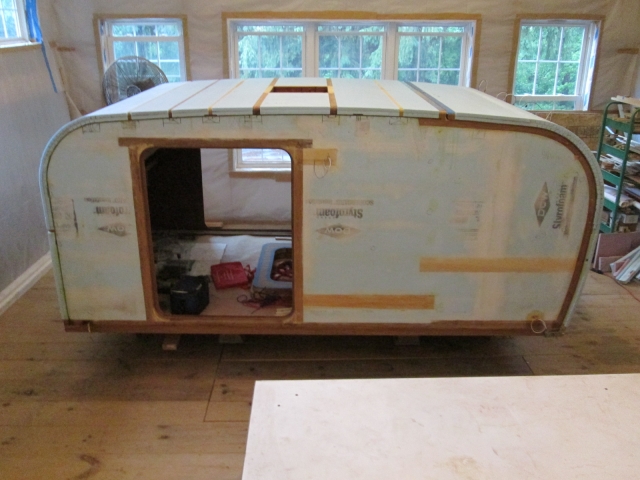

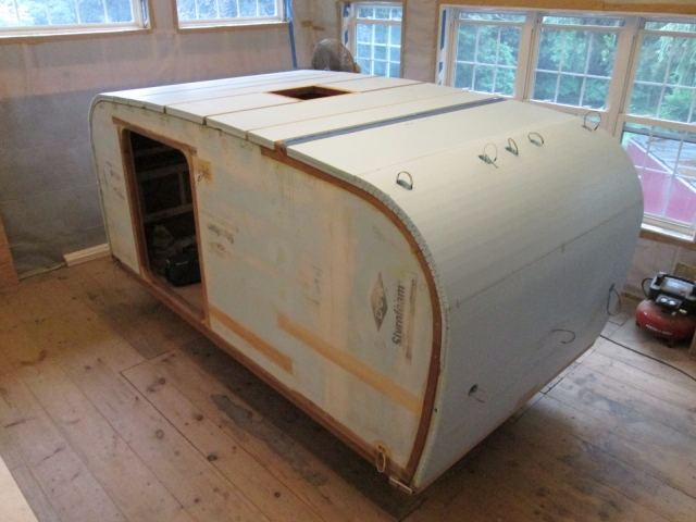

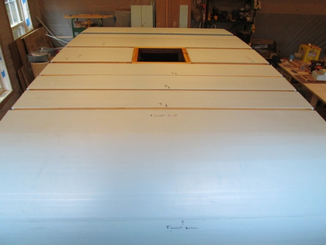

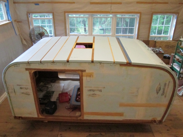

Had a good night in the shop. Hit another mini milestone getting all of the roof foam dry fit.
Ripped the panels that needed to be ripped. I ended up with 4 of the 2 ft wide x 64-3/8 long panels left over, plus some bits and pieces, so I suppose I didn’t need to piece so many sections together for the first layer. Not sure how I over estimated except to say that you can piece foam together with relative ease.

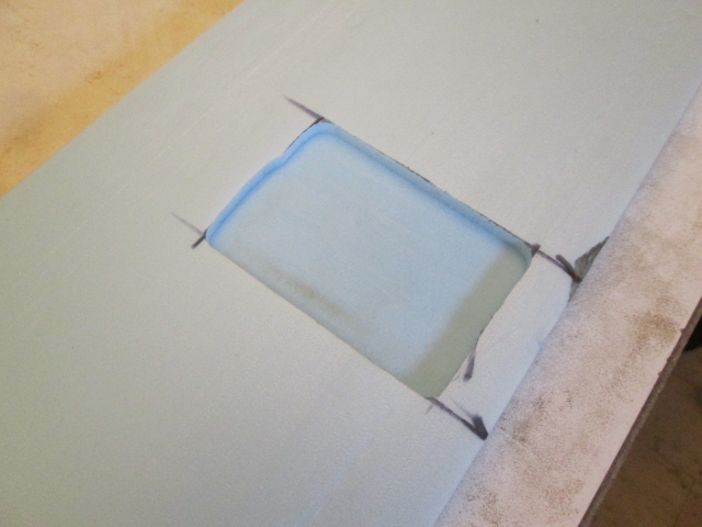

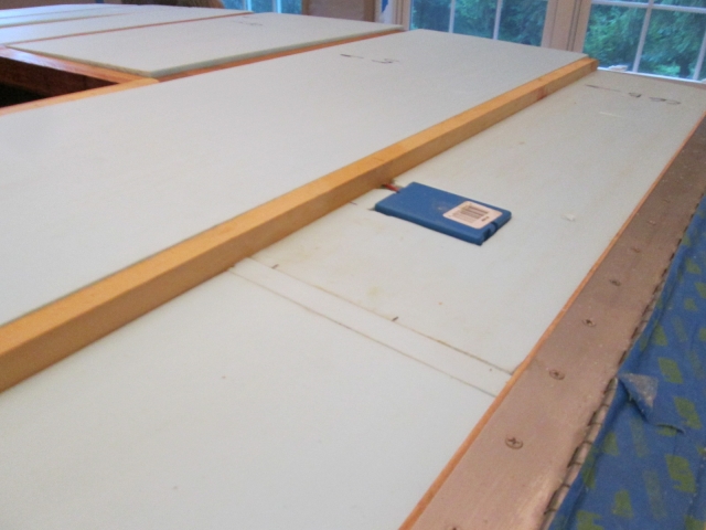

Several of the holes for the wires running thru the roof spars were at or slightly above the middle of the spars. So even though the routed grooves in the first layer of foam were deep enough for the wires, where the wires went through the spars they still tended to hold the 2nd layer of foam up a bit. So I ended up routing corresponding grooves, though shallower, in the underside of the top layer pieces. For the last panel where the ceiling outlet box sticks up thru the first layer of foam a little, I routed that area out about 3/16 inch.
The rest was just a little bit of sanding on the edges to get the panels to fit just so.
In prep for adhesive, I ran another strip of 2 inch tape to mask the front side of the hinge (I had done the rear half sometime back).
In typical fashion, when I’m happy with the progress I take more pictures!
