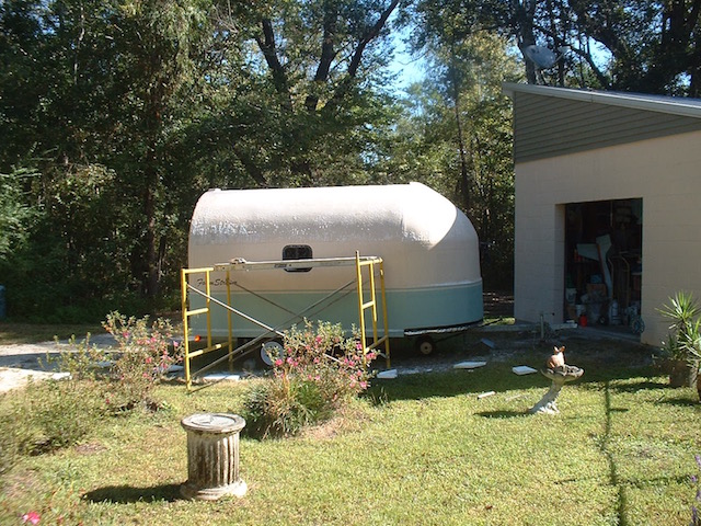

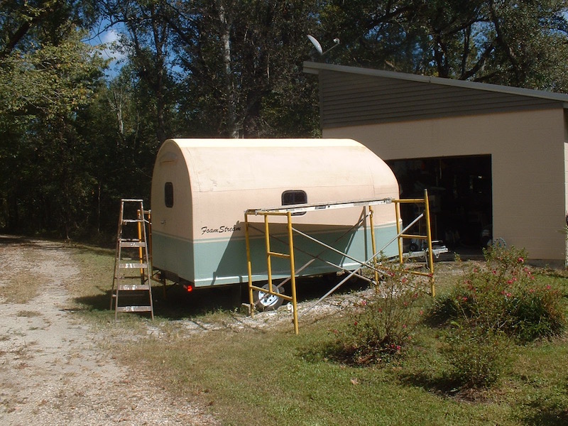

With the continuing decline in the threats of Hurricane season , and the promise of good weather ( well a couple weeks of it anyway ) ... Thoughts turn to working on the FoamStream ... Now that we have the scaffolding we can easily access the roof ... ( a problem before on a shakey ladder ) . That “ridge" that runs down the top is finally causing problems , the shrunken canvas pulling away from the square edges of the ridge where it meets the roof . leaving an air space behind that part of the canvas ... :frightened: The plan will be to peel the old canvas off that arera, physically cut the foam ridge off the trailer , then smooth it down flush , and recover the whole area with some fresh canvas... leaving just a smooth rounded top ... I’m lucky enough to have found a skilled younger guy I can hire to help , I’m getting Old now and the help will be much appreciated ... Not really a one man job anymore ... not for me ... :roll:
Just chalking this up to “design changes” after the fact ... and a little yearly maintenance... We already have the new canvas, a gallon of TB2 , and hopefully enough paint to match ...so no out of pocket expense save paying the helper ..
Report: The drip edges are working really well at keeping the floor bottom nice and dry , even in this most WET season ... Hopefully we’ll find something more permanent for the rounded front floor ... The Gorilla tape is still holding ... Amazing ...

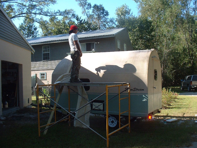

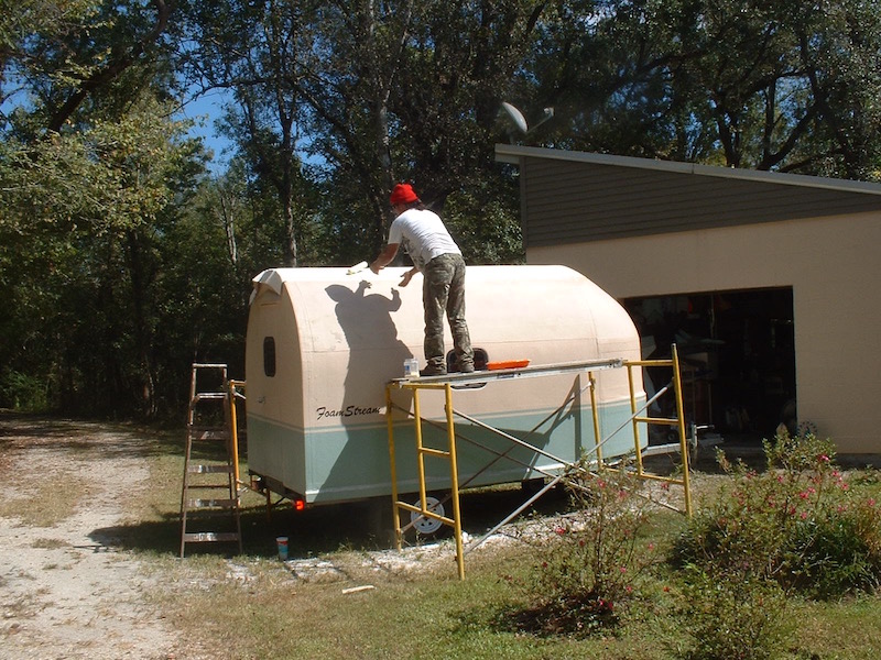

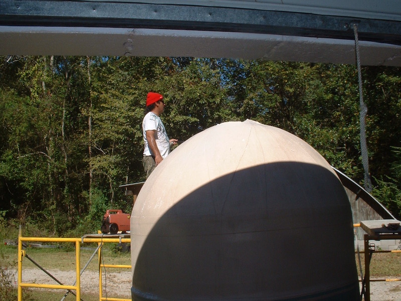

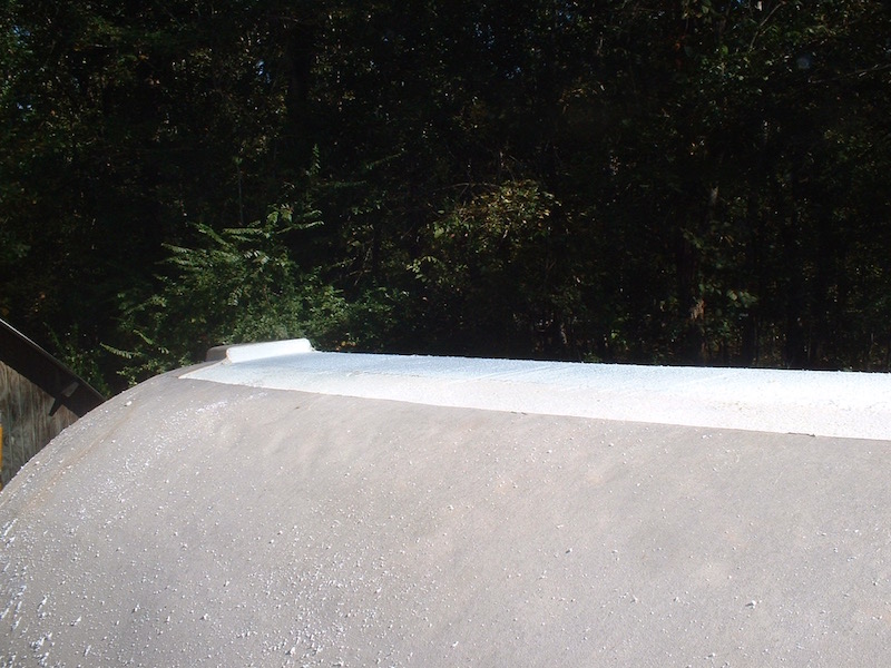

Finally a week of DRY weather , and my part time helper had some free time , so we started this morning 8:00AM ... scaffold up ... Marked the roof and cut back the old canvas and discarded it , used a sharp hand saw to cut the top ridge off and a farriers rasp to smooth it into contour with the rest of the roof ... Cleaned everything first with Mr. Clean , then Denatured alcohol .... Sanded the painted surface to create more ’tooth” thyen vacuumed the entire roof ( foam beads EVERYWHERE .. :o ) Then laid down the new canvas after a Liberal application of T2 ( rolled on ) we used a whole gallon to put this piece on , so there should be enough glue ... ;) Let that bake in the sun for an hour while we took a long coffee break and talked about hunting .... then went back out and put the thin sizing coat on (something we neglected last time :oops: ) ... Tomorrow we’ll put on the Gripper and go buy some new paint .... decided to paint the whole trailer again ... Don’t know if we’ll do the same colors or just paint it one solid color ... ( I do like Laura’s bright green trailer color 8) ) So 5 hours work , we have a new 18oz. canvas roof , well glued down and ready to paint ... not bad for a mornings work ... I love Foamies .... :D Here’s the pics ...

Add the “Croaker" ( $100.00) we gave the helper ... He is experienced (jack of all trades) and was a really BIG help ...!!! Still not so bad ... :D
Having that scaffolding made a HUGE difference in how easy the job was... The Old guy up on the shakey wooden ladder just wasn’t working very well ... :roll: :frightened: One fall , that’s all ...
