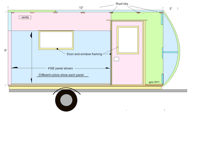

Ya’ know, I was just thinking :o Since the little one is almost complete... I do have that other trailer that isn’t big enough for a FoamStream , yet could be a usable foundation for yet another Foamie build ... :thinking:
Here we go again !!! :roll:
Postby GPW » Thu Dec 22, 2011 9:18 am
Just an idea ... :thinking:
