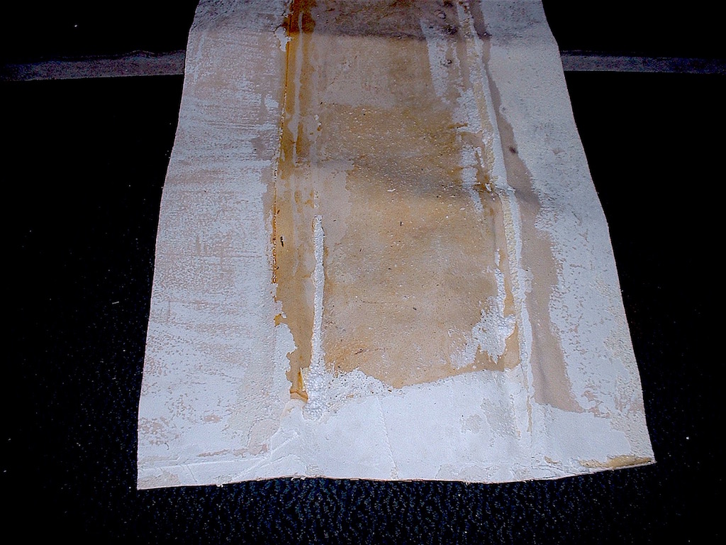

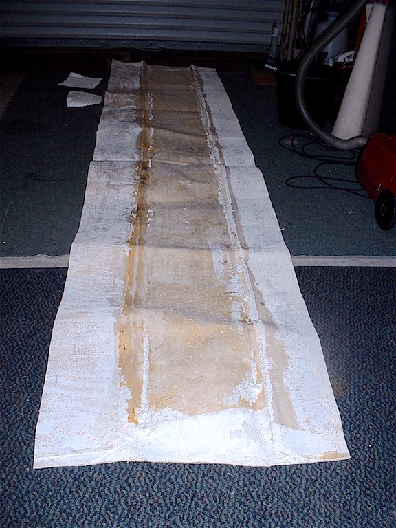

Just a quick analysis of the canvas we removed from the top ... You can see some areas have stuck well, others appear to have no glue at all ... ( I blame myself :duh: ) Some areas removed the spackle filler ...that was useless...
Neither gripper nor T2 got FULL coverage on the canvas , nothing serious underneath , no rot , but a little discoloration ... Had we used a sizing coat this might not have happened... and anyway the canvas had shrunk away from the ridge top creating an airspace behind the canvas , between the canvas and foam ... grrrr!!! All better now ...
