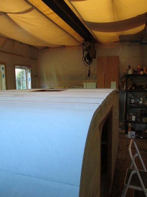

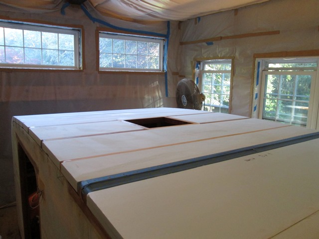

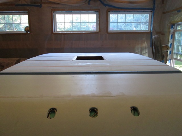

In this mostly accelerated 3:16 min vid I start out by trimming the overhanging roof foam excess at the front radius and front wall edges with the steak knife. Those areas were overhanging a good 1/4 inch or more. Then I switch to the coarse 36 grit block and take it down close to the finished surface; then I finish with 100 grit wrapped around a longer piece of 1x2. Note that Karl and I both fuss over the end of the hatch foam near the hinge spar. That’s where I smacked the sanding board into the edge of the hatch foam several times and broke a chunk out (still pics below).
Sanding Curb Side Roof Edge
Here’s an in process pic, looking from front to back along the curb side roof edge.
Further along.

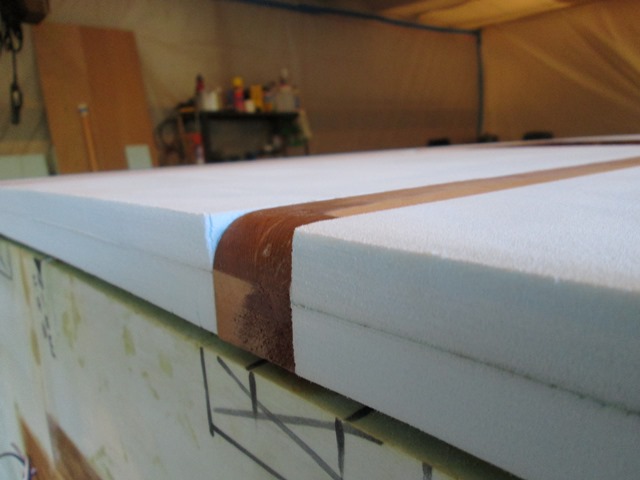

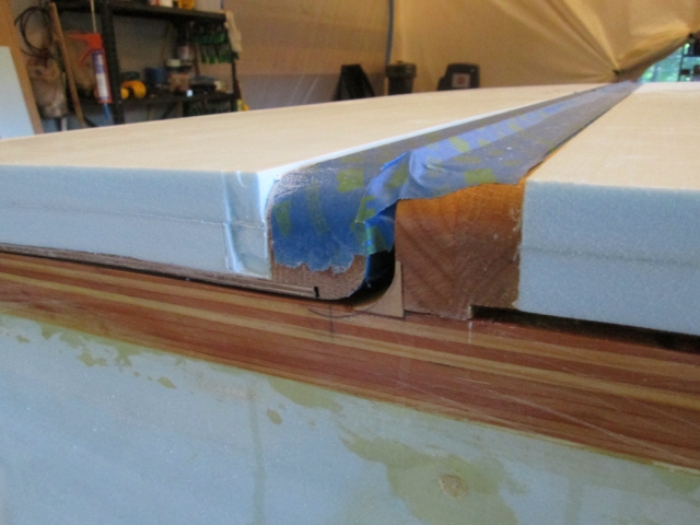

Then I went on and did the edge of the hatch. I should have done these together as one big job. If I had I might not have hit this edge so hard or so many times.
Once I removed the excess the damaged area wasn’t so bad, but it will still need some filler (will probably us GS).
Using a strip of 1x2 wrapped with a sheet length piece of 100 grit, I got a little sloppy with my fingers hanging onto the edges of the block and gouged the edge of the hatch with my finger nail. This will all go away when I round the edge over, but it was a lesson learned; I used the small oak block to quickly sand my fingernails down and prevent recurrence.

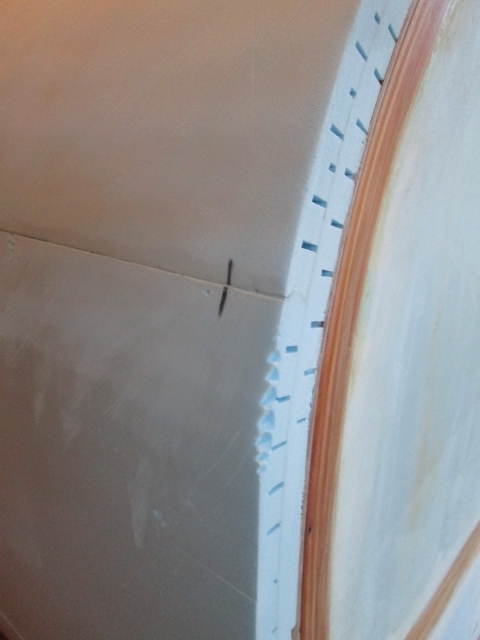

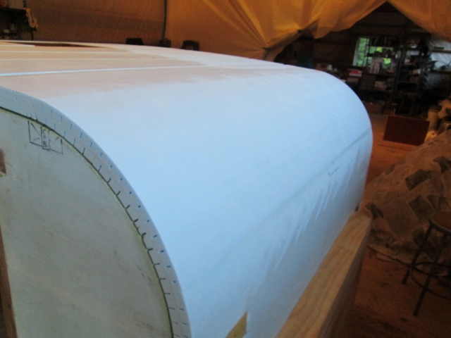

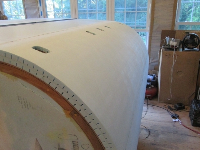

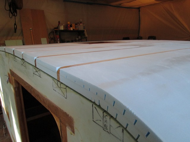

I had a little more time, so I attacked the facets from the kerfing on the front and top rear profile radii. I used the small oak block working in an alternating diagonal motion up and down along the radii constantly moving from side to side to take the low crests off of the creases caused by bending at the kerfs. I have a little more work to do, but it didn’t take too much to make a big difference. You can really feel the difference when you run your hand along the profile.

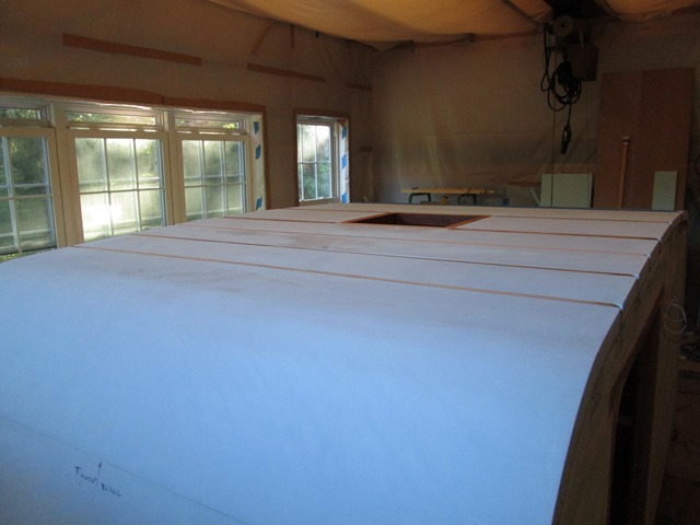

Yesterday I roughed the top surface of the roof panels down on the curb side using the curved long board and 36 grit. The technique is to keep the board parallel to the long axis (to match the curve of the profile), but to work in a crisscross diagonal pattern to keep from hogging out any one spot. The length of the board ensures that it rides over at least two roof spars at any given time. Link below is to an accelerated 3:13 min vid. Note that when I use the vacuum I am careful to keep the corrugated vacuum hose from dragging on the edge of the roof, lest it act like a big rasp and “bark” off chunks of the foam.
Fairing Curb Side Roof Foam with Curved Long Board

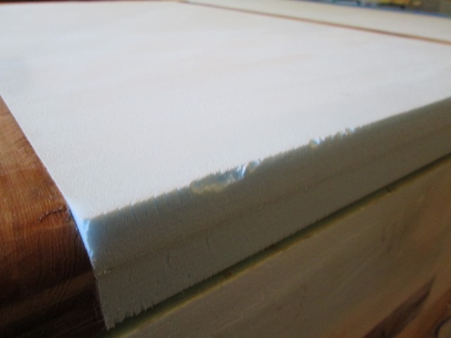

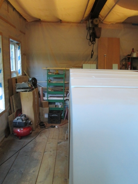

Here’s a minor example of a vacuum hose bark. This spot will get cleaned up with the round over, but could quickly become much worse if I was careless.

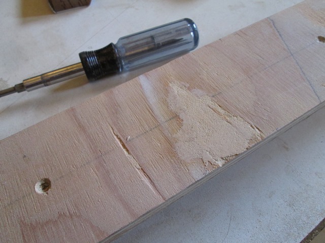

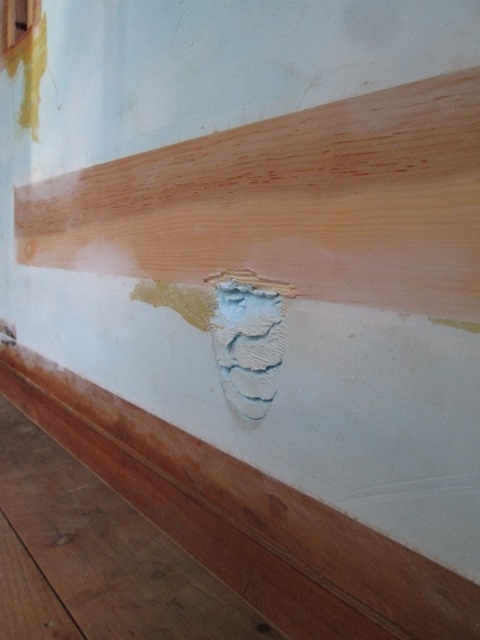

Here’s the big boo boo from the incident with the jack. Nice hardy bark, about 2-1/2 inches wide x 3 inches tall. Kind of left a shingled effect the way the foam chattered and tore.
Here’s the patch to the long board before sanding the filler back smooth to the contour.

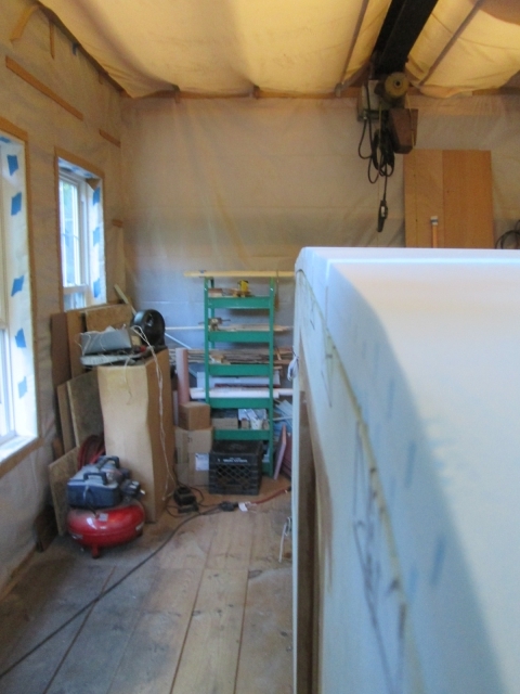

I tried not to get too carried away posting all of the still shots I took of the roof fairing progress after 100 grit, just in case they all look the same as the rough in, but you can at least see how the foam is all pretty fair to the spars, and how the texture is starting to look smooth again (at least on the outer two fifths… still need to finish the middle section, but ran out of time tonight). Still a little work to do at the transition from top roof arc to front radius, too.
I’m reminded of the old one liner, “I just flew in from Cincinnati and, boy, are my arms tired”. But not really as the foam sands fairly easily.
Rolling along.
