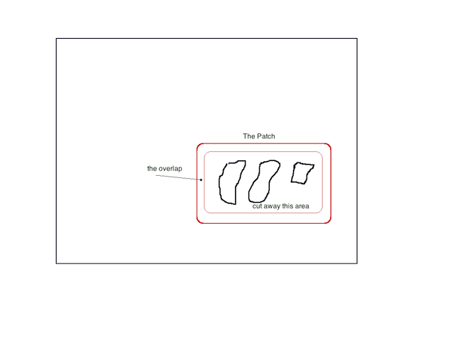

i am curious about that patch work thing, doesn't that take away from the "sock" effect? since it would not be a solid unit covering anymore.

Postby GPW » Fri Dec 23, 2011 9:52 am
The patch would have a generous overlap on the edges ... cloth to cloth is pretty secure , no matter what glue you use ... Do we need a picture ? I can do that in a minute or two ..

Postby eaglesdare » Fri Dec 23, 2011 10:29 am
hey glenn, you know i like pictures! thanks that makes some sense to me. :thumbsup:

Postby linuxmanxxx » Fri Dec 23, 2011 3:37 pm

Postby linuxmanxxx » Fri Dec 23, 2011 7:33 pm
Ok I'm thinking the front happened first because of all the additional stresses placed on it during travel which the other sides get little to none. This is actually a good thing and I think if you just wait and get some of the lagging compound and redo just the front you'll be good for the duration of the lifetime of your camper and maybe have to fix some small ones if they happen to pop up on the rest of the surface.
If you patch it I'm betting that it will happen somewhere else on the front and then you are just applying another patch until you finally have it all recovered again. Peel the front up to most of your front curve and just recover it and I'm betting you won't have to touch any of it again.
Now that's the beauty of this canvas type of build is that repairs are cheap and relatively easy compared to a standard build of camper.
You did bolt this down to the trailer rather well didn't you? If so I'd try a trip without the straps as that would put additional stress on the front every time you cinch them down tight and then release them later. If you bolted the floor down with large washers to spread the load, you won't ever have problems with the cabin separating from the trailer.

Postby GPW » Fri Dec 23, 2011 9:24 pm
Steve, I was wondering about that too... those patterns of bubbling were ...curious ... Didn’t look like random bubbling which would have been everywhere huh ? ... Now I wonder if the straps were flapping in the breeze , beating on the front ??? :o
You’re right , they’re so easy to fix... they never were intended to be Pretty works of trailer Art like everybody else makes , just Thrifty and Practical (hard tent)... so patching is OK !!! If it was me , I’d give the Whole trailer a careful inspection , see if there were any more problems ... if not just patch the front and don’t use straps ...
