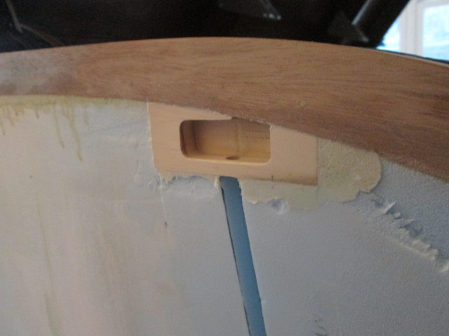

Last night I routed the other 3 clearance light wire ways. On the rear ones, since I had the router set at full depth for one pass in the foam, I did over and under the side table blocking as an interrupted cut, then went back and step cut across the blocking using multiple passes. I hope to glue the clearance light blocks in this evening.

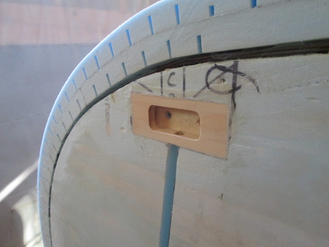

It felt really good to get back on the build today. Got the side clearance light blocks glued in and sanded back.

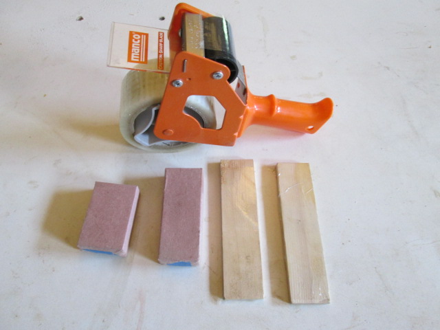

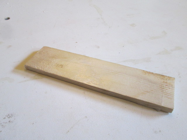

I started by getting my clamp blocks ready. The two with the rosin paper will go against the finished insides of the galley walls. You can’t see it, but the wood pieces have a strip of packing tape on one side. Someone here had better luck using packing tape as a release agent than I have been having with blue tape, waxed paper, and plastic coated freezer paper; so I decided to try it.

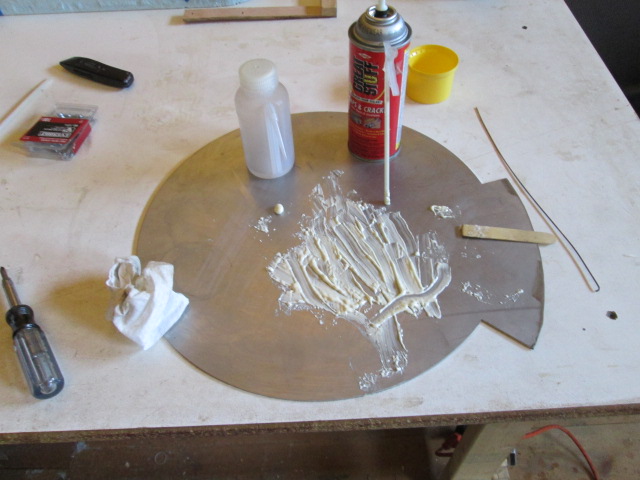

I used my big SS palette (that I typically use for body filler) to squirt the GS on and knock down the initial foamage. In retrospect it took a bit of effort and much acetone to clean this back off later, so if I were to do it again I would look for a disposable piece of cardboard or something else to mix on.

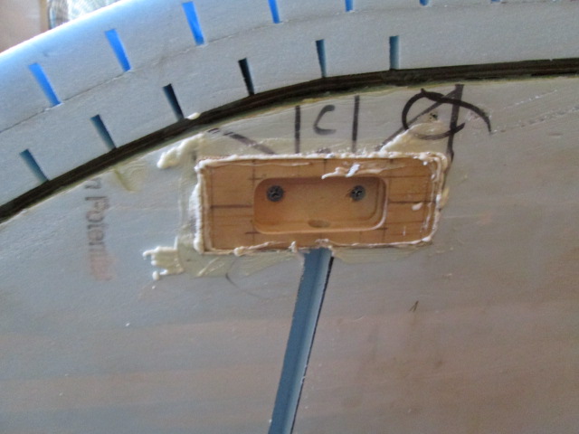

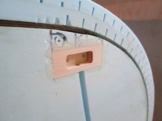

I had such a good fit that I probably should have just used TB2 to glue the blocks in, but the G-stuff kicked off much more quickly and by the time I was done with the cleanup I was able to go right into sanding flush. Here on the front street side I smeared the flattened GS on the sides and rear of the block, pushed it in the hole and screwed thru the wire recess into the front cabinet face frame wall blocking using a pair of #6x1/2 FH screws.

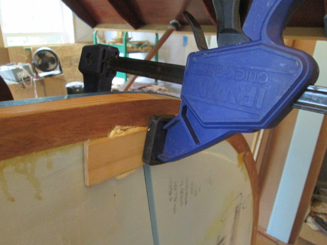

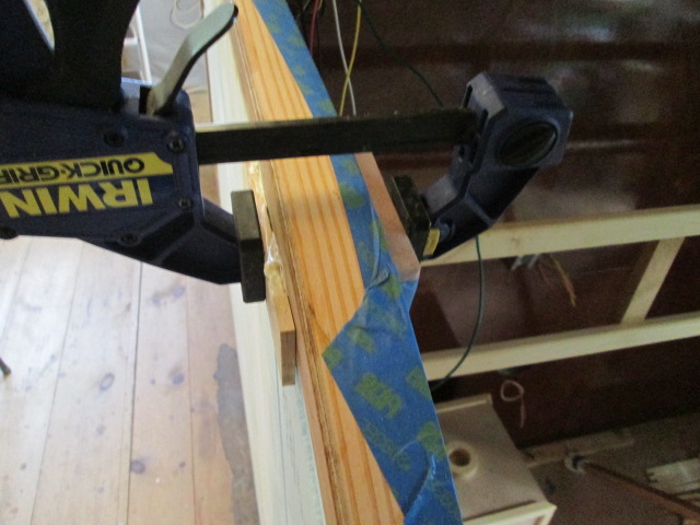

At the back I used the clamp and blocks to hold the light block in. I was only just a little nervous about getting the taped clamp block free later.
Did the same thing on the street side.
I figured I would have to let that all sit overnight, but the GS seemed to have done its thing so I went ahead and took the clamps off. I did have to pry at the clamp blocks a little but when they came they popped right off clean as a whistle.

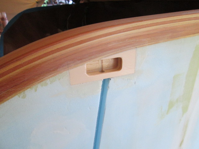

While sanding the front (left in pic) edge peeled up under the sanding block and took a little of the blue foam with it, but that will “buff out” with a little spackle. The large gouge at the back is from that incident with the DA sander (note to self: stick to hand work whenever practical… the screw ups are smaller and take longer to rear their ugly heads).
The fronts were a good 1/16 proud and took a bit more sanding. Here are the front street side and curb side, respectively.
As usual, the last one came out the best.

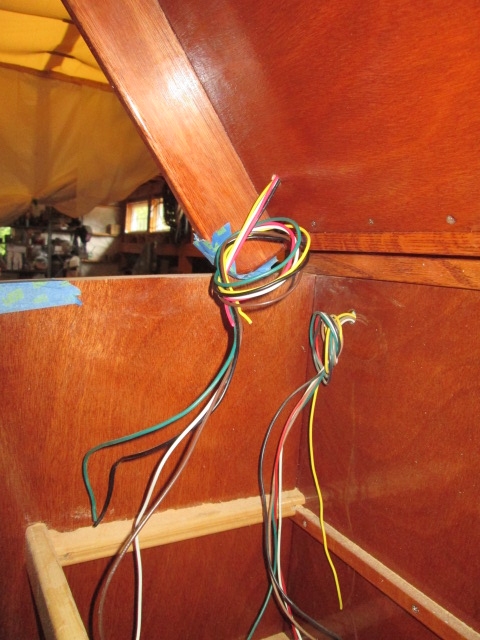

I’m not sure if I showed this before, but this is where the hatch wires come thru on the street side and will be joined to the cabin wiring coming out near the top of the bulkhead under the hinge. I have a 6-way weatherpack connector and some corrugated wire loom to dress it up. The hatch may have to come back off to do a proper job on the canvas, so I will wait to connect the wires later.
