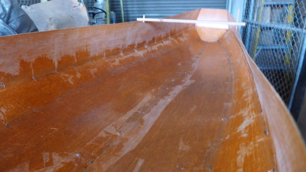

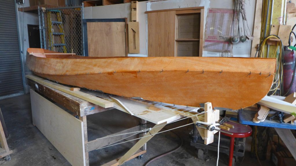

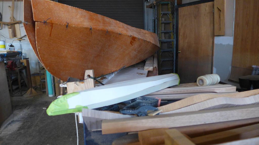

Not to be too Off Topic ( not the first time eh ? ) I just got some pics from my friend who’s building the yak with that phenolic sheet material we mentioned a while back … pretty tough stuff … Boat coming along nicely …
Possible trailer tough skin material for over Foam … (SIPS) :thinking:
