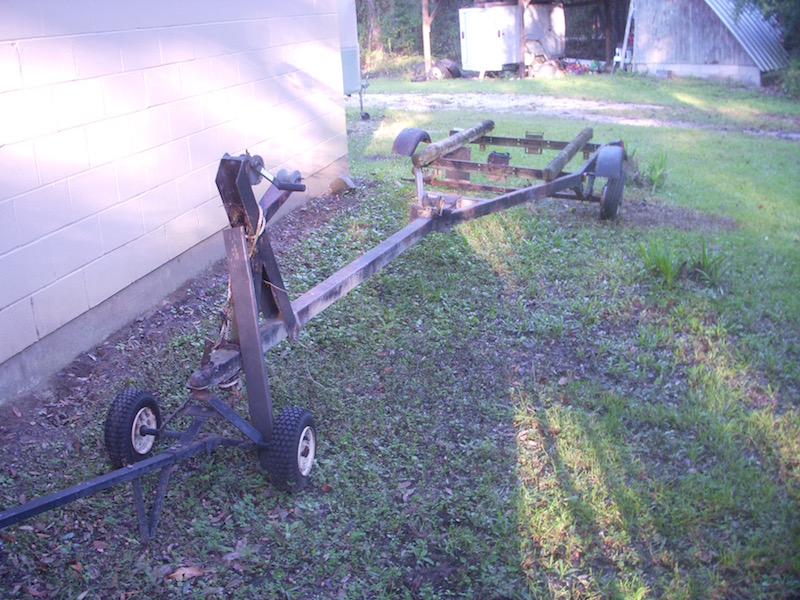

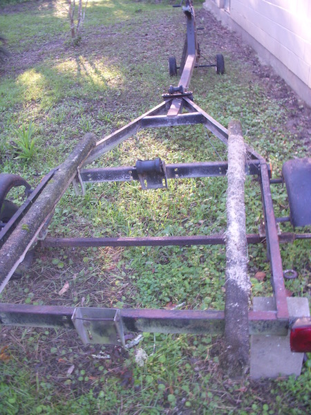

Part of getting the FoamStream ready , aside from Storm avoidance, was also moving a small boat trailer out the yard to make room ( and make the wife happy ) … The boat trailer was left over when a friend came over and picked up the boat … The poor little trailer sat in the yard , got buried in the weeds and eventually one wheel got buried in the mud with predictable results …. Half the wheel rim Rotted Away ( gone ! ) :shock:

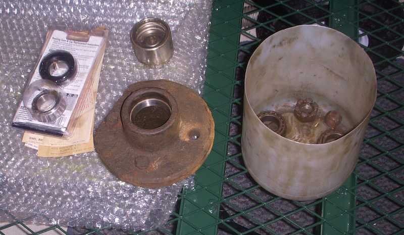

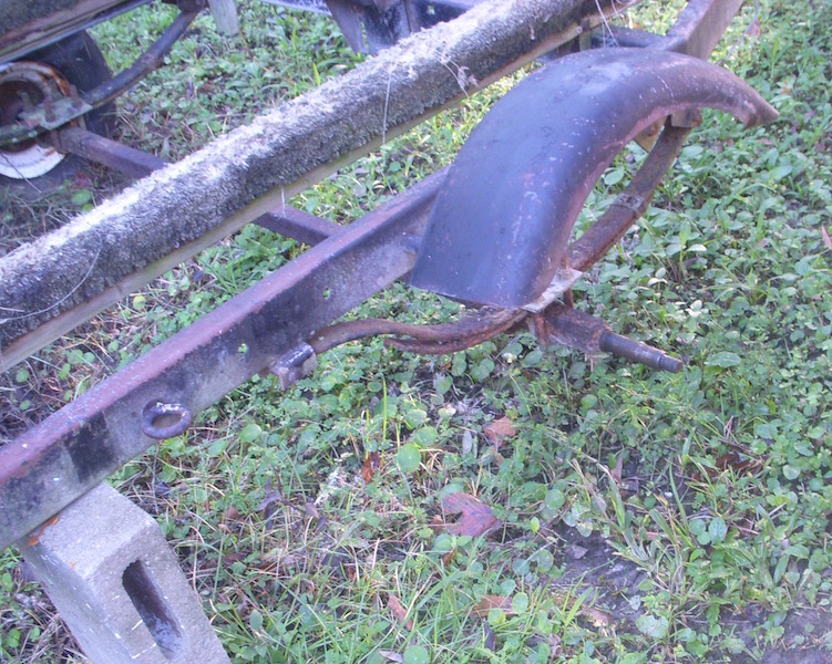

So we dragged it out of the weeds , cleaned it up a bit and then fought to get the rim removed from the hub … :x That was all OK , just filthy and some surface rust … So we cleaned it up a bit and got a lesson in changing bearings and bearing cups … Getting them out was fairly easy , but reinstalling the cups was a challenge . We didn’t have a tool or press for that so we got out the hammer and wood block ... :o That didn’t work so well , so in desperation , we took one of the old bearing cups and ground down the outside surface till it became a slightly loose fit , flipped it over and used that and the Hammer and block to seat them … That worked fine …We hung the tool on a nail for “future use” ;)
I was surprised how inexpensive the bearing kit was ( $13.00 tax included …) Something learned every day !!! And soon we’ll have a perfectly usable trailer ... :D Never enough trailers eh … We’re down to only 4 in the yard now … :R The wife is still suspect of my motives … although I promised to sell the trailer or donate it to someone in need. I don’t know if we can be Happy with only three trailers … :NC

Apologies , I was in a big rush and didn’t have time , but here’s the pics ...

Now , curiously , a friend in MS expressed he may want the trailer , but he didn’t want me to paint it up nice , wanting to avoid attention … So looks like we'll be getting it in good mechanical shape and not worry about the rest …. a “Rat“ Trailer ...

Hope y'all work in a way to take advantage of that launch tongue, tons of length there.

John , it’s really not much of a trailer ( could use more bracing IMHO ) but it’s got that really long tongue :R … Also has those little 10” tires on now , but there’s room for larger if needed … I originally wanted to convert it to a kayak trailer … kayaks are long and light , probably could fit several on this one with some kind of rack …
Or it may be perfect for a small travel trailer … The square part is 48” X 48” , the triangle is 48” long and that tongue goes on another 8' feet … to the coupler … could be a small 48” wide travel trailer … or hauling wood or stuff ( foam ) from the store as is … :thinking:
A Trailer is a terrible thing to waste !!! :D
