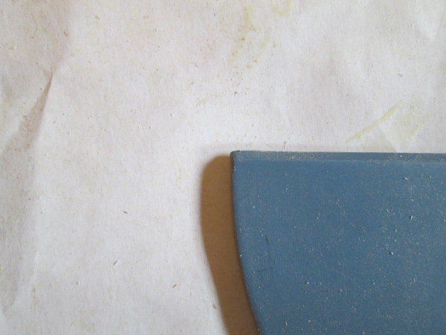

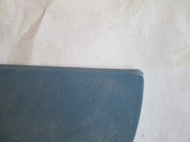

I won’t bore you with pictures of spackle going down, but I do have a pointer. This is the sharp (…ish) corner of my plastic putty knife.
Since I can be a bit clumsy with my technique, every once in a while I will tip the knife as I lift off or as I approach the surface and the corner of the knife can dig into the smooth spackle or even gouge the adjacent foam. So I take some fine paper on the small oak block and sand a little radius into the corners of the knife like this.
It doesn’t totally solve the problem (me), but it does seem to reduce the number of occurrences.

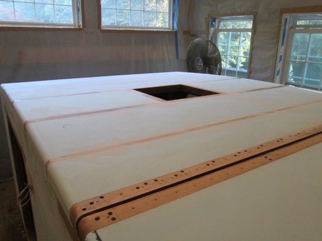

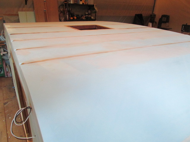

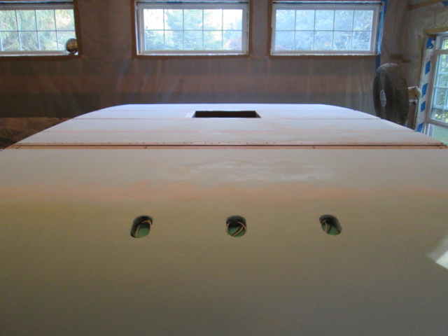

Not sure if these pics show the differences well enough between before and now, but this is after: filling the little gaps between spars and foam; building up the areas at the corners of the roof vent; building up the largish low areas in front of the first spar, and between the second and third spars; hatch seams and license plate recess work; various other dings, dents and along portions of the roof edges (all last night); and then sanding it all back down this evening. I still have to do the largish area at the top middle of the hatch, but I had run out of spackle and just concentrated on sanding tonight.
I went thru a whole tub of spackle, but like Karl says, most of it ends up on the floor. The roof vent corners seemed to come out fine with just a little touch-up needed.
Tomorrow will be round 2 of major roof spackle and perhaps get back to rounding the profile edge over.

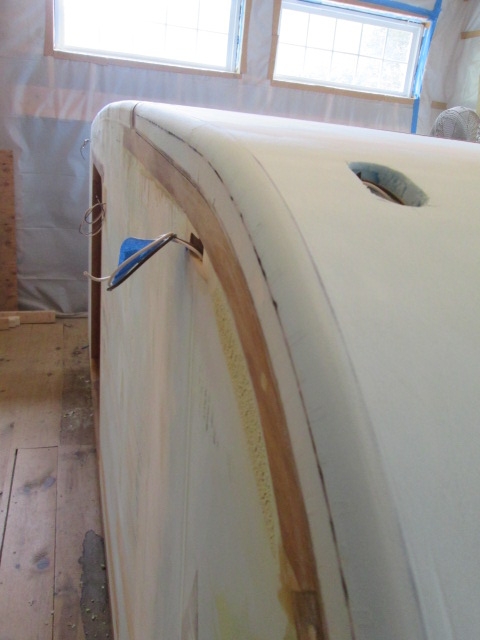

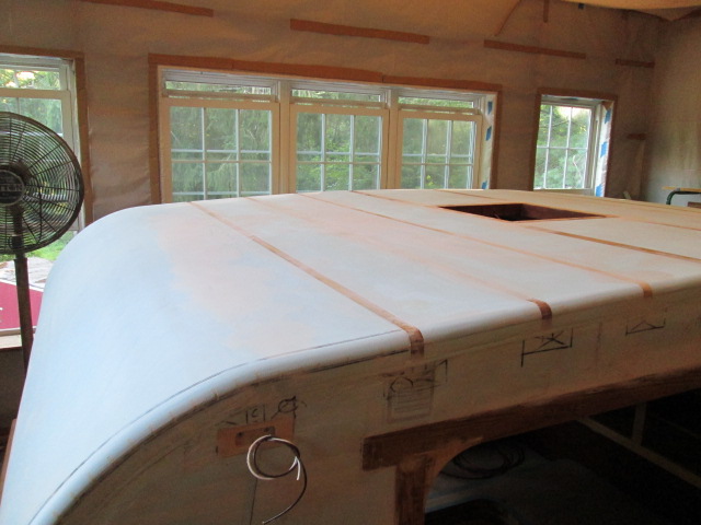

We had great weather today and it was a good day to be building. I did a little more block sanding on the roof and hatch spackle; I could see better in the light of day.

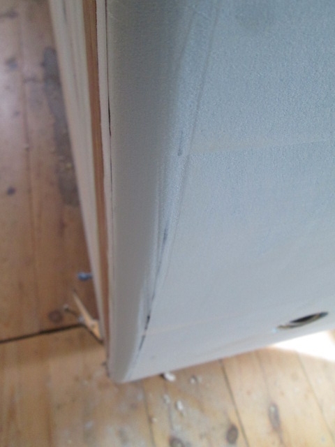

Finished rounding over the street side hatch edge.
I got a little sloppy getting out of position and ended up with some gouges; either from turning the block out at the end of the stroke due to over extending, or just from digging the edge of the block in. Sloppy.

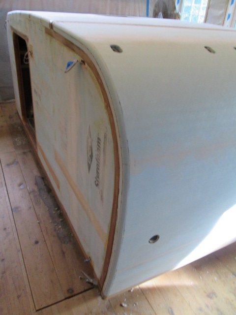

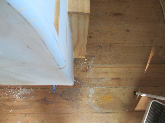

Moving on, rounded over the curb side profile edge. This pic is a bit of a cheat. By holding the camera just far enough off line you can’t see the very noticeable bow in at the top of the wall just ahead of the galley wall edge piece. I made the roof spar shorter here to match the wall, but am now wishing that I had left the spar to plan; it would have been easier to build the wall out to match the spar than it will be to deal with now. We’ll see if I bother trying to fix it, but for now just don’t look straight down this wall.

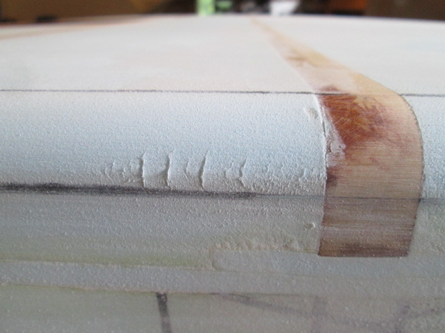

Here’s an example of the tearing that sometimes occurs from sanding back and forth, rather than stroking in one direction.

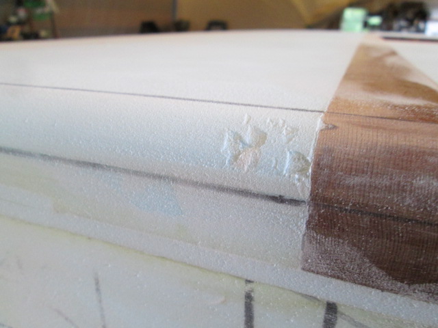

Here is an example of how the coarser paper (on the medium length board used for quickly roughing the edge down) can pull chunks of the foam out. This is after finishing with the round over block, showing how the divots from the chunks were deeper than the final target depth.

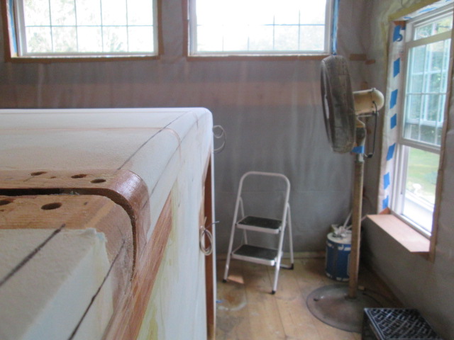

Worked forward and on down the curb side front. Looking down from above you might be able to see how the piece under the front sparette bows outward some, but this will be behind the rock guard so, no biggie. Maybe I will make another long board, a flat one, to knock this down so that the rock guard fit goes nicely.

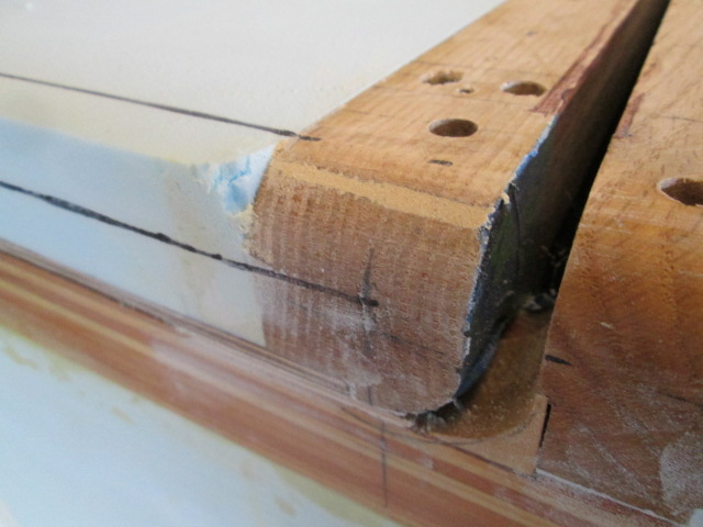

Remember this little nugget of goodness? When I glued up the hinge spar blanks, in order to pin and help clamp the pieces together, I used big deck screws into the ends that were supposed to be in the cut off area. Turns out one of these screws was too close and ended up landing half onto the rounded over end. Finally got around to filling it with wood filler; shown here after sanding it back fair.
After sanding the street side hatch edge I think I like the kerfs stuffed with foam better than the spackle blend. They sanded very even with the base foam. The spackle blend did okay, and was definitely quicker to apply, but didn’t sand as smoothly. Probably good enough, just not the same. So tomorrow the plan is to stuff the last of the kerfs on the curb side of the hatch and finish rounding over that last corner. Might get back into what I hope will be the final round of spackle, too.
