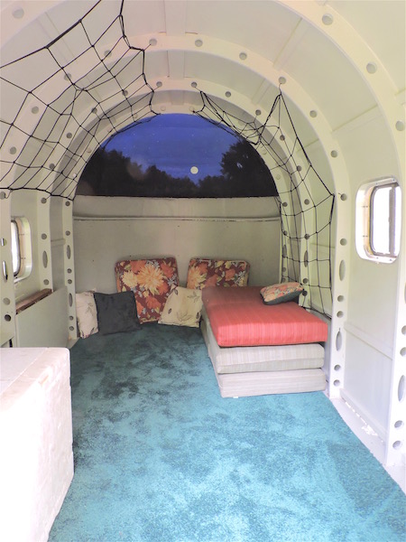

Now then the final check was to hook it up to the TV and see if the lights worked … Some did , some didn’t … First off we found some broken wire … looks like they got nipped by the fold down front wheel jack … :o So we got out the heat shring and wire strippers and fixed that … Still didn’t work ... :shock:
Now then , I must explain , when we bought that Jayco POS , the dealer installed a round 7 pin socket on my truck , so now I’m forced to use an adaptor which can be problems … My problem, was corrosion , I had to get out the can of De-Oxit contact cleaner to get the plugs working … After a while of fiddling they all finally worked again … TG !!!
So we’re ready !!! … list made and checked off .. maintanance done … Fingedrs crossed !!!

Re: FoamStream...
Postby John61CT » Thu Jun 27, 2019 7:03 am
how lovely! really gorgeous, inspiration man…
John61CT
Posts: 1958
Re: FoamStream...
Postby greygoos » Thu Jun 27, 2019 7:20 am
Looks great.

Postby zzzizxz » Thu Jun 27, 2019 9:43 am
Have to say, for a bug-out vehicle, that's quite luxurious! Looks amazing.

Re: FoamStream...
Postby GPW » Fri Jun 28, 2019 6:01 am
Thanks guys , this was the best idea I could come up with at the time … as you know from my gallery , I did a LOT of drawings and thinking … Six years now living Outside as a test , and the recent floor replacement was a good lesson to learn and we expect no more floor problems ( not in my lifetime anyway) … “ It’s all been a Giant learning experience for me … Fun too and in this trailer is incorporated a little bit of everybody else that helped … THANKS !!! :D :thumbsup:
And naturally the Wife is Happy and finally has “peace of mind” regarding Hurricane EVAC, which can be Traumatic , or just an unplanned camping trip ... :thinking:
Luxurious ??? This is what the Wife expected …. hahahaha :lol:
