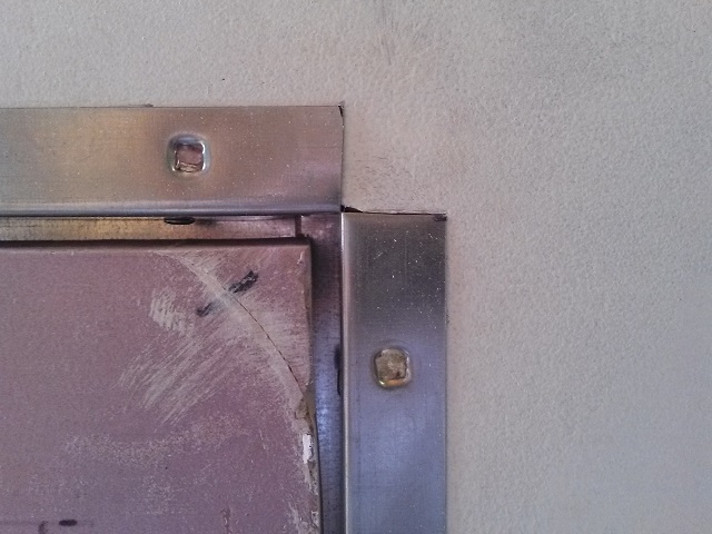

I have used the Fast and Final for most of my spackle needs on my build. I like it! I made mistake of applying some one time and then neglected to sand it till two weeks later, it was hard as a rock. :roll:
I found on my build that I was having a hard time seeing how much of the foam I was removing when sanding. I finally painted the whole trailer with Gripper. The Gripper will not sand easily, in fact I have not sanded through it except on edges. Knowing that I can not easily sand into the Gripper I can sand and fair out the fast and final quick and easily. I can even run the sanding block on the Gripper as a guide without fear of sanding into the foam. I am using 600 grit wet/dry blocks I picked up from Harbor Freight.
Also, once I get a coat of fast and final faired out as best I can I will put a coat of Gripper over it before adding more Fast and Final. This makes the last sanding of fast and Final a guide for the next coat of Fast and Final. Also, in theory, I think it makes for a stronger layer with Gripper and Fast and Final laminated.
Here is a example of fast and final laminated with Gripper.
This is how it looks before I started.

flashing
CAM00632 s.jpg (100.22 KiB) Viewed 1755 times
You can barely see the flashing in this shot. I am ready for a coat of Gripper.

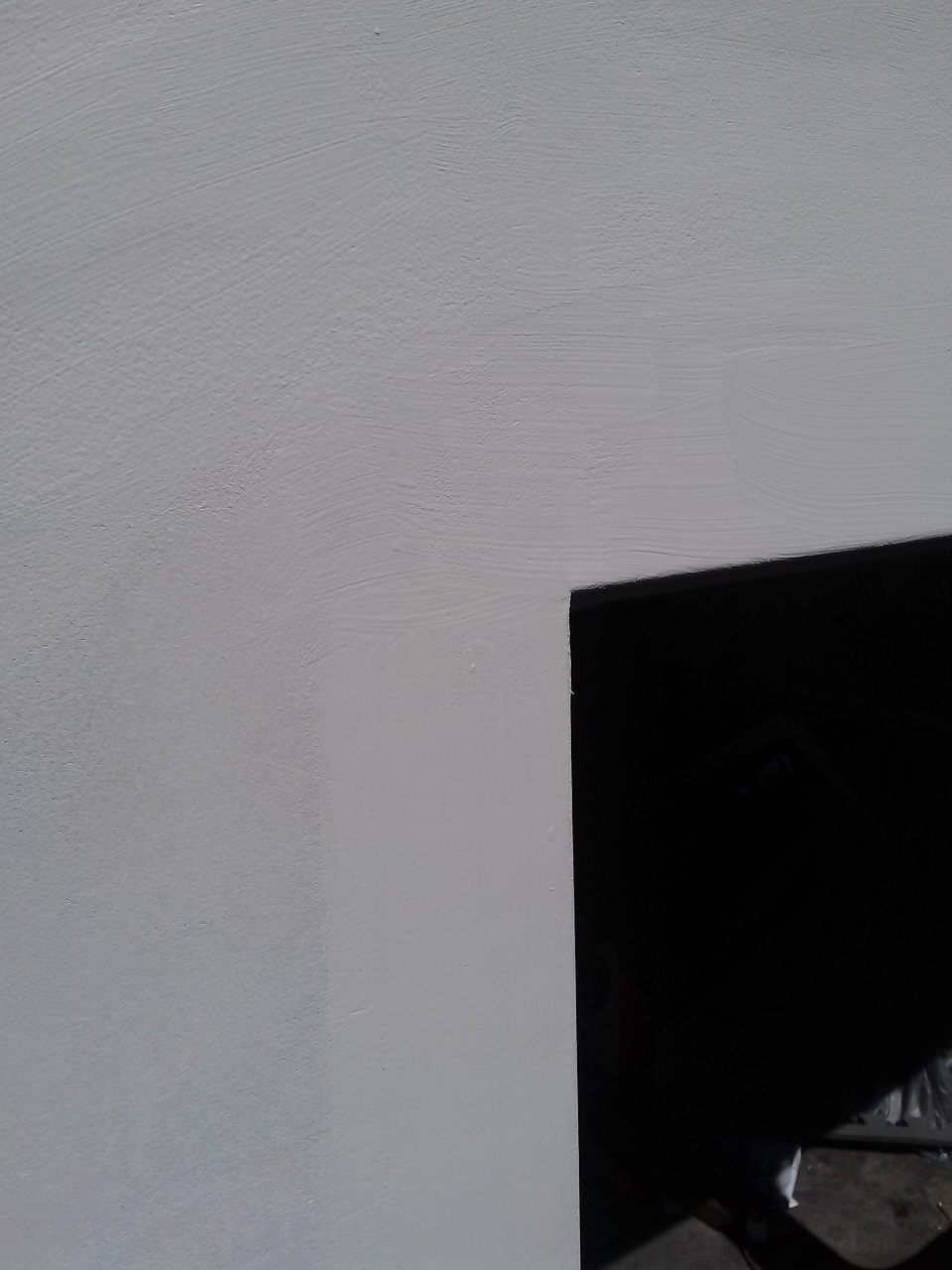

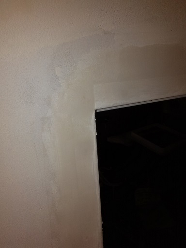

Fairing
This is the finished fairing out of the door frame. The waves you see is gripper. I just left the waves there, too hard to sand out. Once the canvas was applied you could not see those small waves. Also, I might add there is no Fast and Final covering the flashing just Gripper. The flashing just blended into the wall.
Finished
