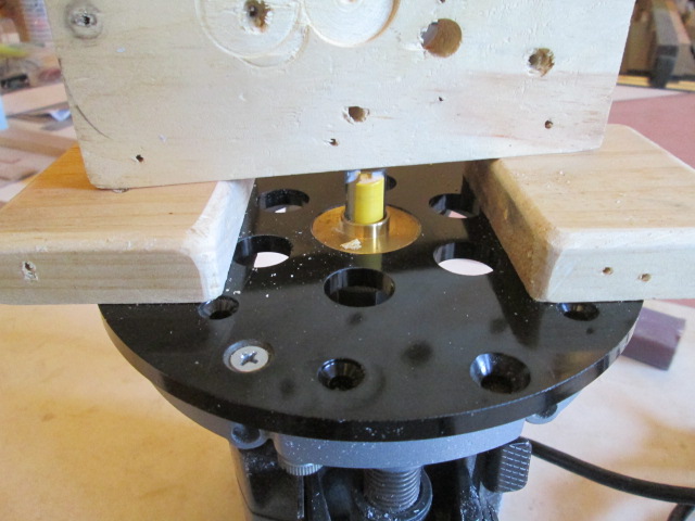

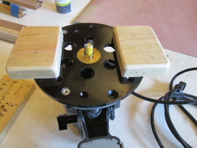

Tonight I made a couple of spacer blocks out of scrap pine to turn the plunge router into a flush cutting end mill. Just used the small Surform rasp and hand block to knock the corners off of the blocks so they wouldn’t dig into the foam. Double back taped them to the foot of the router making sure to leave enough space to span the guard blocking.
Simple to set the cutter flush using a straight edge (scrap block).
A few passes sliding back and forth, a little brush with the small sanding block, and everything is nice and flush.

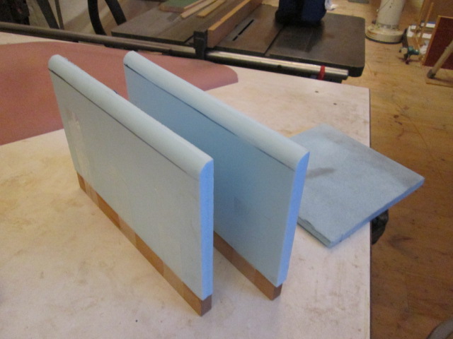

In the meantime I started making up a couple of test blanks to help me decide which way to go on covering. On one edge I sanded a 3/4 radius to simulate the roof edge, and on the other I glued on a 1x2 piece of cedar. The cedar will get an 1/8 inch round over to simulate the door openings and hatch seal areas. I will also distress them some, apply some spackle and sand it fair to simulate my typical construction. Shown here with packing tape holding the cedar edges glued up with TB2 because it was easiest (hope it holds okay, should get plenty of air to cure in this configuration).
I’ll probably cut these in half and do at least four variations:
(A) Two plies 6 oz BID. I’m thinking 45 deg bias strips on the edges to aid wrapping, but no bias on the flat because in full scale I’d rather just roll out cloth along the trailer axis, rather than cut a bunch of overlapping bias pieces.
(B) Canvas applied over epoxy, wetted with same, no bias. May try laying part dry and wetting with squeegee.
(C) Canvas applied with TB2, wetted with epoxy, no bias.
(D) Canvas applied with TB2, wetted with latex paint, no bias.
I have a bunch of FG tape left over from another project, but it is not bias, so I’m not sure about using it, but it may be useful.

Quick update (with pics to follow in a later episode), I rounded over the cedar on the test samples, distressed the surfaces (one clamp dent, one ding with torn edge, and a shallow sanded depression with some intentional tear out at one end... all to one side of each sample), and filled with spackle. Not an exact representation (no "mix" on the cedar and no guide coat of primer), but should at least give me an idea of what I'm dealing with and has already given me more experience laying out and cutting cloth and bias strips.
While discussing options and techniques with Karl, he grabbed one of my test sheet plies and hung it over the roof edge dry. It did just fine at 90 deg over the 3/4 radius. Then he laid it on one of the test samples to see about the 1/8 inch radius... before I could remind him that the panels had wet spackle on them. Oops. No big deal to cut another piece of cloth, and the spackle didn't get messed up to badly.
