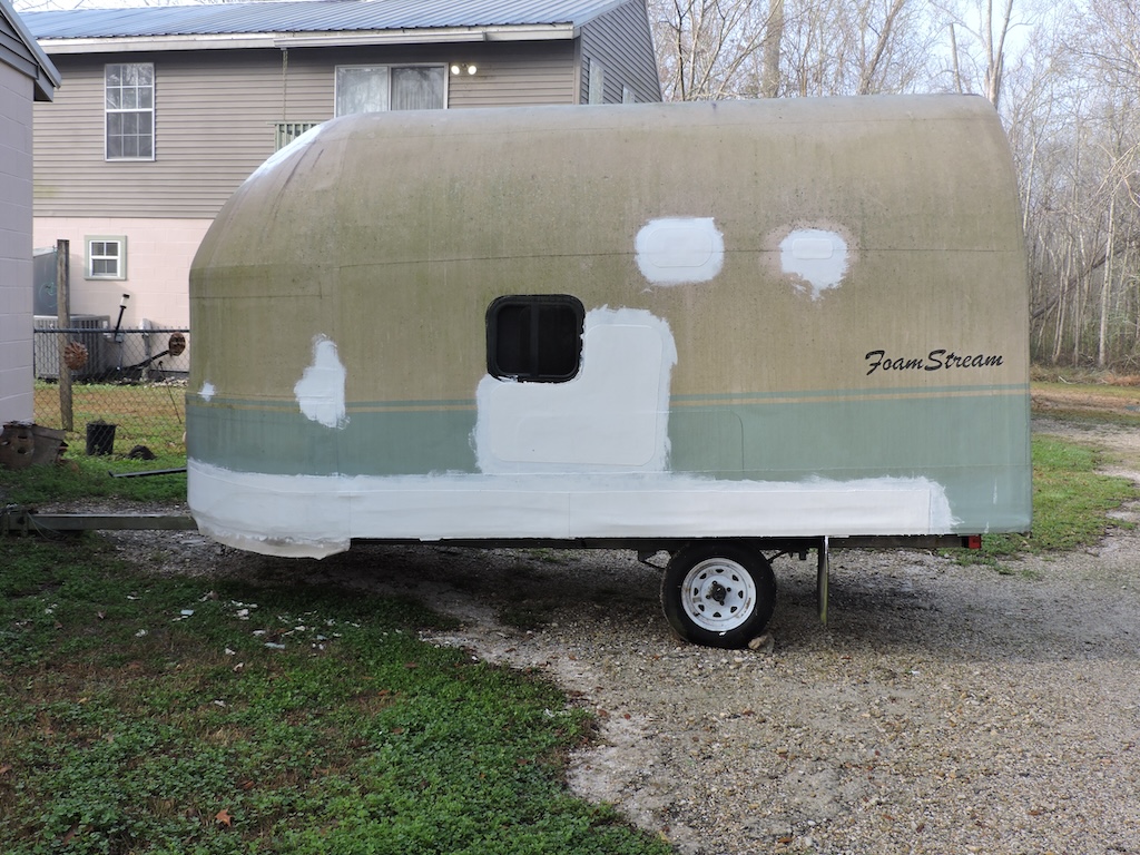

Postby GPW » Sun Feb 11, 2024 7:07 am
Finally proceeding with the FoamStream restoration ... First off we have some patching to do ... Little places that were somehow holding moisture in the canvas rotted over the years and allowed water to enter the front interior ... I can only blame myself . So we're going to do the right thing and instead of stripping all the canvas off and redoing it , we're just going to patch it up . Remove what we must and replace what needs ... Mostly the patched holes, and the bottom drip edge , which will require removal of the old outer canvas edge and replaced with new "Treated" canvas ( the Mix ) , solving another long term problem ... Turns out the drip edge as we have it is wetted every day ( our humidity) and any untreated fiber will retain water... and rot eventually . :o Other than that the drip edges have functioned perfectly protecting the floor ... :thumbsup: We used George's idea of sheetrock edging strips and that worked Great !!! ( Thanks George !!! 8) ) ... Just enough to do the job . Attached to the floor bottom with stainless steel staples... No problem..
That's the first stage , starting today .

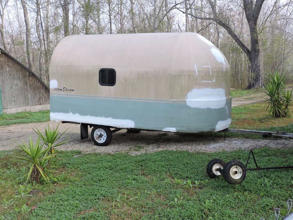

Re: FoamStream...
Postby GPW » Wed Feb 21, 2024 3:58 pm
Patching complete ... Anything suspect was cut out and patched... It's not pretty , but cleaned up and painted with an entirely new paint colors and scheme, it'll do ... :thumbsup:
Re: FoamStream...
Postby GPW » Wed Feb 21, 2024 4:05 pm
Got Nasty quickly sitting under the trees :o ... It'll clean up ... I have a brush on a stick ... :D
