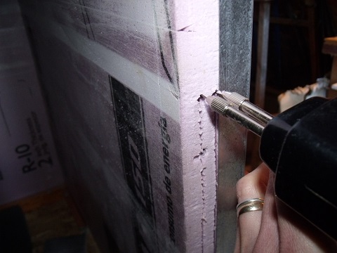

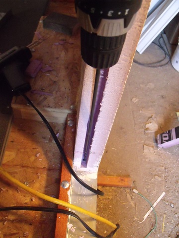

Weather has actually been pretty good here the last few weeks. I did manage to get out and spend some time with the foamie. I have most of the electrical here now so I decided to do some electrical work. First is the wiring for the inside switch. I made a hot wire and plugged it into my soldering gun and started to cut a channel from the floor up to the switch location and then up towards the roof.
Hot wire
DSCF3388 s.jpg (88.73 KiB) Viewed 2335 times
Cutting the wire groove
DSCF3384 s.jpg (79.61 KiB) Viewed 2335 times
Grove cut
DSCF3389 s.jpg (111.28 KiB) Viewed 2335 times

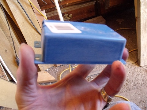

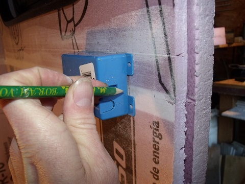

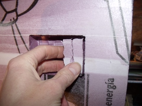

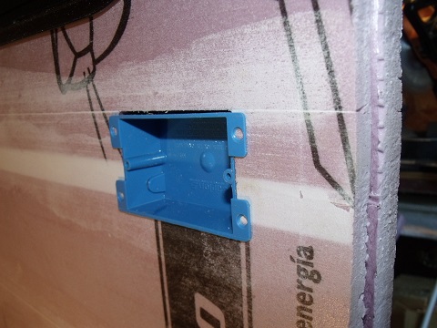

Next was to install the switch box. I will be using a low profile switch box for the switch location and it will also be my hard spot to mount the switch and plate. First I marked out where I wanted the switch to be.
Marking out the switch location

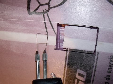

I used the regular soldering gun tip to do the cut out (not pictured). Then I made another hot wire, a square shape to cut the back portion of the box.
Square shape
Removing the pieces
George.
ghcoe
Posts: 1982
Location: SW Idaho
Re: #1
Postby ghcoe » Wed Mar 04, 2015 10:19 pm

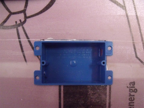

Looks like a perfect fit. Now to drill a hole for the wires to get form the groove to the switch box.
Test fit
Large drill took care of this.
Wire route
Wire route to switch box. :thumbsup:

Postby ghcoe » Wed Mar 04, 2015 10:27 pm

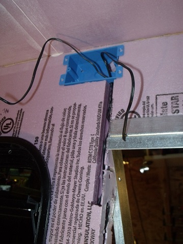

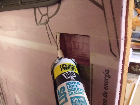

So to make the switch box permanent I decided to use caulk. Been experimenting a bit with it as a glue for foam and it seems to work pretty good. So I caulked around just the inside edges and the back portion of the box cut out.
Applying caulk
I sanded the sides and the back of the electrical box to allow a little more grip for the caulk to attach to.
Sanded
Then I just slid the electrical box in and pressed against all four sides to make sure I had good caulk contact.
Installed

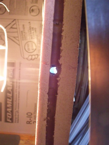

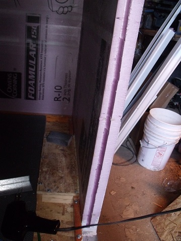

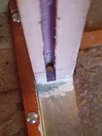

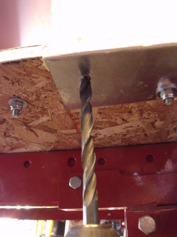

Next was the drilling of the floor for the wires to come through. I did not cut the foam all the way to the floor to allow some water protection. I took a long drill bit and drilled in form the top down to make a pilot hole in the right location.
Drilling the floor
Once I got the pilot hole drilled from the top I was able to then use a larger diameter drill bit to finish the job from the bottom.
Larger drill
Ready for wire.... :thumbsup:
Finnished

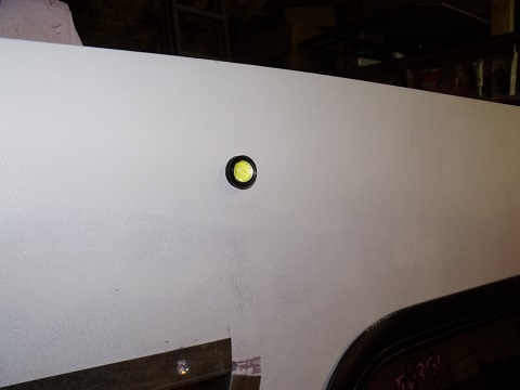

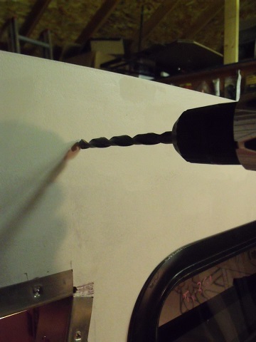

I was able to do some work out in the shop today while it rained outside. I finally got my last LED's in from China and now it was time to figure out how to install some. The first install was the left side porch light.
I will be installing the porch light 3 inches below the roof line. I will also be installing clearance lights which are the same style of light. Three inches allows the lights to be accessed from the other side of the wall with a little clearance to the inside roof line.
First I mark my location with the T square.
Marking the spot
Then I drill a 3/8 hole.
Drilling the hole
And then the test fit. Looks pretty good..... :thumbsup:
Test fit
George.

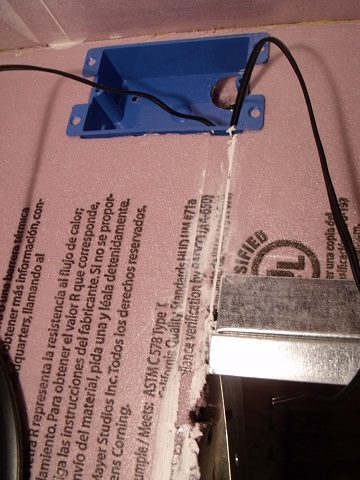

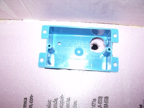

Postby ghcoe » Sat Mar 14, 2015 8:36 pm

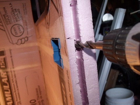

On the inside I installed another box. This box will be the connection box for the porch light and the interior lights. I drilled a hole for access to the porch light from behind. A washer and a nut will go in behind the porch light to hold it in. I also drilled a hole in the now bottom of the box so I can finish cutting the wiring channel to the box.
Box
Wiring grove is now cut and wires are installed.
Wiring groove and wires
Now to repair the wire groove that will be exposed above the door. I just used some white latex caulk to glue the channel piece back into position. Before I glued it in I did cut off some of the back to allow for the wires behind it.
Grove repaired
George.
