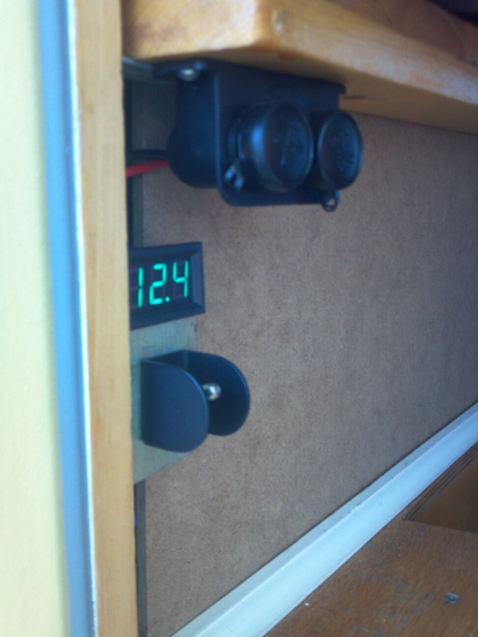

I was worried that my circuitry was too simple, so I added a voltmeter to monitor the 12v system. :lol:
There are 3 different ways to power my 12v devices,
1. a built in 12v power supply (115v)
2. tow vehicle power
3. a small 12v battery.
My buddy gave me the meter, it came from eBay and cost about $1.50

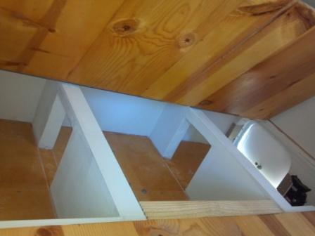

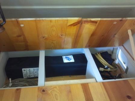

The Big was getting a little heavy, so I thought I better remove some foam.
Just kidding... not having easy access to the back storage compartments has always bugged me.
Having solved one side with the addition of the access door, I decided to cut some holes through the interior bed supports to house the canopy.
While there is still some hard to access space on the curb side, I now have easy access to store the canopy, extension cord, jack stands, and other stuff in the back now. :)

Just a thought .... when cutting access holes like above , remember the arch , which is a Stronger hole .... :thinking:
Re: The Big Pink ... storing stuff
Postby tac422 » Thu Aug 13, 2015 6:51 pm
Alas, no room for an arch.... the hole is just big enough to slide the popup tent through.

Tac, I was really meaning just round the corners , square intersecting corners build stress risers at that point ... Rounding the corners spreads the load out ...
I’m just trying to use every trick in the book to assure everybody has Maximum strength constructions... :thinking:
