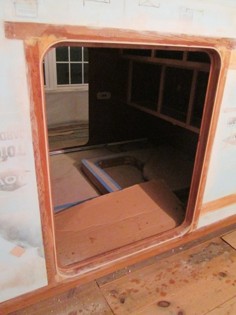

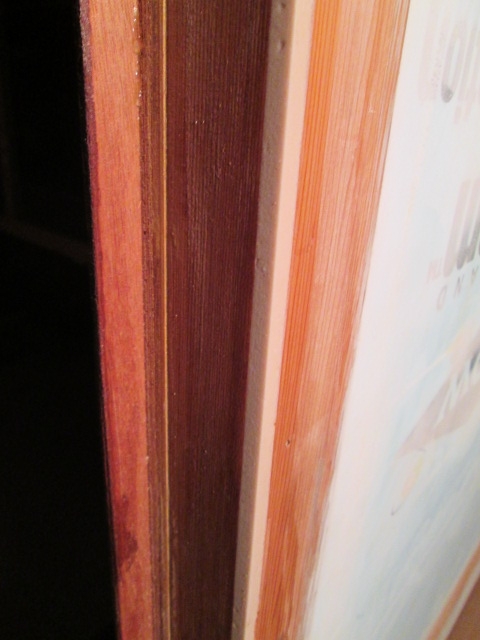

Turned cold again today with flurries thru most of it. Too cold to do any epoxy work, but yesterday’s filler had set up fine before it got too cold.
Popped the filer dams off the street side door frame; scraped the little flashy bits and some of the overburden; greenie washed to remove any remaining amine; then sanded to clean and fair. There are a few spots that need a little touch up filler, but for the most part I am very happy with the result.

Postby OP827 » Tue Jan 05, 2016 2:38 am
Looks perfect!

Postby dales133 » Tue Jan 05, 2016 2:45 am
OP827 wrote:Looks perfect!
Ill second that

Postby Atomic77 » Tue Jan 05, 2016 8:18 am
That looks outstanding

Postby GPW » Tue Jan 05, 2016 9:01 am
Like fine Furniture !!! :thumbsup: 8)

Postby KCStudly » Tue Jan 05, 2016 6:08 pm
Thanks guys! I really do appreciate the kind words and positive feedback. :) :thumbsup:
