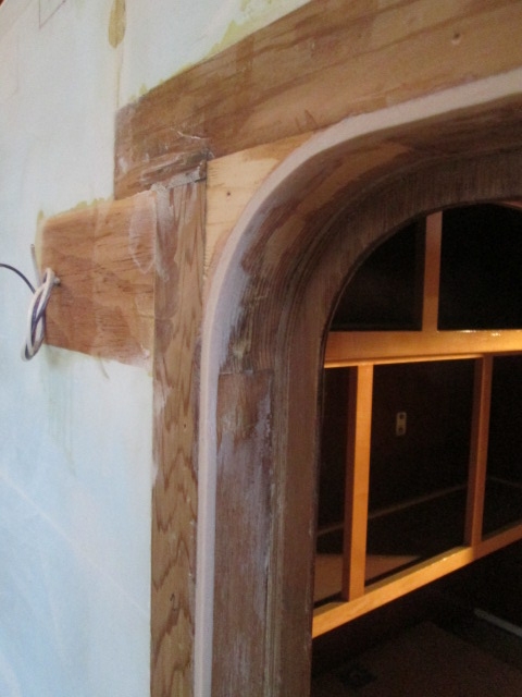

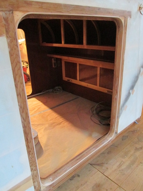

Thursday was cold and I was tired so I took the day off from the build. Yesterday was warm enough and the overnight temps weren’t going to be crazy low, so I went ahead and filled the curb side door frame corner.
Before adding the fillers I used some of the neat epoxy and painted it on part of the area to be filled; and on a couple of areas on the street side corner that needed a little touchup. While the mix was sitting in the cup it started to warm a bit, which, according to the West System literature, is good to do for cold weather usage. Apparently it insures that the chemical reaction, or rather the exothermic reaction needed for the cure has started before you spread it too thin for that to happen.
Once I added the fillers it seemed a little loose still, but I have been trying to dial in just how much filler to add for easy spreading while still being stiff enough to hold without slumping out, so I went ahead and loaded it into the zip bag anyway. I thought it would be better for the touchup work needed on the street side if it was a little looser, but once it is in the bag there would be no easy way to add more filler.
It did okay despite the slightly loose mix. I did have a little slumping here and there and it seemed to spread “outside the lines” more readily, but it held onto the header without dripping out, so I was happy. I used the leftovers to touchup the street side and fill in the screw holes there.

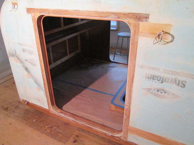

Today the street side just needed a little clean up sanding. The close up shots don’t show the difference, so here is an overall for a little perspective.
On the curb side, because of the small areas that had slumped, and the excess that smeared around on the jambs, I had a lot more work sanding it back to fair again; had to break out the medium sized boards and the coarser grits. Used the little football shaped block in the corners again.
The area where I had painted the wet epoxy on didn't seem any different than where I hadn't; in fact there was a little more suck out and it was one of the areas that had slumped a bit, so with the relatively wet mix, I don't think there was any benefit.

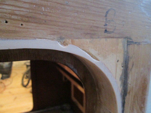

Here’s a spot that didn’t get fully packed that I will have to add a little to on the touchup pass. I dug this out with the utility knife to make sure the gloss was broken to insure a good bond for the next bit.
I spent some extra time scuffing out the gloss from all of the little low spots, and I probably should have stayed another hour or two to do the touchup fill; but I decided to let that wait for now.
