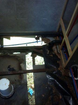

Postby tac422 » Tue Sep 01, 2015 12:32 pm
The Big Pink has a "new" stable mate.
I picked it up real cheap because ..... :(
The floor has completely rotted away in the front of the trailer. :shock:
Everything else is in great shape ( except where the PO got a little carried away taking the old floor out.)
So I'm going to try and replace the floor, and find the leak (s). The original floor is OSB, and was sealed with linoleum on top and sheet plastic on the bottom, trapping any moisture. I'm hopeful the linoleum acted as a barrier and kept the moisture from wicking into the walls.
here's the before and after pix... That's the shower drain in the after picture.
floor rot1a.jpg (24.1 KiB) Viewed 2389 times
I would welcome advice on how to replace the floor under the walls, and what to use to seal the roof . Once I find the leaks (s).

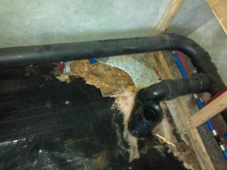

Postby tac422 » Tue Sep 01, 2015 7:04 pm
The good news is that it didn't get into the walls. :) The bad news is It was worse than I initially thought. :( The dealer he bought it from ( a couple of years ago) had just added new OSB and linoleum over parts of the rotted original floor. There was 1" pink insulation under the original OSB and it was dripping water. (sealed in by the plastic ) The front 4-6 feet of floor is completely gone.
floor rot4a.jpg (20.6 KiB) Viewed 2357 times
I'm wondering what to replace it with ... Pressure treated Plywood ?
Maybe this stuff ...http://www.lowes.com/pd_85795-1169-S-16 ... =advantech
or sheathing using the "mix" ?

Postby wagondude » Tue Sep 01, 2015 7:40 pm
Nothing like a quick, bad repair job to cover up bad initial construction. Surely done to flip a trade in. I'm guessing the leak was around the shower pan.

Postby GPW » Wed Sep 02, 2015 5:59 am
“ The dealer he bought it from ( a couple of years ago) had just added new OSB and linoleum over parts of the rotted original floor. “ Therein lies the problem :roll: .... the dealers use the same Crap materials to fix the trailers so it rots again just as fast ... :duh: Also they use that same caulk that doesn’t seem to last very long despite all the wild claims ... :thumbdown:
I’d go back with the best grade of flooring OSB and use the mix which we KNOW works .... and then store the whole thing INSIDE ... :o

If it is like the one I rebuilt, it was built from the floor up and the inside out so you have to tear it completely down from the outside in. Not a small job and you will probably be surprised how much rot it has especially if the leak was from the roof. Replace the fiberglass insulation with white foam so it won't hold water against the wood when it leaks again. I put a welded pvc roof on mine but it still leaked finally found it was leaking through the clearance lights but not before it warped the new paneling inside.

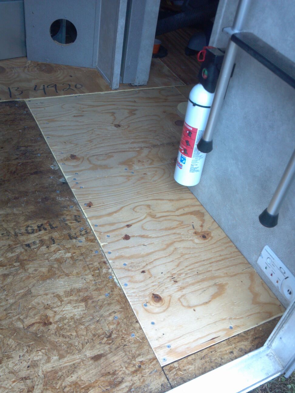

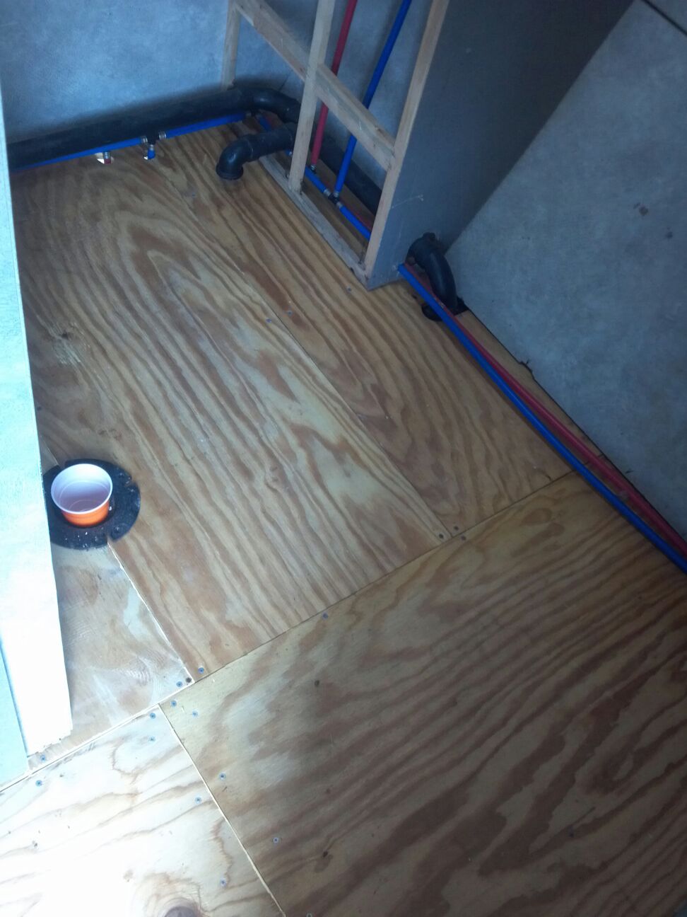

Postby tac422 » Wed Nov 11, 2015 9:34 am
As expected , the floor was worse than initially thought.
The water fittings under the kitchen sink were not even finger tight, and inaccessible behind a sealed factory panel.The entire front 7+ feet of the trailer was completely rotted out plus the area under the kitchen sink.
I used exterior 3/4" plywood sealed with "the mix" on all sides, and then painted on the bottom with leftover Big Pink yellow porch and floor oil based paint.
It was a challenge figuring out to remove the old floor and piece the new floor together while leaving the walls in place.
I treated all the metal (frame , tank supports , etc) with Ospho and painted with rustoleom before putting the new wood in.
It doesn't look like there is enough room for the shower trap, since I didn't remove that part I don't know if the floor was cut out to accommodate it.
In my limited plumbing experience years ago I used a "Richmond" trap or a flat trap. A quick search doesn't show any info.
new floor2.jpg (172.52 KiB) Viewed 1964 times
new floor1.jpg (127.21 KiB) Viewed 1964 times

Postby GPW » Wed Nov 11, 2015 4:16 pm
Tac , you already know what to do , so Good Luck Dude !!! :thumbsup: 8) :beer: That floor should last a lot longer now ... Did you treat the other floor that survived ? ... After several generous coats of the mix even the cheapest “oatmeal “ grade of particle board was waterproofed .. It was originally used to waterproof Corrugated cardboard (paper essentially ) ...
if you ever see a commercial trailer video , it looks like ants crawling over it trying to make it as fast as they can ... just bang them together quickly and send them to the dealers .... no wonder they don’t have a chance to at least tighten the plumbing , which is a cause for failure ... They can't bother coating the wood with a waterproofing of any type , there’s no time for that , and using something that would be already waterproof would be “unprofitable” ... and they brag how quick they can make one ... :roll:
Best look for any and all little places where water can get in ... and don’t use the caulk that the RV dealers recommend , it really didn’t last worth a hoot in our summer sun ... My dealer said it would have to be replaced once a year at a cost of $1200.00 ... (what a Ripoff!!) There are much better alternatives... Eternabond tape a good one , but don’t buy it at a Rv trailer dealer .... the roofing supply stores are cheaper , and have better stuff .. Best stay away from RV dealers all together , you can find most everything you need at a much better price elsewhere, especially online ...
