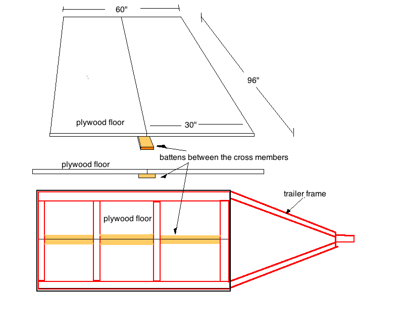

Eagle , you could attach the ply directly to the trailer frame , just depends on the size of the floor eh? ... and how the ply falls out ... What's your final dimension for the floor , I'll try to make a drawing for you...

i was trying to make my tear so that the inside size is a true 5'x8'
so i need to add framing to the outside of the frame to work this part out. plus i am building up and over the tire.
so my thinking was to get some wood and make the frame 3" all the way around [except for the tire area, where the wheel box will go]. then just lay the floor down on that. of course bolt it down.

Eagle, this was an idea , but you'd have to add the thickness of the sides to get a true 5' inside ... just make each half 32" wide ... :thinking: Image
You can see how well supported it is by the metal trailers cross members.. bolted directly ..
Postby eaglesdare » Fri Feb 18, 2011 12:32 pm
so the battens will go under the floor, but inbetween the cross members? am i reading that right? the ply is bolted "directly" to the cross members and sides, then then battens are attached under?

sorry i forgot my manners: thank you for the drawing! visuals are a good thing for me.

Yes , battens under the floor between the cross members , just a little added security ...
