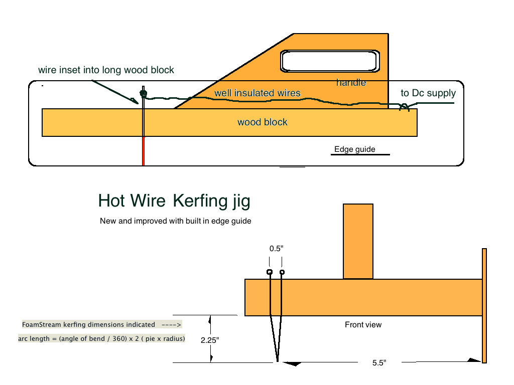

Did the calculating for the FS kerfing ... Finalized the dimensions of my kerf tool ... (10) 10’ long kerf cuts on each side ... May have to glue the 24” wide sheets together then do the kerfs , the top bend is 61” continuous ... Thinking of attaching the canvas first on the outside of the bend , then kerf and bend ... the canvas will keep it all together , and prevent any cracking ... probably easier to install one big piece ... all the messy work , pre done flat ...

If you canvas them first, I think you might have more trouble bending the panel(s) than you think. I guess a test would be appropriate before committing so much time and material.
My thinking is that if you limit the depth of the kerfs and leave some thickness the panels will hold together, handle and form fine (... but then again, maybe not with beaded foam?). If in doubt some packing or blue tape applied around the circumference of the arc in a few locations would be reasonably thrifty (come in handy for many build chores, too) and easily removed after forming. After forming (but before covering) any adjustments to fair would be far easier without the canvas in the way. Also, the joints where your back wall and front dome meet the semicircle will be much easier to fit, fair and reinforce with the main canvas out of the way.

KC , you’re right !!! Will re-consider the method ... Hmmm? Blue or Pink foam would have been easier , just difficult to find around here and pricy !!! ~ 45USD/sheet of 2” @ a local insulation supplier ... HD or L doesn’t carry it here ... and I can’t think why not ? :NC
This beadboard will work fine , being the same density as the Blu... there’s just a LOT of kerfing to do ... Being 3.5” thick , the kerfs will run deep or ~ 75% of the depth ... The bent area of the foam is 61” on each side (bent to 36” radius ) ... from the floor edge around the rib to the top center comes out to exactly 8’ ... which was not a coincidence ... It was planned all along to use the XPS 2” foam , that just didn’t happen ($) ... I really could use the 1” Blu foam over the wooden skeleton (no kerfing , just simple heat bending , and locally available ) and it would be good enough , just not offer the Insulation qualities we “need” here (HOT) ... The inner wooden ribs and stringers add quite a bit of strength to the structure , and in reality IS the structure , so this is a Hybrid foamie anyway... :R The foam adding a smaller percentage of strength to the overall structure than a “Pure" foamie ... Technically I could just cover the skeleton with the canvas and paint it like an old airplane fuselage , but then we’d have NO insulation , just a rolling tent ... :roll: Of course, that would never fly with “her worship” who is always too Hot or Too cold ... :oops:

Yeah, I think if you can get that hot wire rig set up your kerfing will go pretty easy. Make a fence with an indexing feature that drops down into one of the previous grooves and then just drop the fence into the next kerf, clamp and zip by pushing the cutter along the fence; reposition, clamp, and zip. You'll be done before you know it.

You’ll see in the drawing ^ the kerfing tool has a fence on the port side that rides in the previous groove ... :thumbsup:

Oops, I hadn't scrolled the drawing down. I see it now. That's a pretty good distance between kerfs; nice gentle curve.

KC , I hope so !!! Otherwise it will be a curve and a flat spot , repeating .... for that Zeppelin look ... :o which wouldn’t be so bad ... :thinking:
