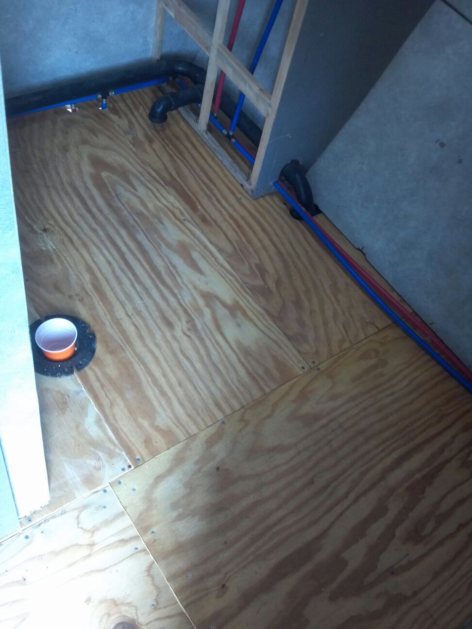

I did treat all the old exposed floor inside and I'm removing all the plastic and pink insulation underneath and intend to spray "the mix" with a pressure sprayer.
I haven't gotten much done recently, but did reinstall the water heater and furnace. I added a piece of scrap aluminum to the bottom of the very front so water can't get between the frame and the floor.
My next step is to reinstall the water pump, linoleum on the bathroom floor, and composite flooring in the kitchen.
I'll also be adding a drip edge along the bottom of the sides.
And then I have to rebuild the shower stall and bathroom vanity...

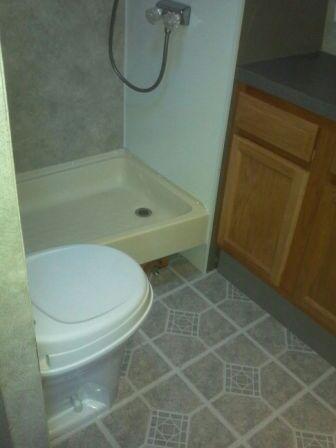

and almost done
tac422
Posts: 639
Re: The Big Pink
Postby KCStudly » Sun Apr 03, 2016 7:41 pm
What a transformation! :thumbsup:
Re: The Big Pink
Postby GPW » Mon Apr 04, 2016 6:23 am
Well Done !!! :applause:

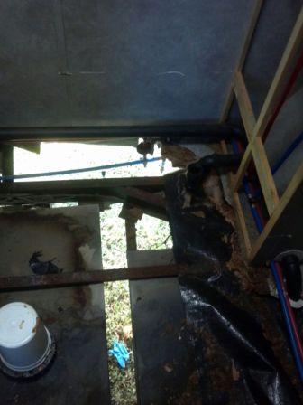

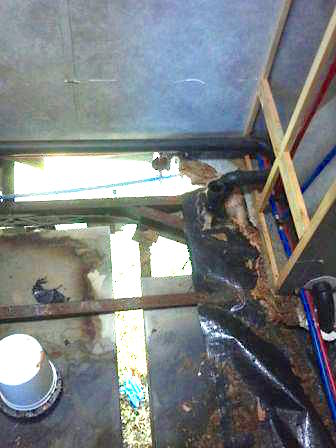

Tac , apologies , but I couldn’t help re-posting that floor damage pic .... that’s so TYPICAL of what happens ... ( picture enhanced for more detail and Horror ) :frightened:
Re: The Big Pink
Postby GPW » Mon Apr 04, 2016 6:39 am
You’ll notice the bottom “Membrane” which is a plastic sheet placed underneath so they don’t have to take the time and expense to properly undercoat the bottom . It takes them much less time to throw a plastic sheet down and build over that ... They don’t even glue it to the floor bottom ... :duh: .... we’ve actually seen many many cases where that plastic sheet HOLDS WATER and moisture in , sometimes like a big bubble underneath FULL of water :o ... certain to quickly ROT an untreated floor ... :thumbdown:
Re: The Big Pink
Postby tac422 » Mon Apr 04, 2016 3:00 pm
Doc,
Just to make sure the plastic held water they put 1" of spun fiberglass insulation between the floor and the plastic.
The insulation literally dripped water as I took it out.
