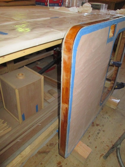

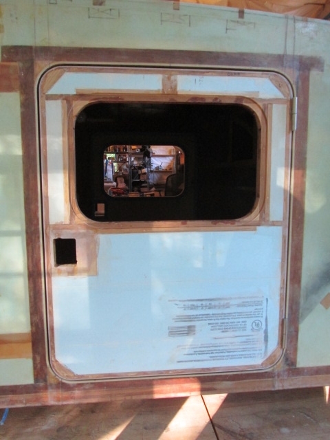

From earlier, the curb side door centered in its opening with the 1/16 thk SS shims.

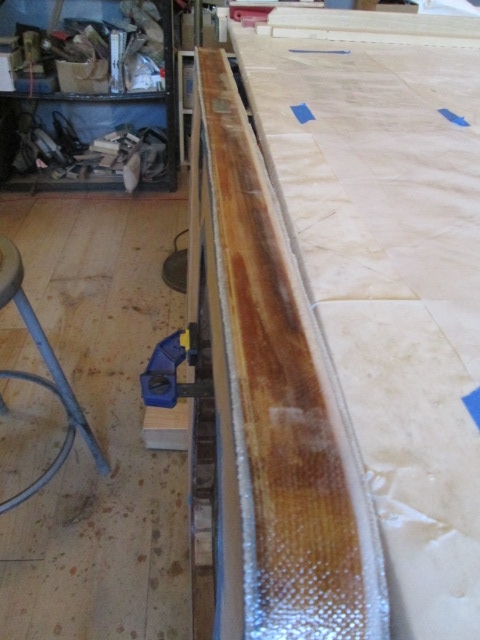

Last night I laid up the remaining two sides of the street side door edge. The creases in the glass tape took some persistence again, but I stuck with it for about 90 min until the slow hardener tacked enough to grab, and was able to push them down until they stayed.
The cloudy looking areas in the above pics are where I had put down some filler previously.

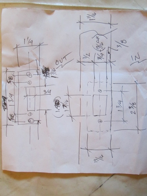

I spent some time measuring and drawing the bolt opening in the door edge with details of the TriMark paddle latches (on the right) to figure out the details of the latch plates that I will make (on the left). As far as sketches go it’s a bit of a mess, but this is part of the process and I don’t mind having it accessible here so that I can find it again later if need be.

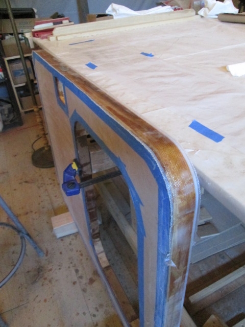

Today (Sunday) I cleaned up the glass layup on the top and latch side of the curb side door. Typical stuff: steak knife to saw off the excess flash; amine wash; 36 grit medium block to get the rough edge left by the steak knife close; the 60 grit on the small hand block to get real close; and then the 100 grit on the other medium block to make it fair. Next back to the 60 grit on the small block to flatten the ends of the lap seams and it is ready to glass the final, bottom, edge. (I didn’t end up getting to that today but will tomorrow.)
