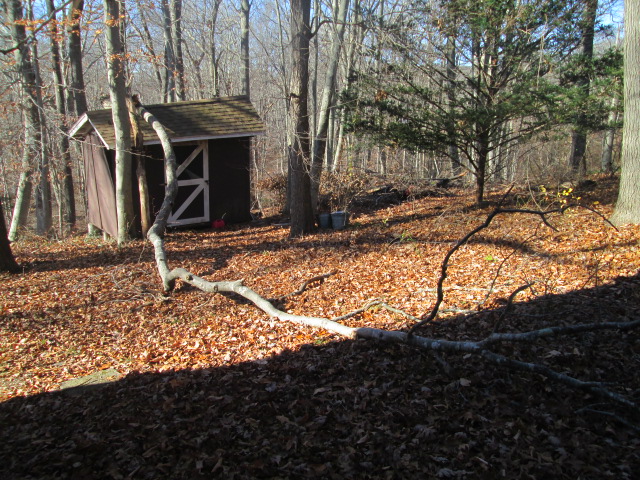

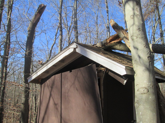

A tree fell on my garden/wood shed.
Flattened the salt box style roof and cracked it like an egg.
If you look at the rake board trim near the peak you can see how much it split open and flattened. Also note the side wall peeled open at the top front edge of the wall.

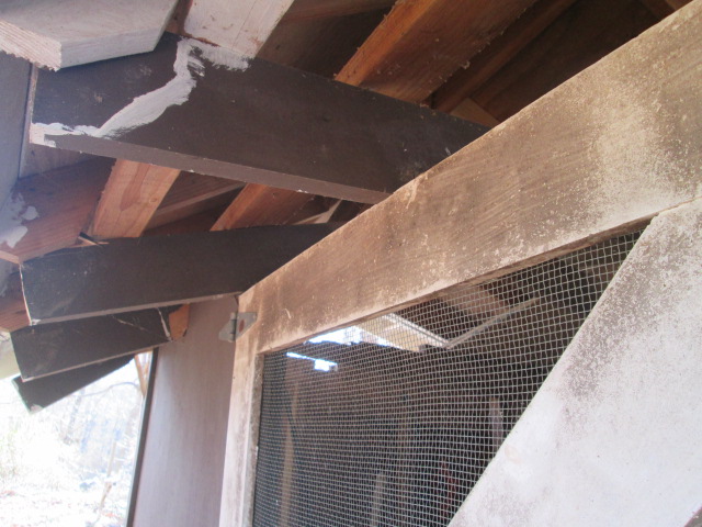

The original roof when we moved in was just a flat pitched roof. The 2x6 joists (dark brown in pics) had been notched on their tops with 2x’s laid down across wise to support the seams in the decking. The flat roof would collect leafs and sticks and eventually was rotted out by ice damming. So I ripped that off, leaving the joists, and built up the new ridge and salt box rafters, but I left the old joists.
So when the load came down pushing down on the tails of the joists, they heaved up and split at the notches. The backs of the joists also lifted up off of the wall cap and out of the notches in the wall sheathing. Each rafter, at least along the front, pried away from the ridge beam yanking most of the nails out. The joist along the blown out side wall cap turned to splinters.
The joist over the door is now resting on top of the door, and, as you can see, the rest of the joists are now pointing down like rafter tails.
Not sure yet if I can even get the door open to get my chainsaw out.

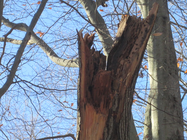

The source of the problem was a notch in the tree where a rear facing branch had fallen, leaving a place for rot and bugs to set in. That left the front facing limb of the notch compromised. I’m a bit PO’d because we had tree work done last year, and I noticed that they left this one when I thought they should have taken it.
Oh well, I guess I should have done something about it at the time. Doh.

At least you didn't have a big V notch in the roof. Looks like a couple of rafters and some end wall repair. Then jack the roof back up.

I got out my recip saw with a demo blade, ran an extension cord from the basement and cut the joist off flush with the wall cap. Then used a hammer to bust the tail away from the rafter tail. When I added the pent up roof I installed a creeper over the joists to set the new rafters on, so that was helping to bridge the door header, and allowed me to get the door open about 80 deg, plenty enough to get inside.

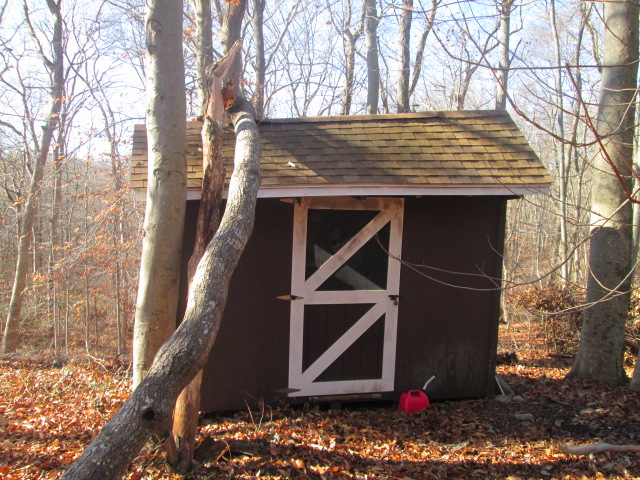

He opines that if we try to drag the tree off it would do more damage than good, while I admit that I’m not too keen about running a chainsaw from a ladder (always ill advised) or standing on the compromised roof while running the saw. He’s game, so after cutting some of the tree that is laying on the ground up, I set the ladder up and toe it for him, he climbed up on the roof and started lopping off the heavy end that is still hanging cantilevered off the ridge to the rear of the roof. Fire wood sized lengths dropping on the roof (thud) and rolling off. Fortunately only two of them rolled very far down the hill. Retrieving those was a bit of a work out, but holding them close to my core and using my legs to climb back up the hill wasn’t too bad; although my back has been bugging me lately, what with hauling all of the axle housings around lately.
Once what was left was only leaning on the front part of the roof and we had shortened up the part on the ground pretty well, it was kind of standing up enough that we could just muscle it away from the eave and let it fall. Then we were able to cut it all up into fire place lengths. Turned out to be red oak, so perfect for burning.
I’ll borrow Karl’s wood splitter and bust it up soon.
We took a good look inside and assessed the damage. It’s pretty much a crap shoot if I’ll be able to save it w/o having to demo the whole roof. We agreed that I can probably just jack the ridge up some for now, put some temporary posts in, come-along the rafter tails together, and throw a couple of temporary ties in to get it thru the winter.
