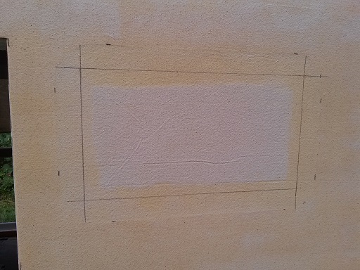

Re: #1
Postby ghcoe » Sat Aug 29, 2015 11:09 pm

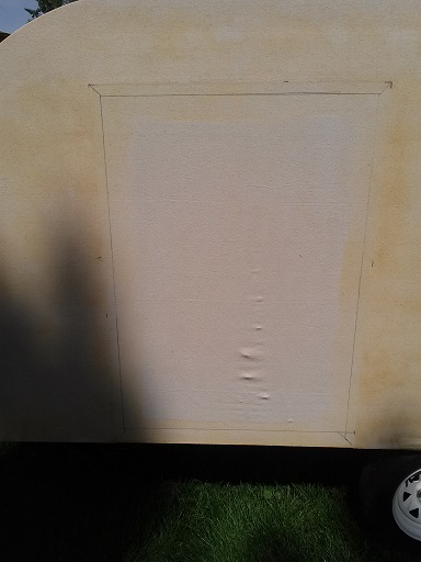

On to the door. I marked out my door frame once the glue dried.
Door marked

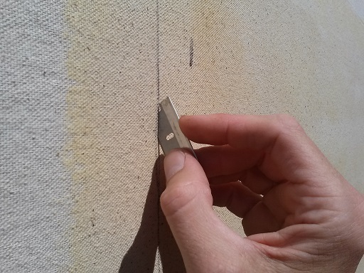

I had painted glue into the door area (sizing?) so that the razor blade would make a clean cut.
Razor blade
The cuts turned out beautiful.
Clean cuts

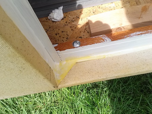

Re: #1
Postby ghcoe » Sat Aug 29, 2015 11:18 pm

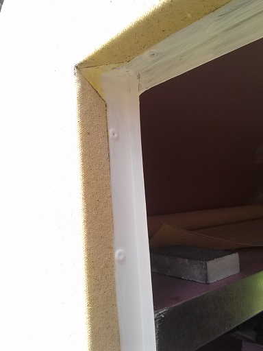

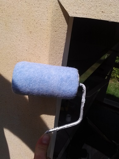

After the cuts I used full strength TBII to glue the flaps back. First I would spray the flaps with water and then paint the door jamb and backside of the canvas. I would make sure to work the glue back into the area that would bend real well. Then I would roll the roller along the edge slowly folding the flap back and then finally to smooth out the flap against the jamb.
Rolling the edges
A couple of finished photos.
Clean corners
Threshold

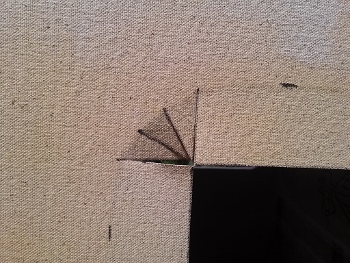

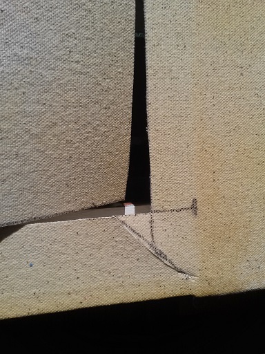

Then on to the window. The window has radiuses so I had to make some pie cuts.
Window marked out
Radius cuts

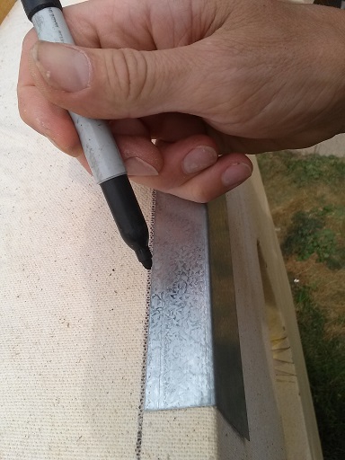

Now to the body edging. I use a piece of scrap flashing for my template. Just slid it along and marked it. Then the razor and same gluing technique that I used for the door and window. Turned out pretty good. The radiuses smoothed out just fine with some water and rolling.

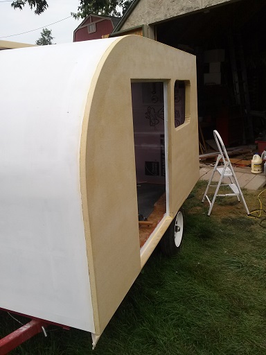

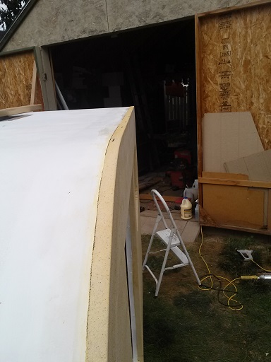

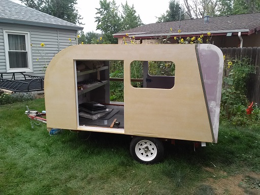

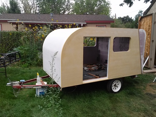

Some shots of the finished side.
George.

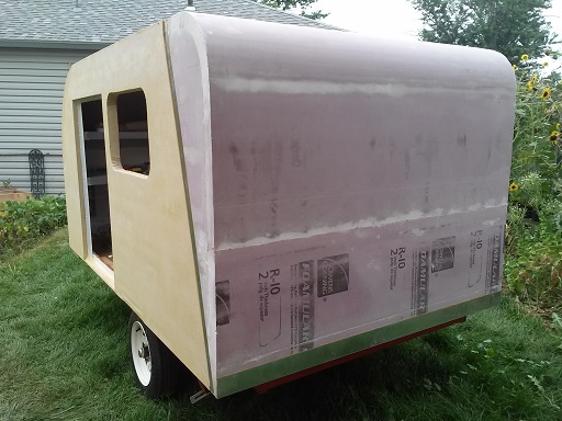

Postby ghcoe » Sun Aug 30, 2015 8:50 am
In case anyone is wondering, I am using the Harbor Freight canvas drop cloth for the fabric. They sell a 12x9 Foot drop cloth and in my case was just barely enough to cover the entire body without a seam. I even had to cut the edge seems open so I could have enough to wrap around the top and ends. The area I was covering was 8'2", but I believe the canvas did shrink some. I had watered down the canvas down the night before to get some of the bad wrinkles out prior to gluing. I had to do a bit of pulling near the bottom to get the canvas to stretch enough to cover into the hatch area. I think that on the other side I am going to try to glue without pre-wetting the canvas. The bad wrinkles that were still present seemed to smooth out fine with some extra water and working them with the roller. I had absolutely no shrinking of the canvas once applied on this side though.
I bought two canvas drop cloths and found this one to be nice and uniform. There is a seam near half way on the long length, but did not pose a problem for me for this build. I will be able to do the other side of the trailer without the seam getting in the way. Two 8'2" by 4'2.5" walls for the price of $14.99 with some extra left over is not bad.
I have not looked at the other canvas drop cloth yet, but I do know that sometimes the weave is a bit off. I have seen them at the store were the weave is a little loose. I just pick through the ones there. You can only see a small portion of the cloth, but it seems so far that if what you can see looks good then the rest seems to be fine as well. Plus I figure once you take it out of the bag check it over real well and if flaws take it back and exchange it.
