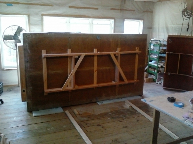

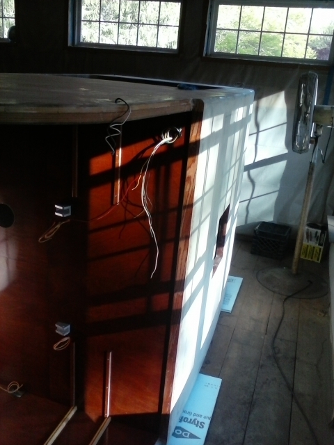

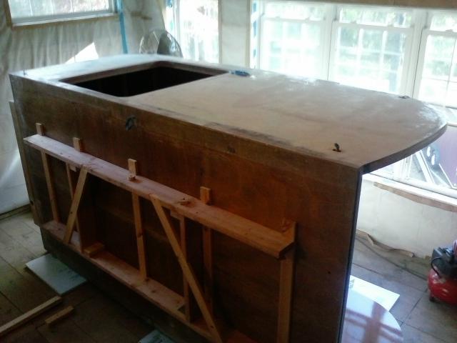

So here’s how things went. Started by emptying everything out of the cabin and taping the coiled up wires (that still haven’t been routed out thru the bottom of the front locker) so that they wouldn’t dangle down inside. Next we replaced the small 2x3 blocks under the build cradle with longer 2x3’s so that it would be easier to slide the cabin toward the work bench, so that once the cabin was flipped onto the curb side there would still be room to walk/work from the roof side.
Next we placed a few 3/4 thk x 2 ft lengths of blue foam down on the floor. I didn’t bother putting anything under where the door was because it was pretty much empty space there. These were leftovers that I had already cut to length matching the width of the camper and have no future plans for, so wasn’t too worried if they get damaged.
Karl figured we could do it all by hand without any rigging equipment, and with the both of us, he was correct (although when I’m by myself and trying to just prop the cabin up on a tilt I still need to use the floor jack). Basically we lifted at the door header and teetering on the build cradle, then tipped it up on the edge of the curb side floor until we found the balance point. Then Karl went around to the far side and held it by the roof vent opening until I came around and we lowered together. Frankly it didn’t seem that heavy, but when you consider that the floor is the heaviest part and we never really lifted the whole of it, it makes sense.
Underside of floor with work cradle.
View of roof, curb side down.
So the good news is that the street side wall is now horizontal for me to work on. The bad news is that it is over 5 ft in the air. My little two step stool only gets me up to belly height, and a 6 ft step ladder puts me either too far away or side ways… too awkward to work off of efficiently. So I need to come up with some simple scaffolding, about 34 inches high x 2 ft wide x about 5 ft long. I have several options that I will explore further tomorrow.

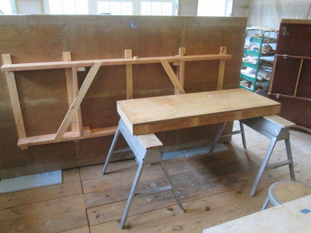

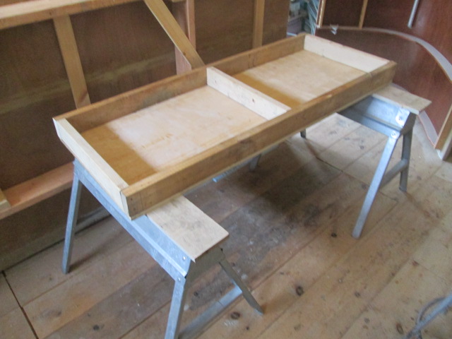

Yesterday I used some donated scrap lumber from Karl, a couple of 2x4’s and what was once a very nice piece of birch cabinet grade 3/4 ply, to make this scaffold plank. It’s 24 wide x 60 long. Here’s the underside framework.
And the top side with it toed to the sawhorses using a couple of drywall screws.
The horses put it a little higher than the 32-34 inches I was shooting for, so I might trim down the frame, leaving the ply cantilevered at the ends and just screw that to the horses; or I might add dedicated legs and bracing to get it to the correct working height.
