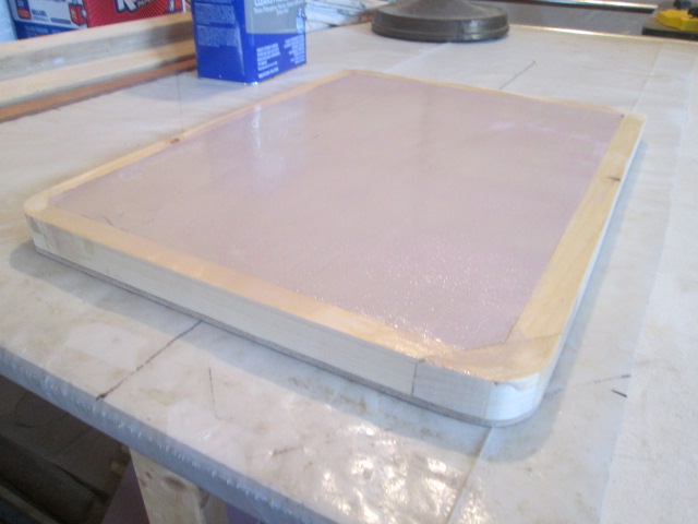

KCStudly wrote:I did a little more on the fridge lid on Friday, but the temps here are still too cold for epoxy; it was about 45 deg F all day. (We had a light dusting of snow yesterday and are expecting more again tonight.)
So I just used TB2 to laminate the foam down to the panel and get the rest of the rim frame attached to the other two corners. Took one picture of gravity and spring clamps hiding most of the part; which didn't seem to be worth downloading from the balky camera. (Maybe next time I will see how my new action camera does for still shots?)

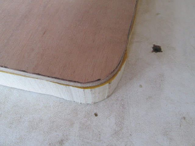

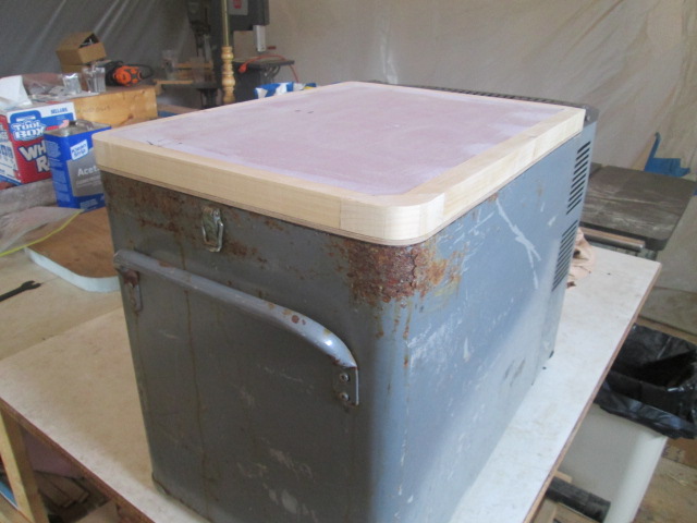

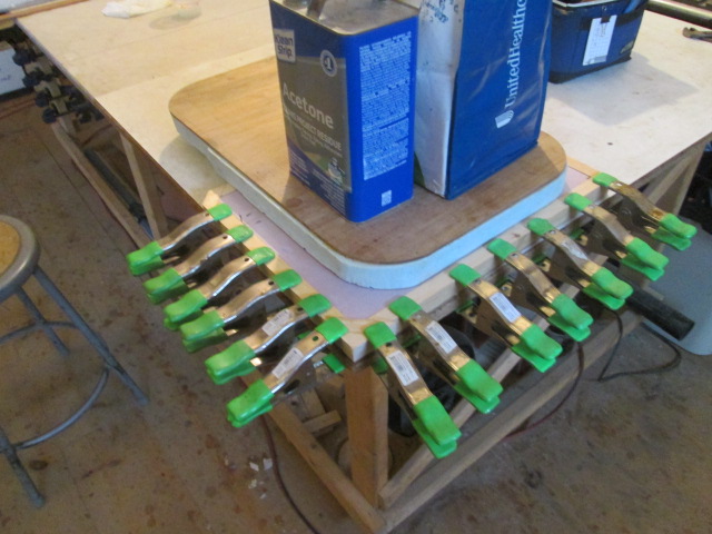

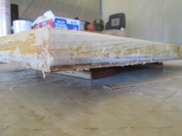

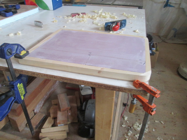

Here is the fridge lid from the other day with field foam under some gravity clamps, with the cutout from my side door window acting as a load spreader/buffer piece. I figured if there was any squeeze out and the foam got glued to it that it would be easy enough to separate. The spring clamps are holding the last two sides of the frame.

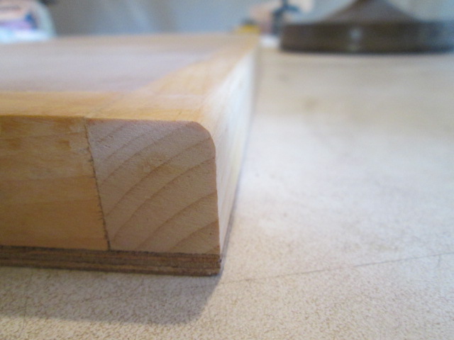

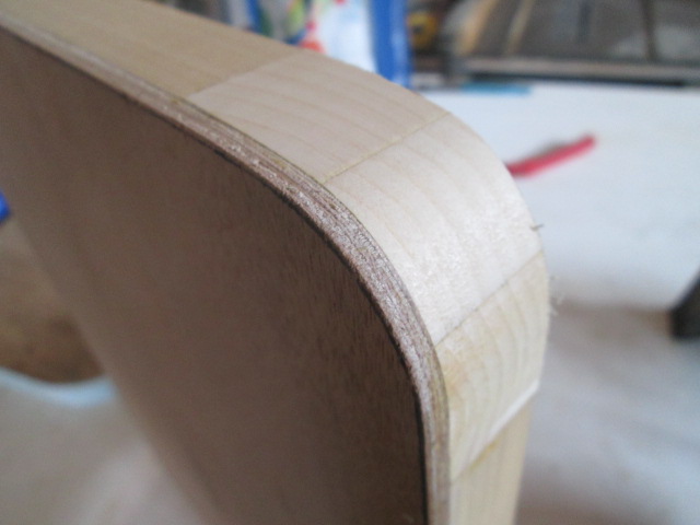

Bringing us to today, here I have removed the clamps and, using the bandsaw, rough trimmed the frame where it was overhanging the ply base. This will make it easier for the flush trim router bit to get the job done in one pass.

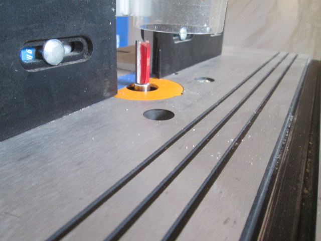

I figured the larger area of the router table would be more stable for the depth of cut, so I set that up with the fence backed off enough.

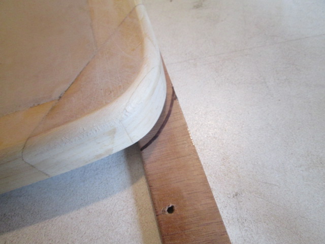

Here is a close-up after the cut.

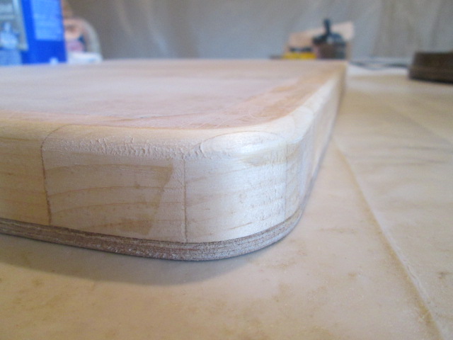

Unfortunately I am still rusty with my skills (use them or lose them) and let the piece lift up off the table while making one of the corners. Eeyore.

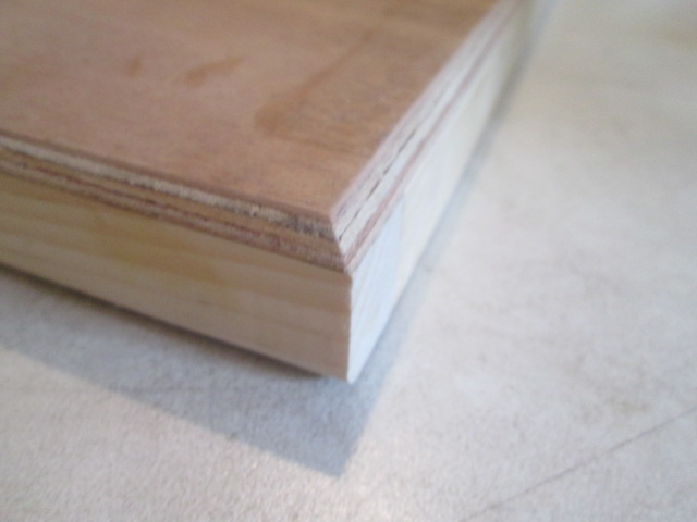

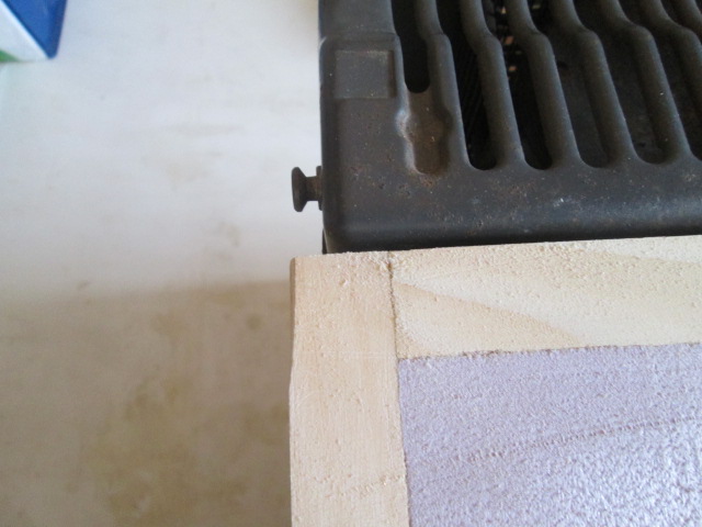

Next, when I ripped the frame pieces I hadn’t checked the table saw over well enough and someone hadn’t squared the blade up to the table very well after a bevel cut; plus it was a tad higher than the foam in most places; so I hit it with the palm plane to bring everything flat and flush.

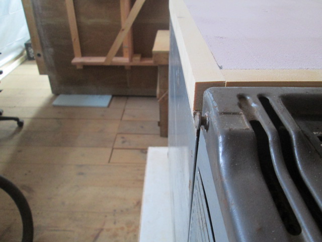

Time for a test fit. It hangs over everywhere about 1/16, which I am kind of okay with, but thinking about it that will only get larger with the addition of FG.
Here’s a better look at how the hinge pin is shaped. You can also see that the lid outer edge is currently wider than the groove in the pin. I could make the lid narrower, but I kind of like the idea of being able to grab under the edge enough to lift it, rather than having to add a handle. Also, that would expose the vertical edge of the sheet metal shell, so I think I will offset the hinge tabs instead.

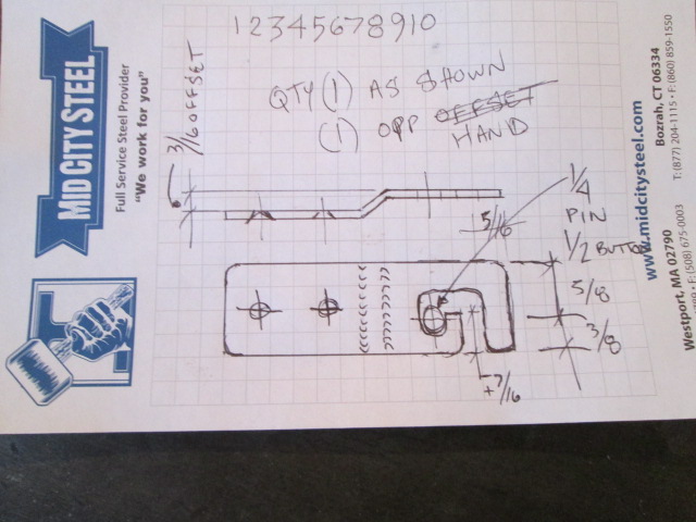

I took a few measurements and came up with this design. I may change it so that the slot exits out the back instead of the bottom (easier to make). I think as long as the bottom of the horizontal portion of the slot is above the center of the pin, it will still stay on the pin unless intentionally removed.

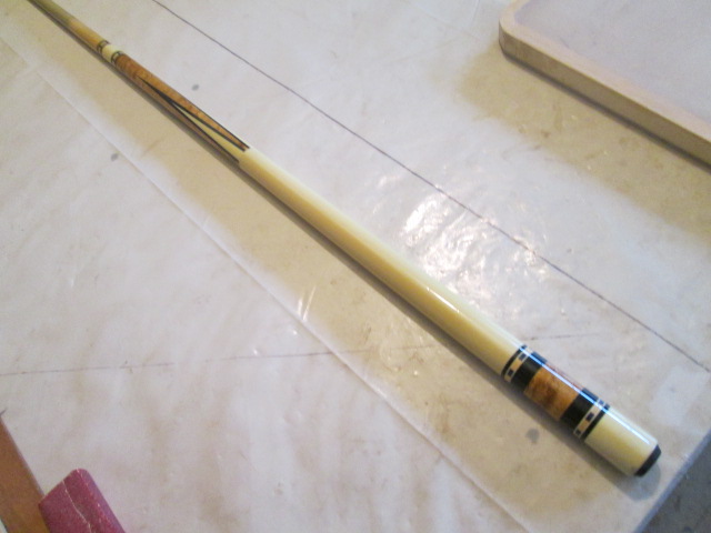

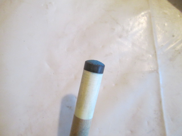

So one of the things I have been doing instead of camper work is playing pool. I think I mentioned that I have joined the APA league. We (Cue Cutters) are currently in 2nd place in our division. Allow me to divert for a few moments. When I got married near some 20 years ago I pretty much stopped going out and playing pool, but have recently dragged my old cue out and have gotten my skills back. My playing cue is a Meucci M4 from the early ‘90’s; it is older than some of the players on my team, LOL. That being said, the original tip had been worked down to where there wasn’t much left of it. I have never replaced a cue tip before, but with input from videos on the internet I felt like I could do it myself. I bought a few water buffalo hide tips (the current trend toward laminated pig's hide tips does not appeal to me due to the voids left when shaping the laminations), besides, the old school tips cost about 1/10th that of the laminated ones.

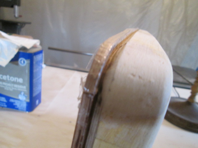

No turning back, sliced the old tip off, prepared the ferrule, scuffed the new tip, masked with painter’s tape, used gel CA to glue it on, scuffed the excess down with the small sanding block and fine 320 grit (the finest paper I had on hand), burnished with paper towel and a dollar bill, and it came out nice.
With some finer paper I could take all of the scuff marks out of the ferrule, but it is a working cue with a few dings and dents anyway, so I’m not that worried about it.

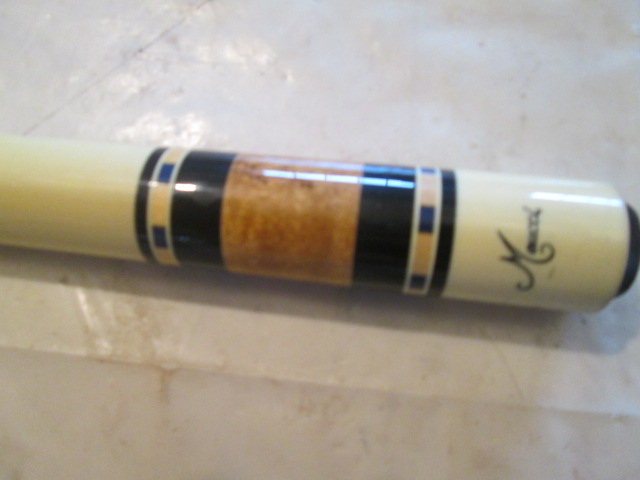

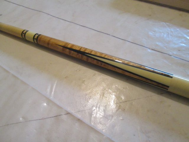

The dark inlays don’t really show unless you look under direct light. They are actually cobalt blue surrounded by black with burled maple and rock maple shaft.
The ferrules and collars appear to be ivory, but based on the stylized ‘M’ script it is later than 1990, so must certainly be faux ivory… I hope.

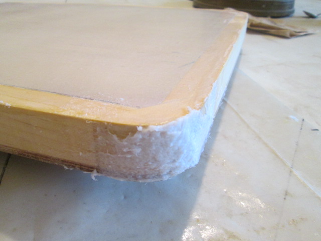

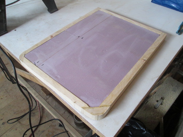

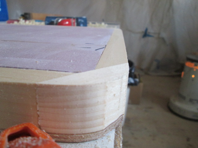

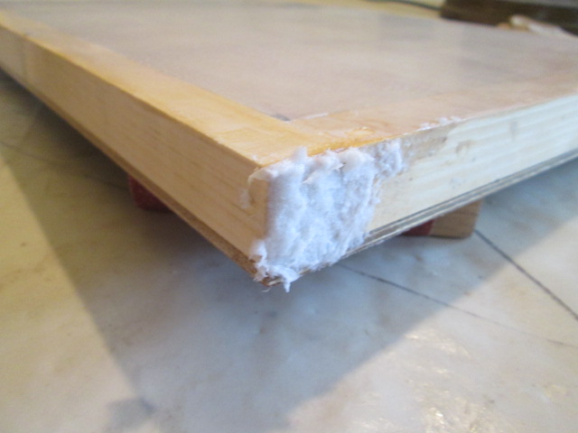

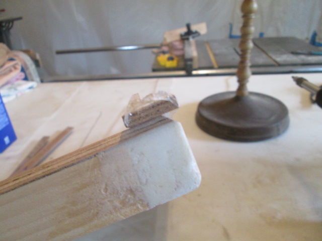

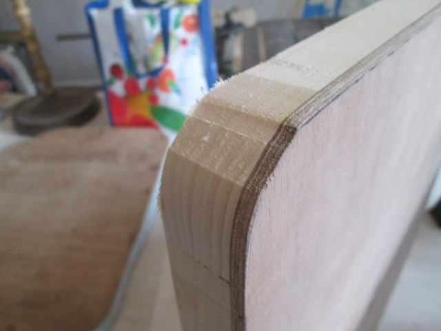

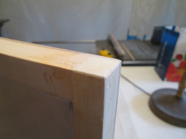

Here is the rear corner of the fridge lid where the perimeter frame joinery was less than perfect. I needed to fill the end of the side rail to be flush with the back rail. Used 403 filled 3 minute epoxy to build out the shortage.

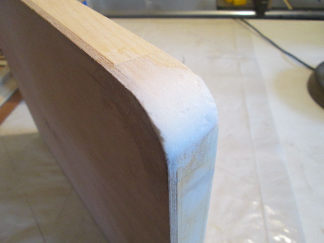

Here it is after rough sanding back and another round of filler to fill any voids that wouldn’t be taken away by the radius top or flocked bottom edges.
Another small batch of 3-min epoxy with flock filler to fill that oops I had with the router on the rounded front edge.
Sanded back.

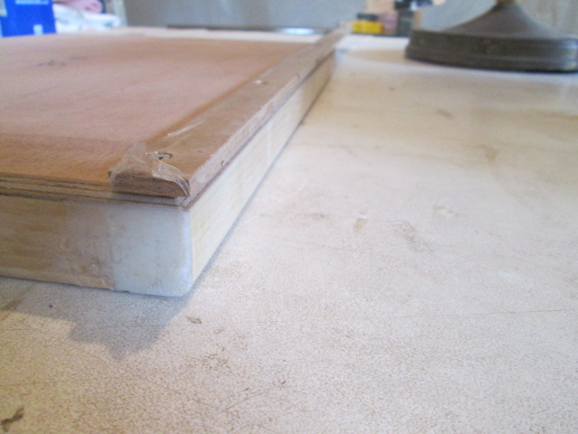

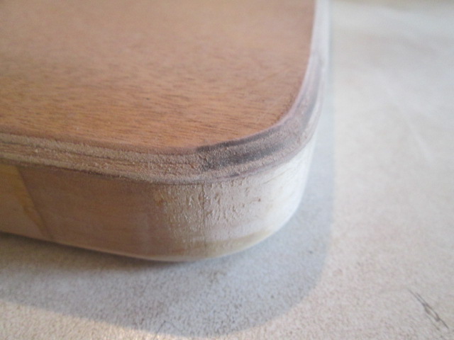

Set up the router table and rounded over the top edge of the lid by 1/4 inch radius to allow for the FG cloth to wrap, leaving the rear edge sharp.
Then I switched over to the beveling bit and knocked the corner off the bottom edge to accept the epoxy flocked edge.

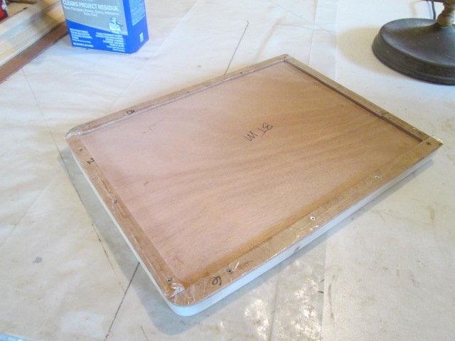

I had saved some of the strips of scrap 5mm ply that I had previously used as temporary dams for flocking the edges of my doors and door jambs, so I reused those here. They even still had the packing tape release layer on them and screw holes every 4 or so inches. By aligning them proud of the frame edge, when I fill the bevel with the chunky flock filled epoxy there will be a little excess to sand back, avoiding pock mark voids that might otherwise result from the well thickened flock.
Since I already had these strips, and they were already covered with packing tape, rather than fitting them coarsely and trimming them back with the rabbeting bit, I just went by feel and screwed them down a bit proud, thus allowing me to reuse the existing tape. So on the corners, I just used a sharpie marker to make a stand off mark, and trimmed outside the line using the vertical bandsaw.
I re-taped the cut edges with more packing tape.
Here is the underside of the lid with the temporary flock dam screwed in place.
Here is the beveled edge to be filled.
Here I have mixed up a 2 squirt batch of epoxy, filled with 3 heaping teaspoons full of 403 filler (a bit thick) and used a squared off tongue depressor stir stick to paddle the ‘thick’ into the bevelled edge.
Rather than dragging the flock along the bevel, the technique seemed to be to first fill along the bevel, then drag straight from the rounded edge toward the dam in a perpendicular motion. This helped remove excess filler from the wood frame and seemed to help minimize the jagged pock mark low spots that seemed to form from dragging sideways along the bevel. Looks a bit sloppy, but better to over fill and sand back, than to have to fill again.
