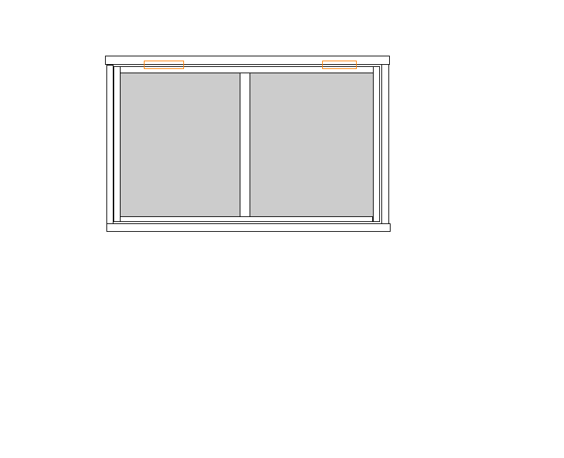

i am trying very hard now to not use wood at all, except for the floor.
i have figured out a way for the windows to be woodless. no need even for the frame. actually its pretty easy. that foam will be 2" thick. just dig/cut out the opening but don't go all the way. get a piece of plexiglass that you can fit in there, and for a screen you can just use a piece you might have laying around the house from an old window, but we have a roll here that hubby was using to repair old ones. anyway you could just cut the size you need and with some hot glue [which crafters probably have around] hot glue material/frame around the cut screen, then just use velcro and wahlah. keep that piecie of foam you cut out and you can place it back in. i am sure this will work, just gotta figure out how to keep it in place while driving because of the wind blowing on it. hmm, now that i am typing that idea out, still might need a piece of wood, but not entirely convinced i do. we'll see when i get to this stage.
working on the door now.

I was thinking about building windows with an Outer flange and an Inner flange that would bolt together in a clamping action on the walls. That would not need wood either. Though the flanges/frame could still be of wood
Door could be a bit harder

Standard windows with the mounting flanges , would probably work fine on just the covered foam as long as they were well sealed and not Too much pressure applied during the final mounting ... Just snug em' up tight and forget it ... That's what i was planning for the window(s)...
Like Wolf said, door's another story .... constant use/stress, has to be Stout... Wood framing on the door and shell wall for hinging is probably recommended.. all covered over with the fabric as not to be unsightly ... and better protected too ..
Eagle , You could make a wooden framed window , surrounded by a wood support frame , and maybe even hinge it to open ... Simple for Hubby ... Image
