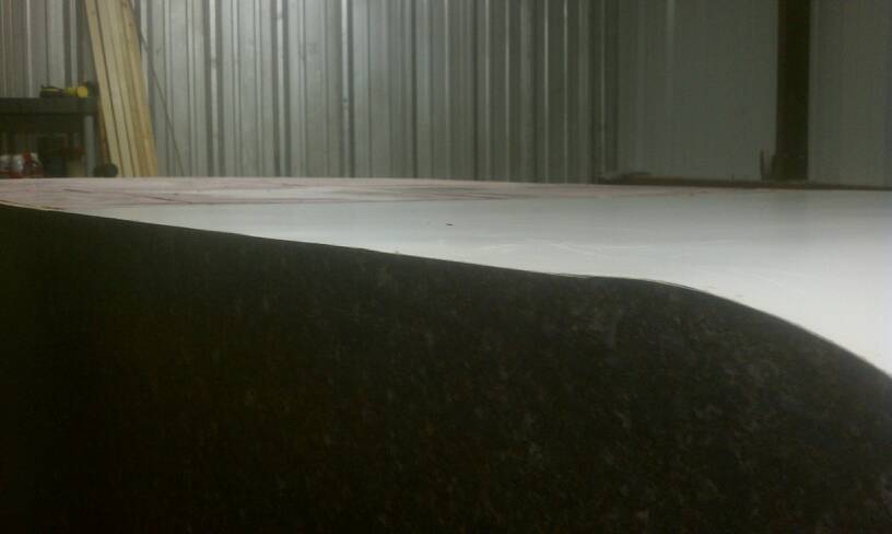

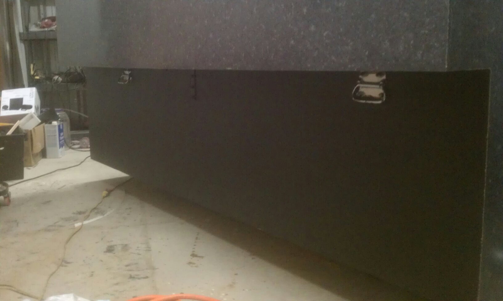

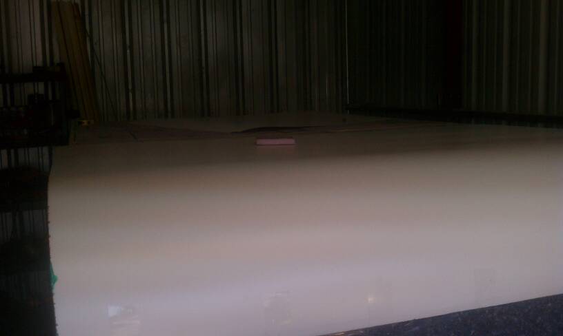

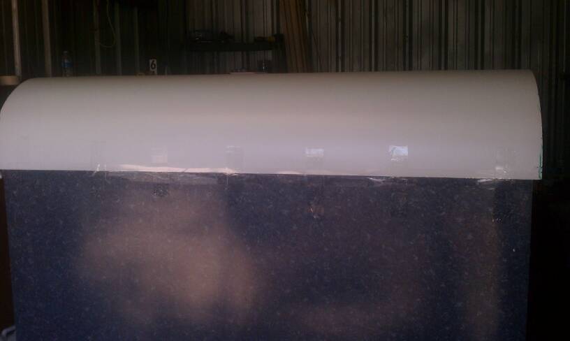

Well if you were wondering what formica over a stick frame and foam looks like.......here you go. Sticks very well to the foam and frame with 30nf.

Hey the formica is horrendously light and strong so might just wanna take it to the ceiling. The weight difference of it over the aluminum is akin to the difference in steel and aluminum. I got it 25 a sheet on clearance. It also comes in 5 x 12 sheets and it's oversized a very nice surprise.
