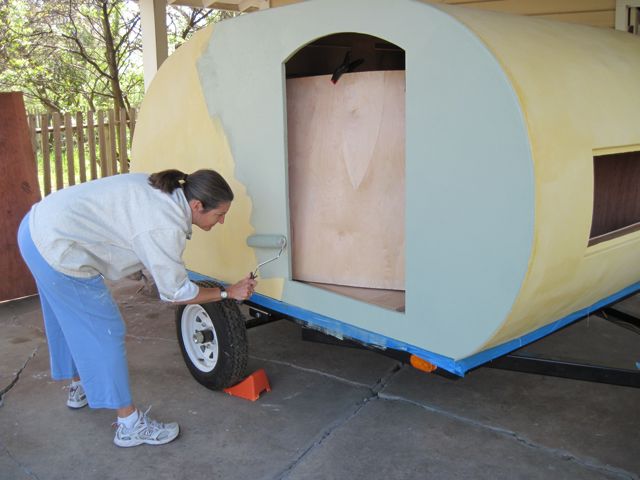

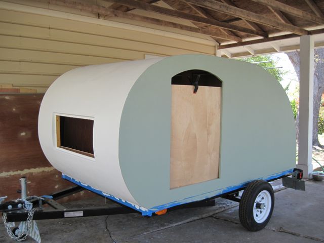

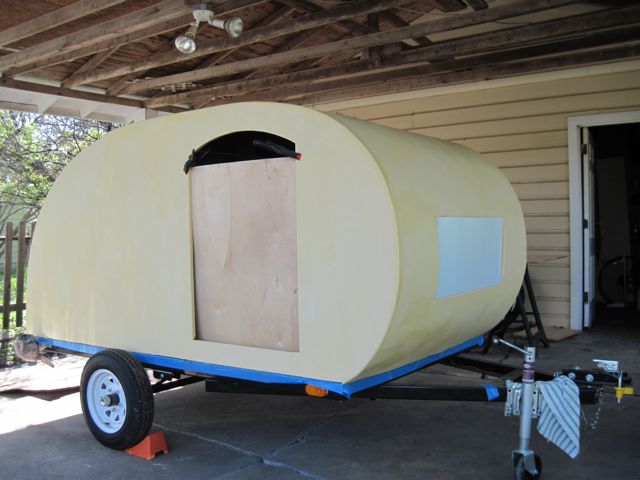

Have been away for a while with a move and switching to full-time work, bleh!, but have been doing a lot of what you're talking about on my build. I'm starting with wood, not foam, but similar, I think.
On a tip from Steve (I think) during Caseydog's build, I got an article from Wooden Boat magazine about canvasing boat decks. It sounded like a cool idea for waterproofing/sealing my teardrop, and I thought the texture would be kind of cool, too.
Following the article, we glued the canvas on with Titebond II...
then painted it with diluted TitebondII...
sanded and painted with exterior house paint...
I love the look, just now need to find the time to finish the trim, hang the doors...
Not exactly the same, but thought I'd share. :) Will be looking forward to the tests!

Postby laursand » Tue Sep 21, 2010 8:58 pm
Thanks, BBM!
I actually brushed straight Titebond II onto the entire wood surface before canvasing. The glue was so thick it was hard to roll. The canvas just went on like a piece of wallpaper-kind of fun, but we had to be careful not to be off or slanted at all with 8 feet to unroll! Definitely a two-person job!
We let it dry for a couple of days, then painted (rolled this time!) with about 2/3 Titebond II to 1/3 water. Really soaked it! When it dried it was truly so rough and hard that I scraped myself rubbing up against it. Then sanded and painted.
Hope this answers your questions!
