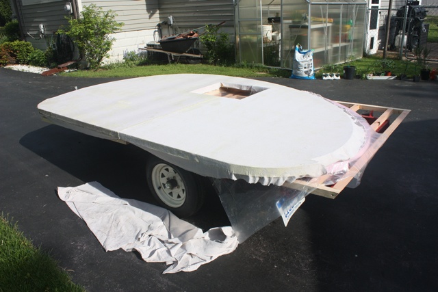

Got the first side canvased up this morning. Interesting stuff.
First of all the canvas had a big seam down the middle. So we ended up cutting the stuff in half and throwing the seam away. That required us to butt joint the canvas while we were gluing it up. The 2nd layer will cover the butt joint (but create a new joint)
Secondly, we used about 3/4 of a gallon glue just gluing the canvas down to the side.
I left the overhang at least 2" so that when the roof is glued on, I can glue the overhang to the roof!
Right now the canvas is in the sun, drying.
P.S. When do I apply the thinned out glue to the canvas? After the first layer, or after the 2nd layer? or after each layer?

Mike that's really coming along Nicely 8) The addition of the diluted T2 seems to be an option ... Eagle coated hers before priming , I just primed over the canvas directly ... I believe as Eagle put it , the diluted T2 requires less primer later ("sizing" the fabric)... mine really soaked in ... But I still used a gallon of primer like she did , but mine is much smaller (standard TD size) :roll:
It does seem to take a lot of glue ... 2 gals. down here, ready to crack open the third to finish the interior... should have lots left over.... for the next build ... :thumbsup:

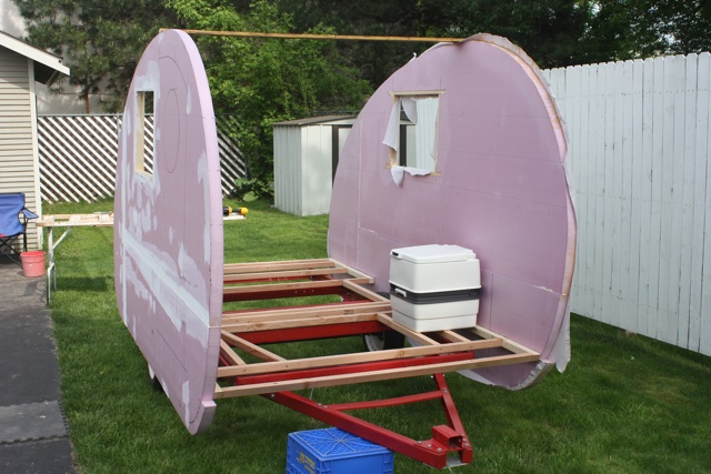

I wanted to get a quick and dirty look at how this design would be in real life.
So we dry fit the sides to the sub floor.
As you can see, the porta potty fits!
But the foam attached to the subfloor is not a real strong joint. We are thinking that skinning the inside with wood would help the connection between the wall and the subfloor.
P.S. And yes, we still have to cut out the wheelwells...

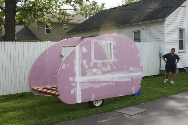

ok just have to say as you can see in the pic above that I am still not convinced that I am all for this foamy stuff. I am not against it either my vote is still out. It is easy to work with but it still takes 2 to hang the side. I have been busting my bu** and my feet to help and I sure hope it is worth it. I have to see once we get more going if I am in or out. It is a fun project I must say. I can hold up the whole side as Mike screws it into the subfloor. We will keep you posted. I just had to put in my 2 cents. I usually am a silent listener but thought I would speak up on this one. Girls if you want to help your hubby this is the one to work on. Easy and doesn't weigh a ton!!!

Kinda nice on not Having to decide where the door is going to be yet :roll: - just cut in later :thumbsup: It also opens up the possibility of more door shapes :twisted:

Postby Miriam C. » Sun May 22, 2011 8:33 am
:thinking: Mike I wonder if you couldn't give the sides more support by putting a groove so that the side sits partially on the sub-floor. Might need to set the sub-floor our a bit more to get the look!
Postby bve » Sun May 22, 2011 9:51 am
Miriam C. wrote::thinking: Mike I wonder if you couldn't give the sides more support by putting a groove so that the side sits partially on the sub-floor.
That's what I was thinking too, 'router' a 1/4" or 1/2" deep channel into the walls.
