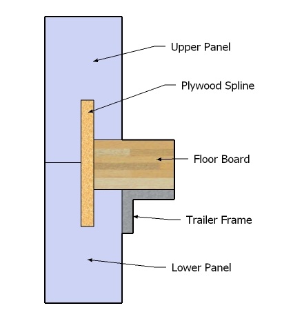

Postby gullywompr » Sat May 28, 2011 2:52 pm
How about two panels joined by a spline, the joint running down the line where the wall meets the floor, the spline giving a hardpoint that can be screwed the the floor.

Postby GPW » Sat May 28, 2011 3:19 pm
CO, that's a good idea ... Yet another method to choose from ... :thumbsup:
