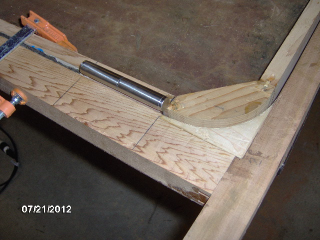

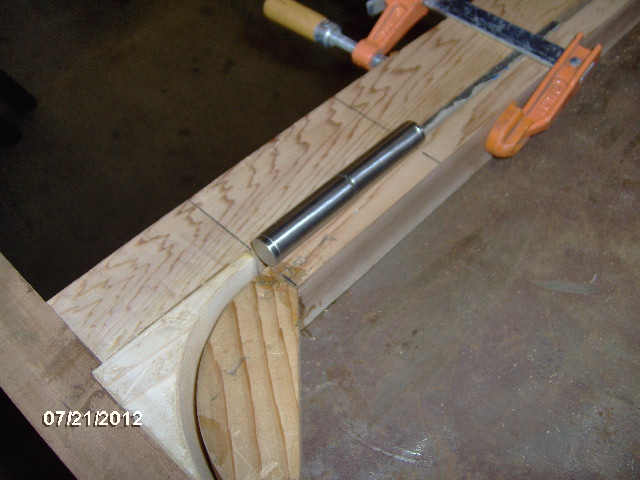

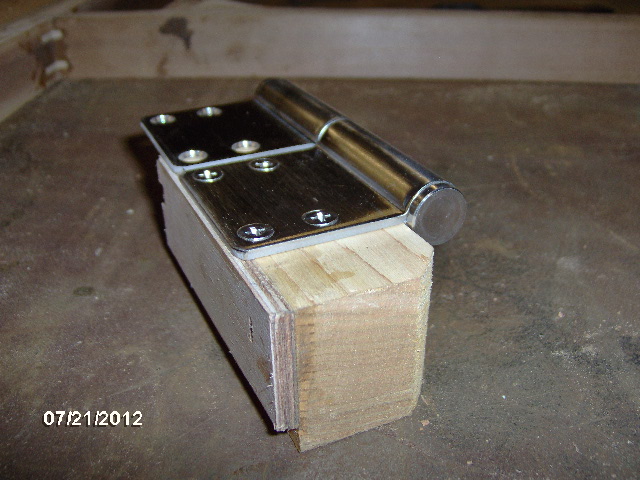

I chose lift off hinges for TPCE. These mount to the inner face of the jamb and door frame leaving the screws captured in between for better security (no way to unscrew the hinge while the door is closed).
No need to recess them as they are thinner than the door gap. I may actually have to make some small aluminum shims to go under the leaves to set the door gap even all around.
I like the sleeker look without anything but the barrels protruding. Haven't finished assembling it yet, but you can see them here. They are reversible, too.

My door gap is 1/4 inch plus a sliver here and there. The leaves of the hinges are barely 1/8 inch thk and fold back on themselves one over top of the other, single thickness (MC PN 12575A72), so I have to make up about 1/8+ inch. This way when I wrap the canvas around the door opening and frame I won't have to worry about following little itty bitty contours. After canvas, dry fit the hinges; fill screw holes with TB2 or CA then chase with the screws; allow to dry; paint & final finish; if the door gaps are still greater than 1/8 inch, make shims; install hinges (shim as req'd) over the painted canvas in a bed of some sort of gooey stuff (probably 3M 4200). That's my plan, anyway.
