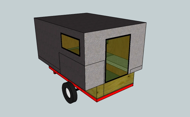

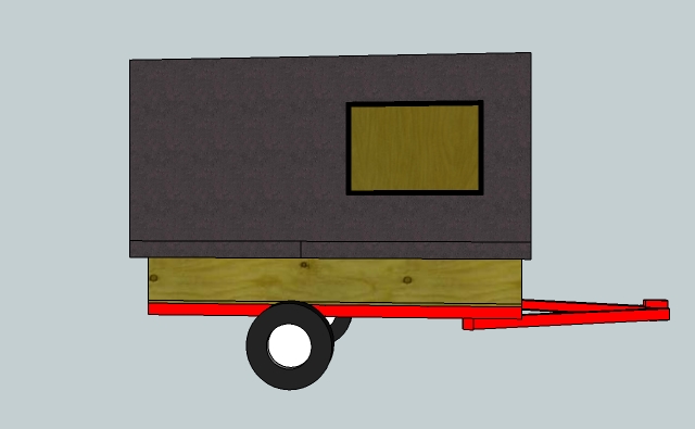

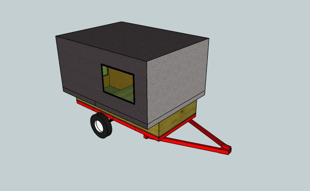

If I went with the original Bunker style box design, I could go with the 10' wide canvas and only have seams on the ends.
The dark gray parts in these three would all be one continuous piece of canvas. The lighter gray could be done from a 3 yard piece cut in half.
An interior pic just to show the benefit of building it on a raised box. Leaving room for a lot of under-bed storage, a cabinet with counter space, an extra seat and still leave about 10 sf of open floor.
One could even throw a sleeping bag or air mattress down there for extra sleeping space if necessary. Could easily sleep three.
wagondude wrote:If you do go with the raised or sloped roof, Why not utilize the increased hieght at the rear and put a taller door in. Seems kind of pointless (to me anyway) to build standing room then have to bend over to go through the door.
Well, it was originally a factor of the pop-top where, even though you had 6' of height you still only had 4' of solid wall.
You could do it with the solid one. Although, I wonder if the structure would be more solid with a beam of some sort across the top of that part. Making another small wall for the extended part.
In either case, though, in thinking about it, I guess you'd have a seam there.
