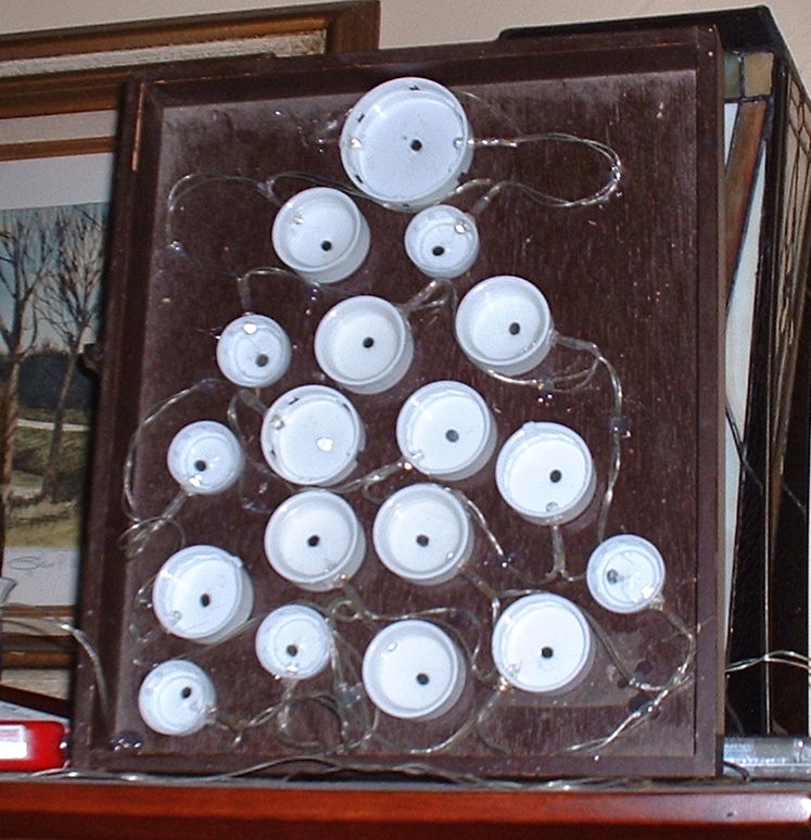

Just a little Thrifty Christmas LED project ... Long have we realized we could increase the light area of a LED by inserting it into a white plastic bottle cap , from the side ...So we drilled some 1/4” holes in the edges of some caps we’d saved for just such an occasion ... tacked the caps in an old shadow box , ran the LED Christmas lights , and hooked it up ... a little hot glue to hold the wires, NICE!!! .... please excuse the picture , it does no justice to the colors and twinkling this thing does ... :D Just something for FUN , but it does make way for a more sophisticated LED / bottle cap trailer lighting scheme... :thinking:

And now we have a confirmation of the LED /bottle cap advantage... Only white caps work ... It seems to diffuse the light into a larger area, causing the whole surface to glow , and removes the harshness of the LED light... and it’s Thrifty ... With the LED giving off more “apparent” light , less are needed , requiring less current draw, smaller batteries , charging , and on and on ... ;)
Naturally now I’m thinking how to make a bottle cap/LED “Decor” light fixture for the FS, or maybe even the house and Studio... LEDs ,for now , seem the the future of lighting :thinking:

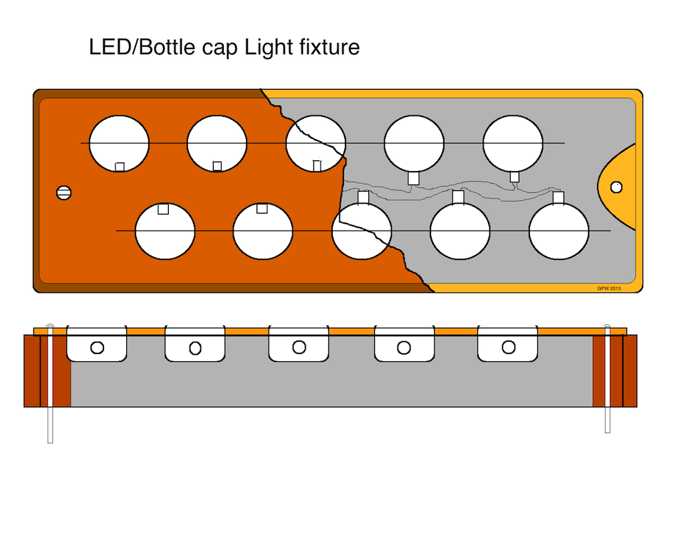

Oops !!! Yet another drawing ... :roll:
Thinking of a decorative -ish' light fixture like this , just a pretty wooden box with the right size holes in it to receive the bottle caps ... :thinking: Maybe even a nice wooden cigar box...? :o
