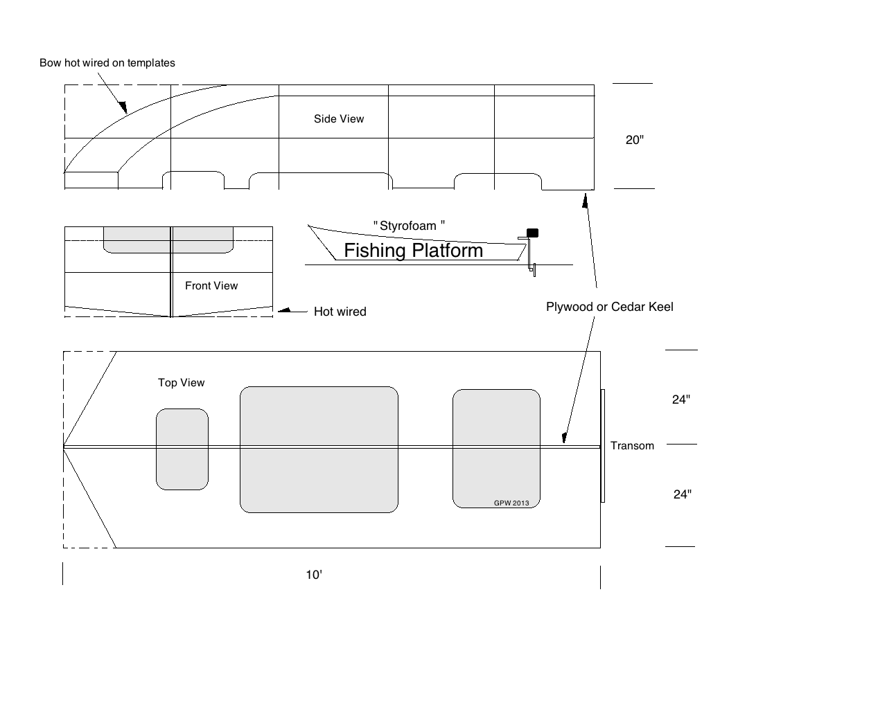

Here’s an idea we were thinking about ... Not a Yak .. :oops: But may be practical ... Four blocks of foam ... :thinking:

Postby KCStudly » Fri Nov 08, 2013 8:56 am
I would go a lot deeper on the pockets, and bigger so you can get the weight down low inside. Wouldn't want it to be tippy with buoyancy. :frightened:

Postby GPW » Fri Nov 08, 2013 9:03 am
KC, that’s true huh !!! :o ... maybe half way down ? ~ 10”... ? The wooden keel should add enough strength for cutting deeper pockets ( I think :roll: ) ... would be more comfortable too .. :thinking: Easy to FAB too , with the four blocks ... more hot wiring ... THANKS !!! :D

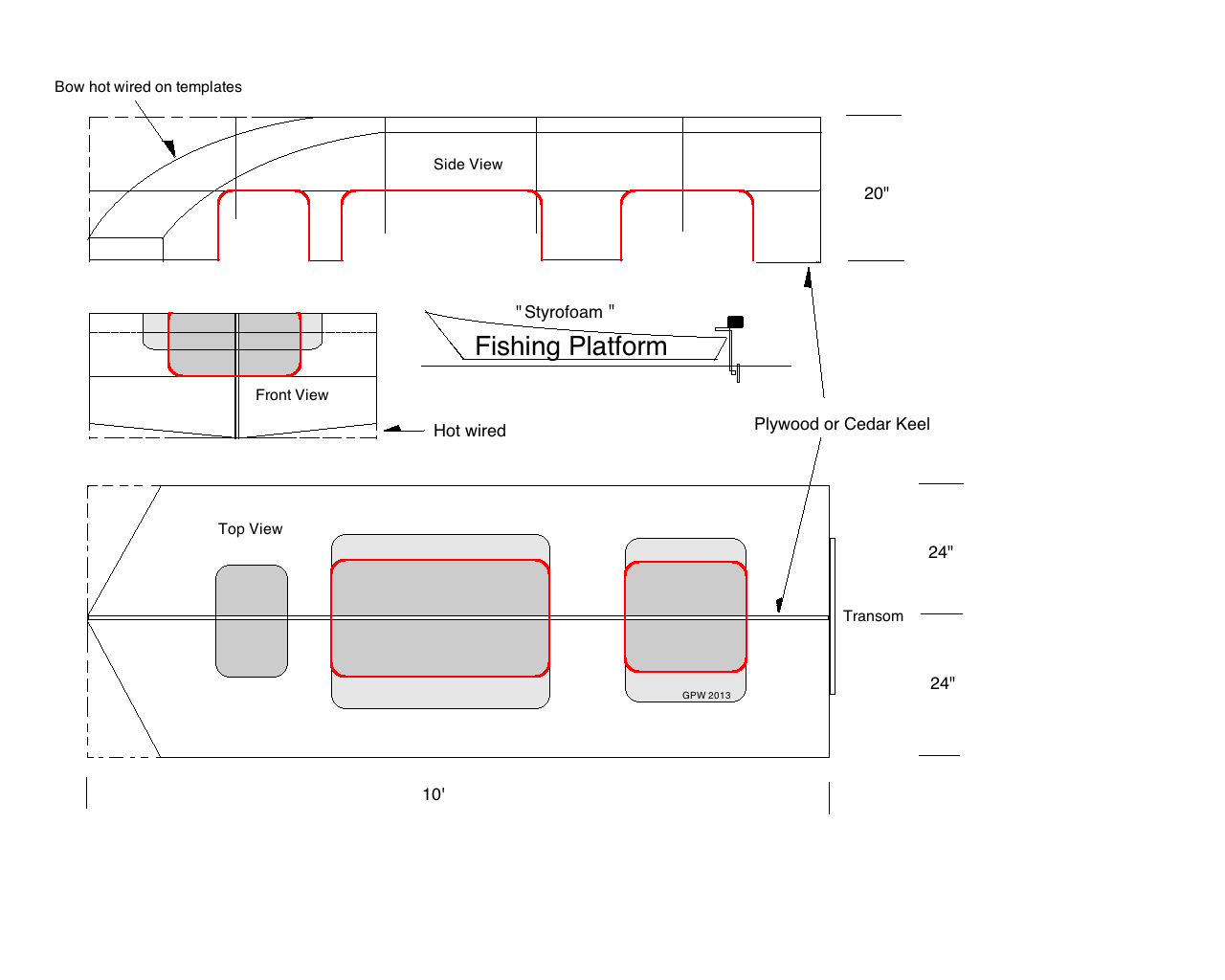

Postby KCStudly » Fri Nov 08, 2013 9:27 am
I would go as thin as you can on the bottom. The further below the buoyancy point the CG is, the more stable the platform. A very buoyant boat will not displace much water, so is harder to get the CG down, at least by my way of thinking... I am not an expert on boats. :R

Postby KCStudly » Fri Nov 08, 2013 9:30 am
Another thing to consider is, with such a simple shape when you cut away the front curve of the bow you are taking buoyancy away. Leaving the stern full depth might result in an imbalance causing the bow to nosedive. Perhaps a scale model with scale ballast?

Postby GPW » Fri Nov 08, 2013 9:37 am
How much you think we could get away with ??? .... it’s just for Calm waters ... little stress, save supporting my great Bulk, and all the other c**p too.. :o Maybe make the pockets deeper , but narrower... more “meat” (foam ) on the sides ? All that foam should sit pretty high in the water ? What, roughly 30+ cu.ft. of foam ? ... :thinking:
... a scale foam model .... Yes !!! ... another test ... :thumbsup:

Postby GPW » Fri Nov 08, 2013 10:04 am
This any better ?
We had a 40” wide Coleman Scanoe' for years and fished a lot in it (Wizard 5Hp on the back ... remember those ) ... Very stable and we could easily stand up and fish ... Thinking 48” wide floating block is going to be extremely stable ... :thinking: And I ALWAYS wear a life jacket ... ;)
Maybe make it flat bottomed like a scow .. even easier , more foam/buoyancy, even More stable ... :thinking: Might as well call it a light Barge ... :lol: :lol: :lol:
Not really worried about nosediving with an electric trolling motor on calm waters ... Not going that fast ... strictly displacement hull at these speeds .. Draggy, slow,inefficient... But, I’m Fishing, and that’s all that counts eh !!! :thumbsup: 8) :D ... Figuring less than $500 all up (or close) ... I can do that ... ;)

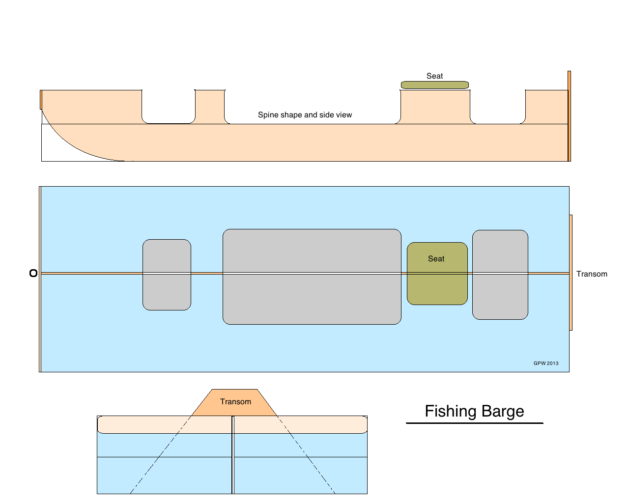

Postby GPW » Sat Nov 09, 2013 8:47 am
KC, by “project creep” are you referring to the ever expanding amount of time it takes to complete new projects ? I suffer from that !!! Likely too much thinking and planning, but we find that part most enjoyable ... and the discussions... We are so blessed to be able to communicate our ideas and opinions so quickly ... 8)
And logically , the more time to think , the simpler the project becomes ... Here’s the latest thoughts ... More “sit on top” than boat ... more Barge than Yak’ ... :oops: So Easy , Grandma could make one ... :thumbsup:
