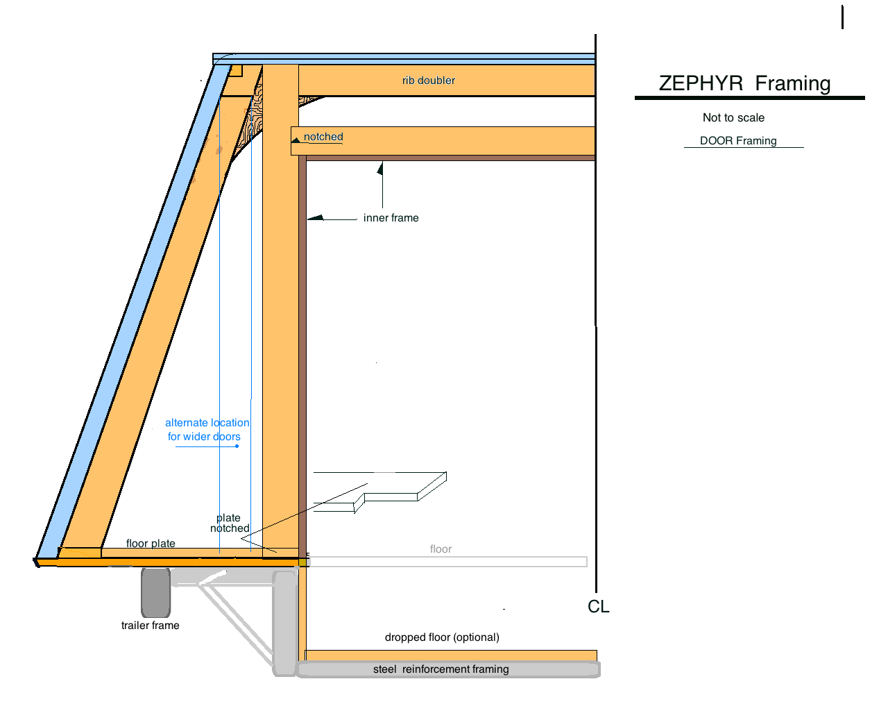

Here’s a little drawing for the rear doors and perhaps a dropped floor ...

Postby High Desert » Sun Oct 13, 2013 10:56 am
OK, I'm totally with the multi-use ability now. Especially since an unexpected rain just ruined something left in the uncovered pickup last night. This will be awesome :twisted:
