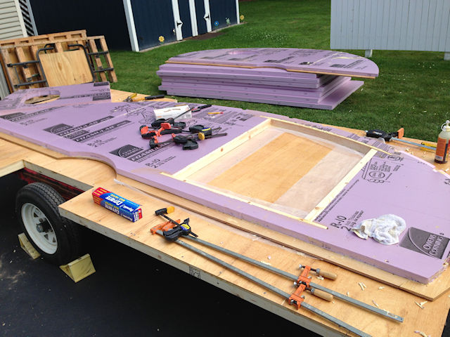

Well my endgrains are finally all sealed up. Took 3 sessions, about 6 coats, but it looks good.
So today the plan is to glue the hard edges to the foam. But we have a heat advisory in effect, with a real feel of 99 degrees F, so I'm not sure how long I'll be working today.
But on the bright side, it's really really humid, and gg is moisture activated! :)
Keep your fingers crossed. I'll try to get some pictures! :pictures:

Postby mikeschn » Sat Jul 18, 2015 9:04 am

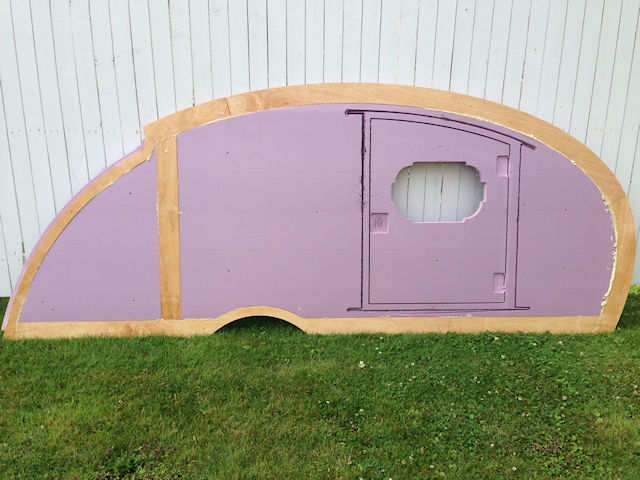

The hard edges are glued on. Next up, set the walls on the floor.
Re: The Mad Dash begins...

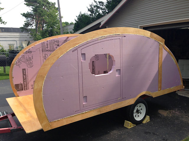

Postby mikeschn » Sat Jul 18, 2015 9:33 am
So that's what it's going to look like! :D :lol:
Postby mikeschn » Sat Jul 18, 2015 5:16 pm
Glued in the doorway frame... enough for tonight... more tomorrow...

I'm curious how you managed to form your door header w/o putting a lot of stress on the foam over the door arch. Looks like regular pine furring bent.

One thing I learned on the Big Pink is that you will want to put an angle on the door threshold for water to run down and out.
Looks great !
Tac

That's a good idea. I'll have to sand it in though...
@KC, gonna be another hot one today!!! The upper piece is made by laminating 4 pieces of .1875" thick pine strips together.

Or you could add a thin angled piece on top of your existing threshold ... :thinking:
