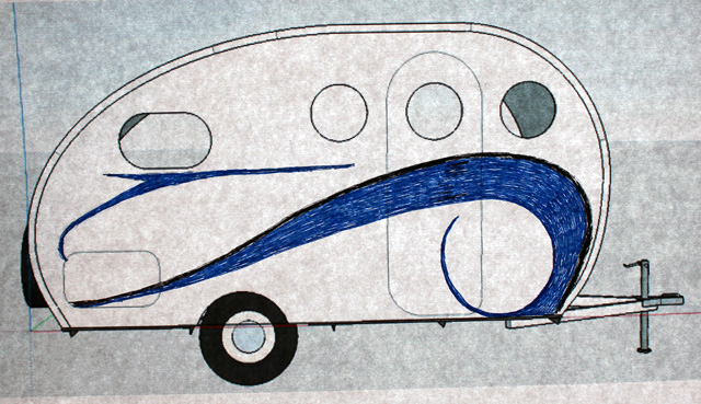

That is impressive! :applause: I'm not even going to show you my doodles because they look so poor in comparison. I like the second one the best and I'm picturing the blue color between the "swoop" lines. I'll figure out how to paint that on my model and that should help to figure out how to mask and paint it on the actual trailer. Thank you very much for taking the time to draw that!

Print a picture to scale with a grid drawn on it (the smaller the grid the more accurate it will be later). Then transfer the grid full scale to your trailer and draw the lines on with a pencil. Follow your lines with the tape and paint it up. It will work with your model as long as you use the proper scale grid. If you can print to the full size of your model with an ink jet, you can print a reverse image and transfer it by ironing the paper face down on the model.

Consider this , those shapes are pretty simple .... Basically a circle , and two lines , one coming off the circle curving one way , then the other ... You can make a simple compass to lay out the circle (string or cardboard) ... for the sweeping curves a metal 48” ruler bent edgewise does it for me . Just get someone to hold the other end while you bend it to the shape and mark it . For really long curves a piece of thin PVC pipe works great , on sharper curves , a fishing rod works too ....for really sharp curves, Heavy Weedeater string taped to the surface for marking works great .. anything “bendy” ... Hold it to your measurements , mark it .... Then go do the other side ... painting is just following the lines , or using tape to make the edge ... (tape and newspaper , if you’re spraying) .
We can do a Paint /decorating discussion , walk you through it.. :thinking: Decorating is easy , once you know how !! ;)

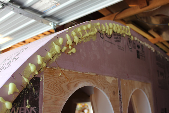

More progress. It was probably completely unnecessary but I used spray foam to fill in any crack that would accommodate the straw on the can. This filled in some of the larger kerfs on the inside and outside. Later I cut off the excess using a razor blade.

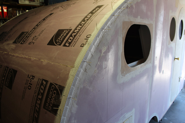

Next, I used vinyl drywall edging to create a sharp corner at the wall/roof seam and in the wheel wells. I took a page from Tac422's build and used toothpicks and Glidden Gripper to hold the edging in place. Here is a picture while the gripper was drying.

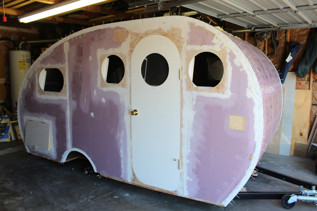

Here is a shot of the side as I made my first pass at smoothing out seams and making sure the doors fit and work well now that the frames were installed in the walls. I also added a plate by the door for a light fixture and another plate to act as a strike plate for the door knob. If you look at the bottom hinge carefully, you can see a hinge mounted door stop. It works well and I will keep it on for a while to see if I actually like it. It was the first time I have used spray foam. Wow is that stuff sticky when wet. They aren't kidding when they say "Always use gloves". It was the first time I had used Glidden Gripper and I must say that I am impressed with it. It is like a glue that is also a primer. I'm interested to see how it works as an actual primer.
Just a bit more prep work to do and it will be ready for canvas. How many people have 'sized' their canvas before application? I was thinking about simply taking it out to the driveway and spraying it down and letting it dry in the sun.

GPW - What software did you use to edit the profile? Here is my hand drawn pen/ink rendering of your drawing. I moved the back swoop a little father back because I find the space between the two swoops very pleasing. I think that is what I like about the art-deco car. My wife thinks I should try the back swoop above the windows. Maybe I'll play with it more after dinner.
Here is the original idea for comparison
I think the top one is much better. :)

Make sure you leave enough room in the door opening to allow for the canvas and paint. On the Big Pink I have the canvas on the door and the canvas wrapping the frame. It got pretty tight. I had to change the style of hinge I used because of this.
Also, I didn't do anything for a door threshold, and am thinking about cutting the bottom of the door, or at least shaving it.
That would allow room to either put a metal sheet (with a lip) or tapered wood as a threshold.

I think I would do a way with that door stop. First time a good gust of wind catches the door I can see some damage occurring. :roll:

ghcoe - you are right. It was a bit of an impulse buy while I was buying other hardware. I don't really like the look and, as you pointed out, the door has way too much leverage on it. It really needs a spring or something to absorb some of the energy of the moving door. That would make it more like a closer than a stop. I'll keep thinking about a solution.

NMMarauder wrote:ghcoe - you are right. It was a bit of an impulse buy while I was buying other hardware. I don't really like the look and, as you pointed out, the door has way too much leverage on it. It really needs a spring or something to absorb some of the energy of the moving door. That would make it more like a closer than a stop. I'll keep thinking about a solution.
I had one of these on the door to the utility room in my basement. http://www.amazon.com/Automatic-Hinge-Door-Closer-Brass-Plated/dp/B000KKX688 It worked pretty well too. I don't know if it would have stopped the door from going full open because there as a shelf in the way that prevented it. It did however reliably close the door with not too much pressure and worked for several years on a door we go through a dozen times a day at least to let the dogs out into the yard.

“ What software did you use to edit the profile? “ ... Paintbrush for Mac ...
