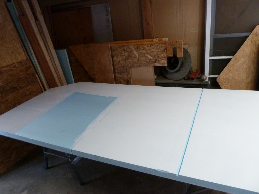

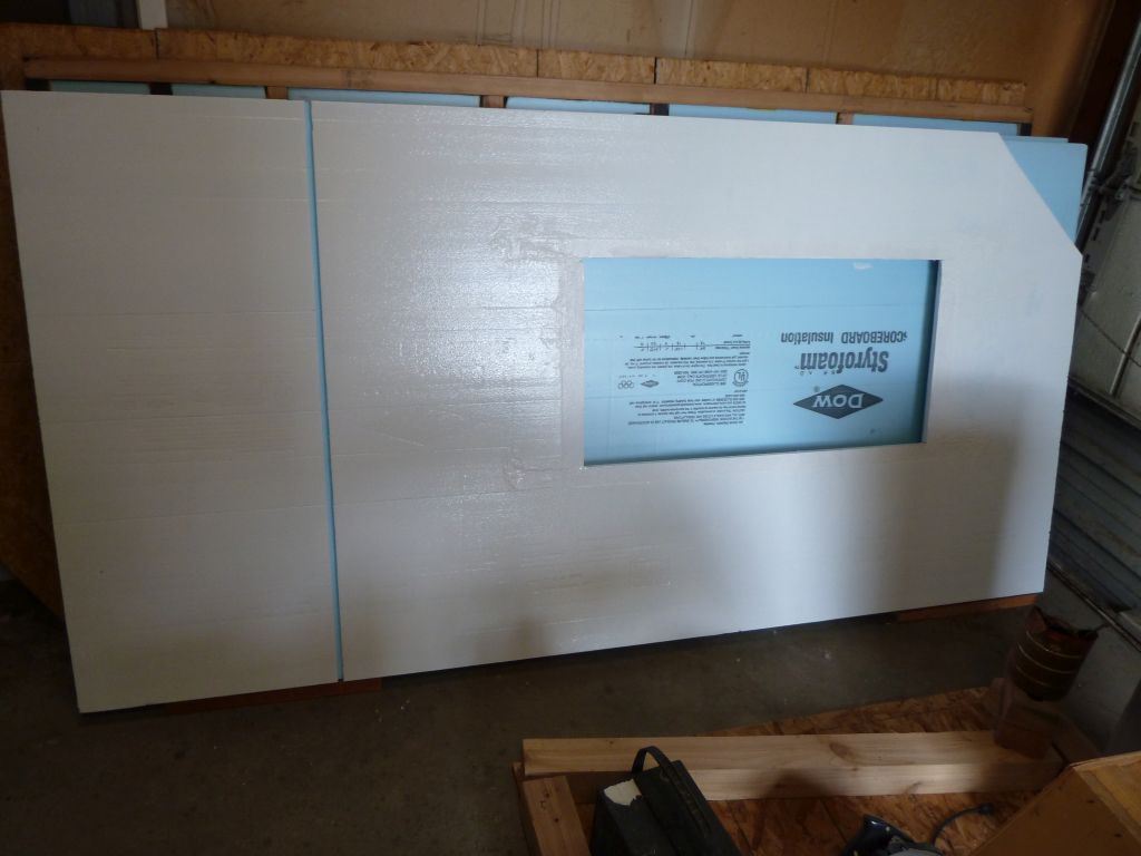

More snail's rate progress:
Have not decided if Foam Door is in the plan or not
Prepped for fairing & sanding (passenger side).jpg (99.04 KiB) Viewed 1518 times
fairing & canvas tomorrow / Monday
Prepped for fairing & sanding (driver's side).jpg (93.14 KiB) Viewed 1518 times

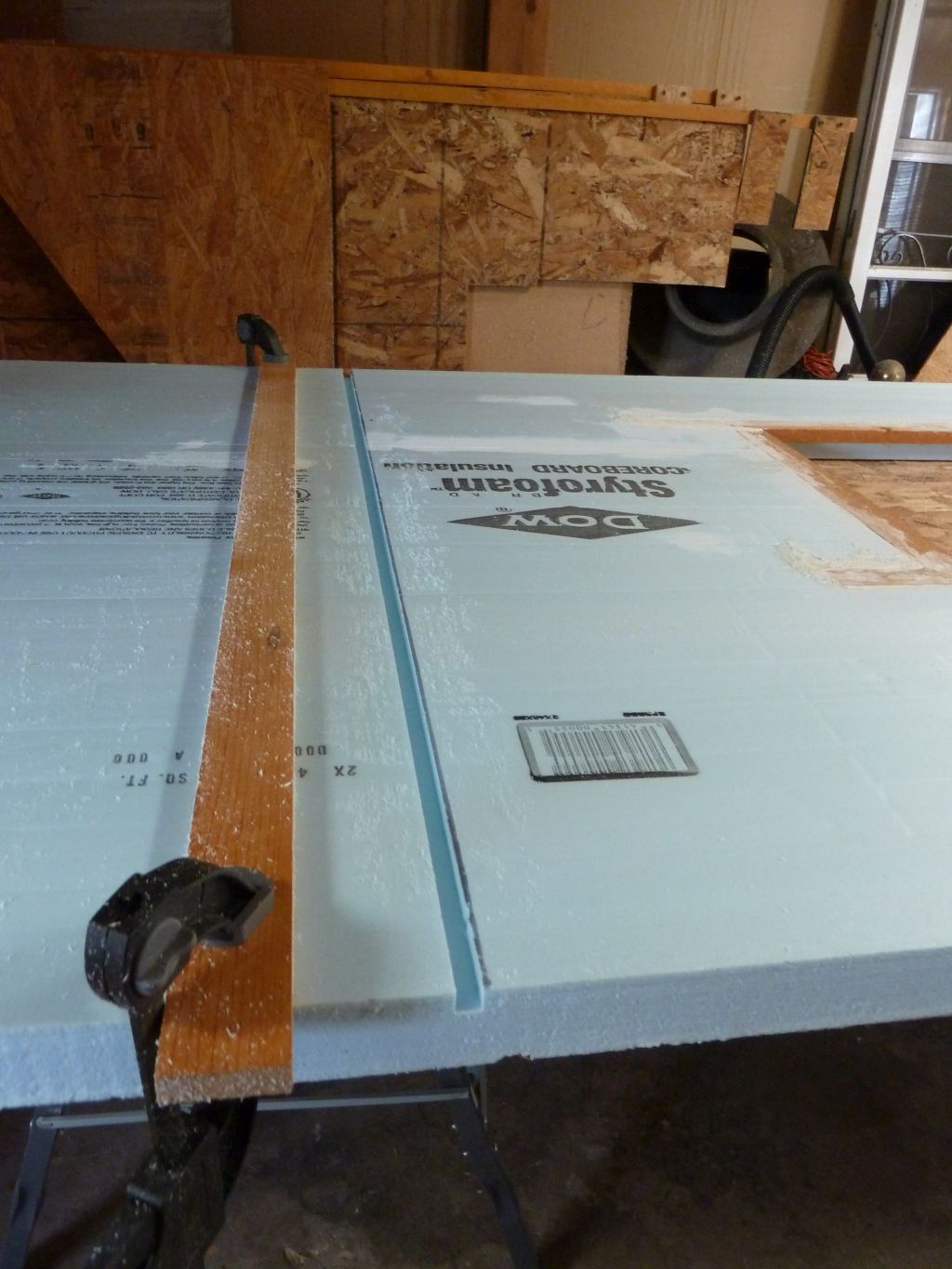

routed 2 of 4 sides of the bulkhead dadoes
Bulkhead slot routed.jpg (178.87 KiB) Viewed 1518 times

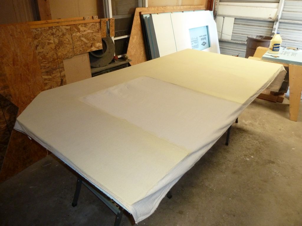

Finished canvassing the inside of the passenger side panel. Hope it sticks well. Off to use "the mix" on the OSB galley bulkhead. This was from a Harbor Freight tarp that went through the wash. I did not like how it puckered & wrinkled along the seams but it went on the foam easily enough.
Applied a thick coat of TB II to foam, unrolled the canvas on top, rubbed it smooth with my hand & plastic wallpaper thingee. Then a light spritz with a water spray bottle, applied a thick coat of TB II on top of the canvas, squeegeed the canvas smooth with the plastic wallpaper thingee, geting a nice bead of thinned glue expressed to roll along the canvas. Went over it all a few minutes later to smooth the surface all out.
First canvas job - still fresh.jpg (116.29 KiB) Viewed 1486 times

Here is an edge closeup with the best tool size for glue-up & smoothing out the canvas. I think quarter round molding would over any ugly corner issue.
Edit: I used about 1/3 - 1/2 gallon of Titebond II on this one panel. I see purchasing a couple to several gallons of Titebond II in my future - kinda spendy.
