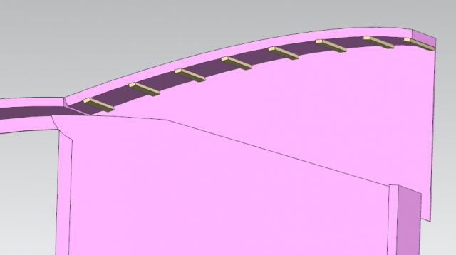

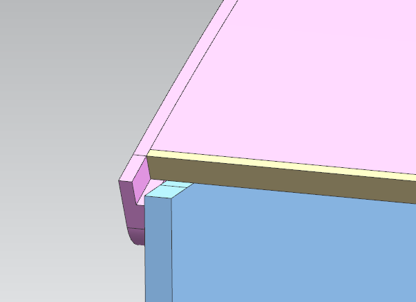

Fred, I think I understand what you said.

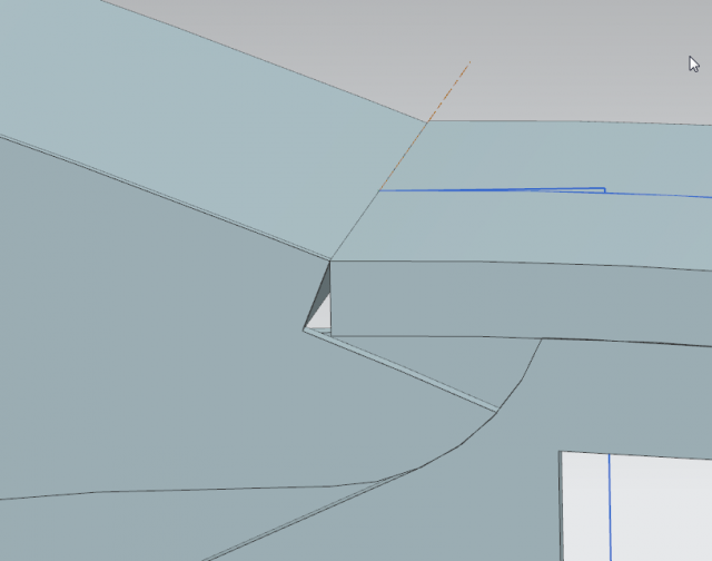

So I notched out the hatch, 1 x 2".
Seems to cover it mostly. There's still a tiny hole.

Postby mikeschn » Wed Jul 01, 2015 10:10 am
Fred,
It works like this:
Re: Foamie hybrid thoughts...
Postby Fred Trout » Wed Jul 01, 2015 1:07 pm

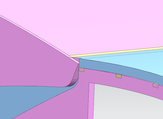

OK, looking at what you currently have, you could draw a radius from the hinge pivot point and make as much of the circle in the vertical wall as needed to ensure the vertical covers any opening including rising above the horizontal roof line. You just need to make more of a segment of a circle centered on the pivot where you have yours radius.
Pic shows area under discussion -
radius centered on 'hatch' pivot point
- cut out of TD wall to fit it
- add to hatch wall to make it a circle segment
Just curious if & how you are sealing the wall where the parts slide past each other.

Postby mikeschn » Wed Jul 01, 2015 5:12 pm
Fred,
Yes of course, something like that should work. Lets give it a try...

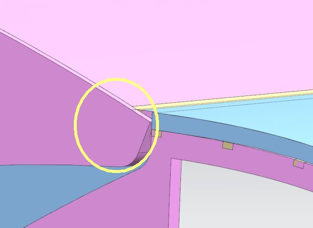

For starters, here's the tiny hole I mentioned earlier...
and here is the ruled joint. Opps, the hole is back. awww crap
Postby mikeschn » Wed Jul 01, 2015 5:28 pm

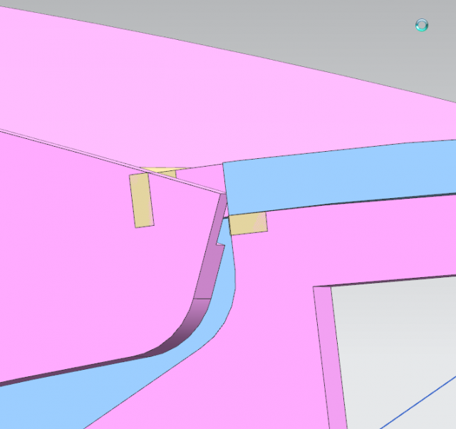

ah, here's the way to do it... What do you think?
Postby mikeschn » Wed Jul 01, 2015 6:44 pm
I thought about running the spars through the side of the hatch. so I modeled it up to see what it would look like...
Then when I closed the hatch I saw the problem. It interferes with the inner side panel
Foam doesn't lend itself well to motion, does it?
Postby Fred Trout » Wed Jul 01, 2015 6:54 pm
You got it !! Just needed to place the center of a circle at the point the pop-up rotates around. Simple to use a compass to scribe your cut with the hinge-pin at the center.
You can either stop the width of the wood short of the wall or add a lot more work to get the edge to match the wood - could embed the wood into the foam or something else like that. Lots of examples here like KCs. Just much more time consuming. You should also take a quick look thru ghcoe's #1 thread to see how he did his galley hatch. Could be something useful there.
Yep, foam is fragile and needs a gentle hand and protections, like the corner bead & flashing, embedded wood, etc. I am doing mine so a 4 banger can drag it behind and because I am no carpenter.

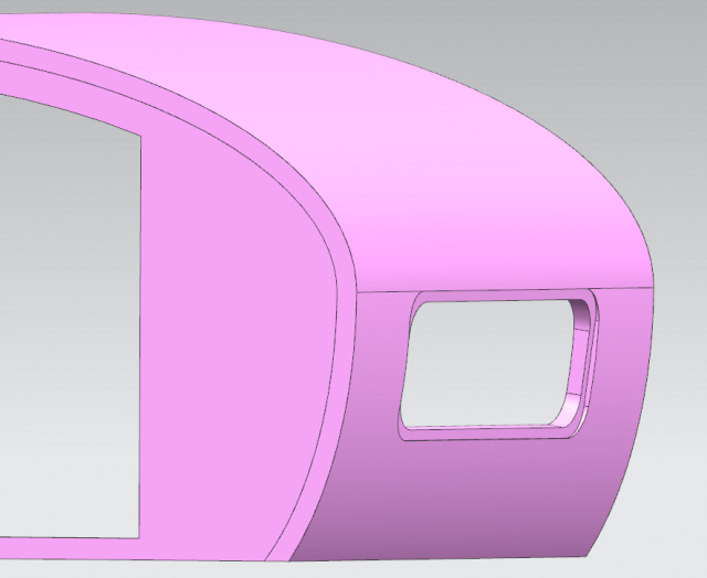

I'm thinking about putting in a front window. I'd cut out the foam like this... But I'm concerned that the foam will crack when I bend it. Should I use wood like NMMaurader & KCStudly?
Postby Fred Trout » Thu Jul 02, 2015 9:11 am
Not understanding why you want the extra pieces in there but foam can be bent without breaking by steaming it or using a compression strap.

Postby KCStudly » Thu Jul 02, 2015 11:38 am
From studying those links, what is not resolved is getting a large sheet to form to a specific profile. Most of his examples are free form, or he coaxes a smaller shape by hand into the approximate shape. I suspect that it looks easier than it is because he just puts a tension strap between the ends of a tight bend. You can't always do that on a camper and shallow bends don't apply much sideways force toward the glue surface. In other words the strap does a fine job approximating a profile curve, but does a lousy job clamping said curve to a mating surface.
Another option (that GPW has recommended) would be to laminate chip board or bed sheet to the outside of the foam before forming, then it would act like the compression strap while forming and prevent the outer surface of the foam from cracking/snapping. I haven't tried that method so I can't say how much harder it would make the foam to bend and stay put while gluing.
From my experience using a simple stretcher (technically not a compression strap because it did not contain the ends of the foam) it is very difficult to get the foam to form and press up to the mating surface(s) for a good glue joint. If any part of the profile is relatively flat, the stretcher or strap is not going to pull sideways over the flatter areas to affect a clamp. When laminating curved panels with kerfs, and especially using contact adhesive, large panels formed easily and stuck fast with just hand pressure.
The big issue I see if you want to try to form over a mold, is that you either have to spend time and materials building the mold, or temporary supports in the cabin to use it as a mold. My logic was that if I was going spend money and effort on building something to do that, why not make it part of the camper to begin with? But then I am not being uber weight conscious in my build.
For doors and windows I'm in the camp that likes a wood frame (preferably cedar). One option would be to form the panel first, then, once it is stable, cut out for the window and glue in a frame. You may have to deal with some fairing issues if the foam and wood profiles don't match up well (or maybe if the foam is flexible enough it can be clamped to comply with the window frame at glue up), and your cuts would have to be pretty accurate for a snug fit.
Do you plan on having it be a curved window or let in flat?

Mike is talking about little strips around a window opening. I agree with you that using wood or metal flashing to mount a window seems more secure but it is not clear to me what Mike's plan is there anyway.

Postby mikeschn » Thu Jul 02, 2015 2:04 pm
In that last picture (above) I have just routed out the pink foam to put in the window. My thought was to curve the foam first, then route out the opening. So far no wood involved. But knowing how easy EPS cracks, I'm tempted to look for a little reinforcement to keep the crack from ever happening.
